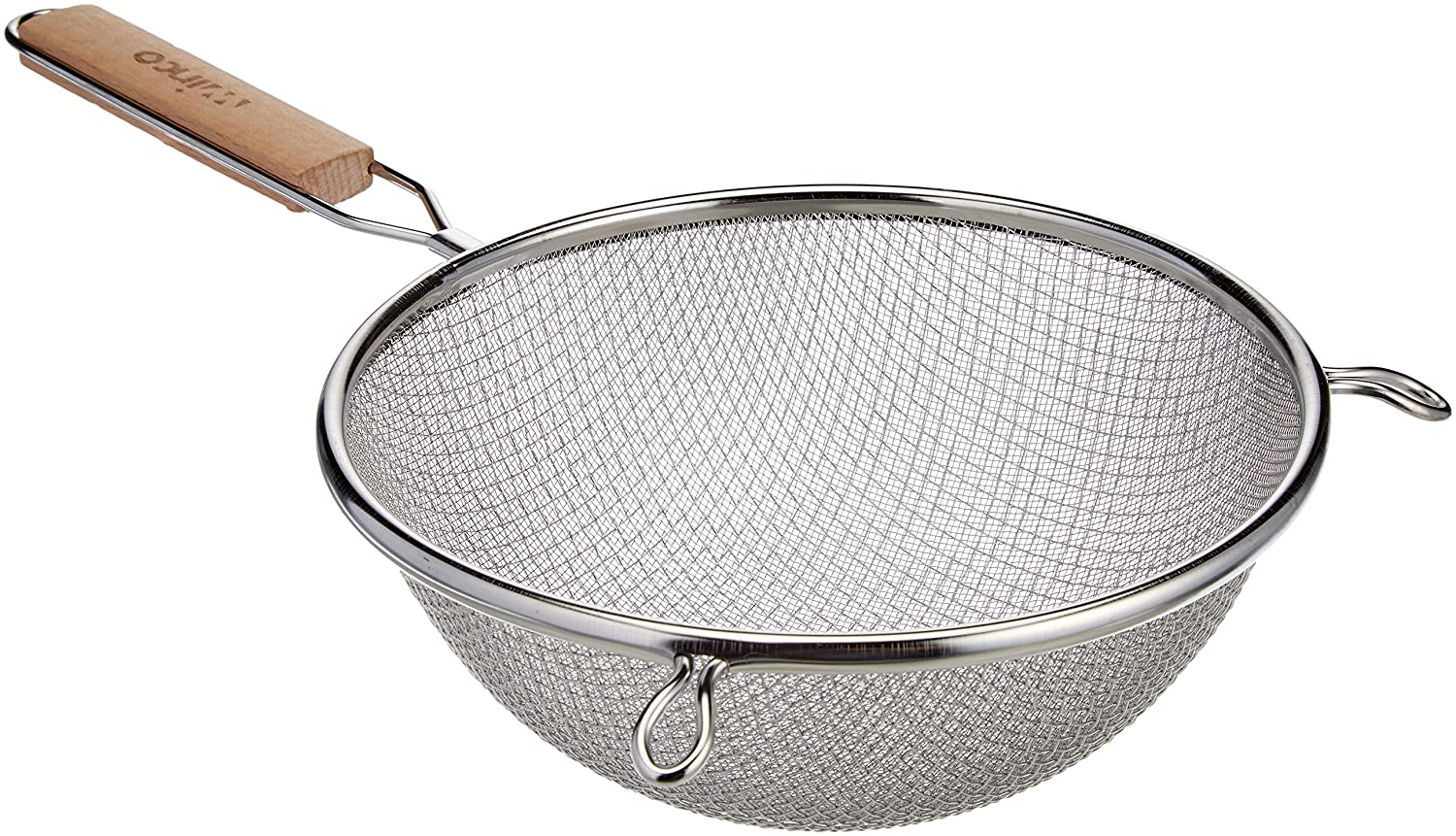

    I have gone to using very hot water and no Southern Shine media or regulars pins for my wet tumbling on every loading. The primer pockets are still a bit dirty but I feel it's more time effective to touch them on a appropriate pocket brush on the prep center than separating media with a FA separator. They are still plenty shiny...
    I guess I’m just doing it the easy way, Hornady Sonic Cleaner, it will fit 150 6.5 CM. Run the temp up to 170 (it never reaches that) normally gets up to 150’s and run it twice at 20 minutes each. Rinse with distilled water, then cookie sheet in the oven at 225 for 20 minutes. That gives me time to start a second batch. They are clean enough inspect them and then get dirty at the next match.
    New to this as well, and I have only done two tumblings. But what I do that I think seems to work well.
    1. Put a screen strainer over a small bucket, preferably with a screw on lid that holds a gallon of liquid.
    2. Dump liquid and any pins that come out through the strainer. Screw lid on bucket to reuse later (I use Boretech case cleaner, it is reusable. I found if you let it sit, the contaminants settle to the bottom.)
    3. Grab 5 gallon bucket with your strainer with it's pins, and put the strainer end cap on the other side of tumbler and take it to the bath tub.
    4. Fill your bucket with hot water and shake and spin the hell out of it. Dump the water and pins from the bucket through the strainer.
    4a. I do this three times, it's doesn't get all the pins out, but enough for me to say it is good.
    5. Rinse pins and leave in strainer over bucket, they will dry just fine.
    6. I dry my cases over a towel, no case dryer or media separator yet, and it's last on my list of things to buy. Once dry I run a magnet to pick up whatever is left in pins. It will also pick up any cases with pins, just slide the brass off and pins will stick to magnet.
    I probably spend maybe 30 mins after brass is done tumbling, if even that. I knew it was going to be a process, but I don't mind.

    I pour my cases into a media separator (looks like a gold pan with slots in the bottom) and give it a few shakes. Then I pour whatever’s left onto a beach towel. I grab the towels corners and seesaw the brass back and forth. Grab the pins with this magnet
    and return them to my drum. Come back in a few hours and do the whole towel shake thing again and magnet up the rest of the pins. Nothing down the drain, and any pin that falls on the rug is easily found with the magnet.
