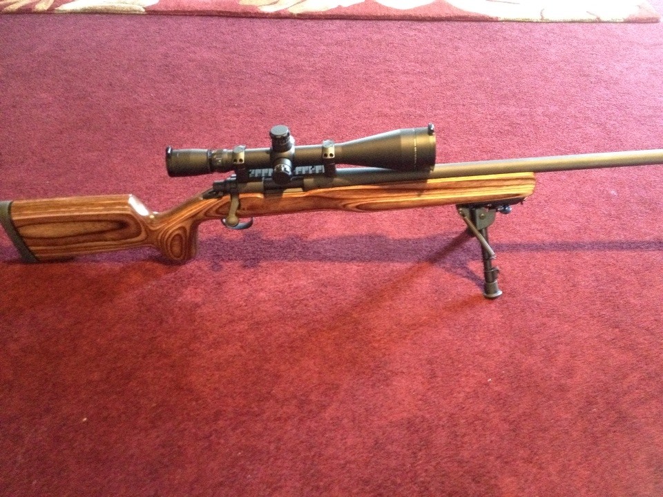

Regarding heavy bullets in a .223, I have a Rem 700 SPS Tac in .223, with a Vortex 5-15x44 scope with TPS Rings and base, mounted on a B&C Medalist stock and a Harris bipod (a bit over $1K all in). I don't have access to a 600 yd. range, but at 200 yds I've shot 15/16" three shot groups with Hornady 75 gr BTHP. The 1:9 twist barrel seems to do just find with Hornady's 68 and 75 grain rounds. Also, if money for ammo is an issue, Black Hills makes duplicates of these two round in their red box (new) and blue box (reloaded) lines that are less expensive than Hornady.
