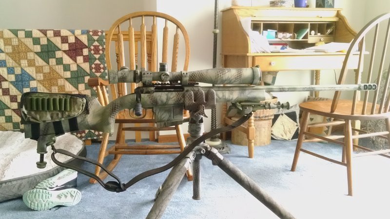

I use the Reaper Grip with the heavy Slik tripod for my .338 LM. Very smooth pan and tilt, easy off hand lock. Very steady platform.
