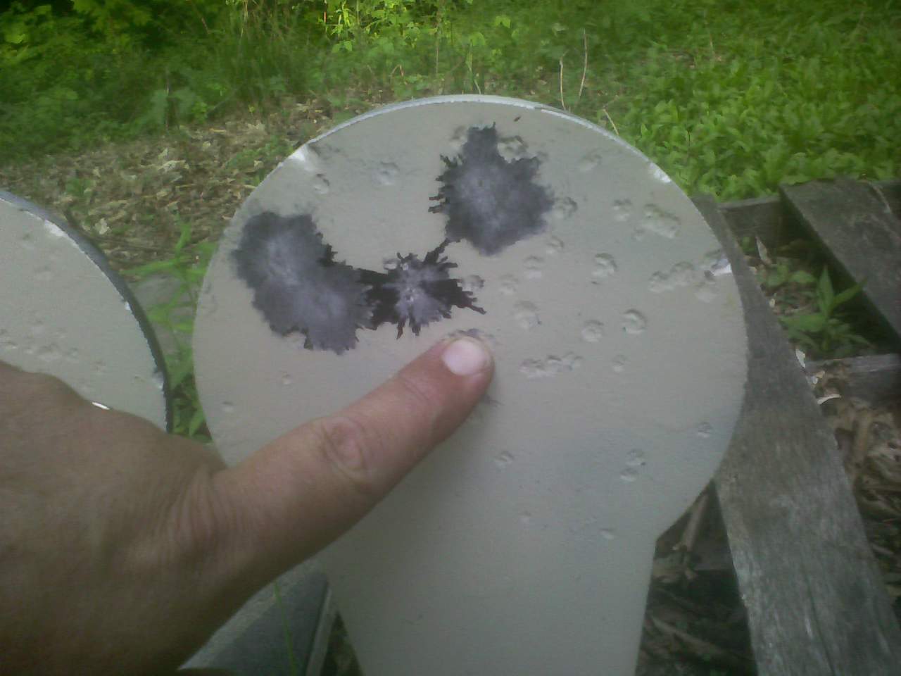

My notebook: http://SnellsNotebook.us
Couple things jump out at me after a quick scan of your post and "notebook"
1. Your barrel nut torque is pretty high. I snug/loosen the nut twice and torque to 40 ft-lb on the 3rd.
2. You mention max pressure loads which could be an issue. Might get better precision if you back down a little bit. I find that my 77gr loads lose precision at the top of the load chart.
3. Maybe a headspace issue. Did your barrel come with a matched bolt? Many barrel makers offer this as an option.
4. Make sure your gas block set screws aren't over tightened. I use 25 in-lb and red loctite. Never had an issue.
5. Make sure your gas block isn't touching the inside of the freefloat and that the rail retaining screws are torqued to manufacturers spec.
