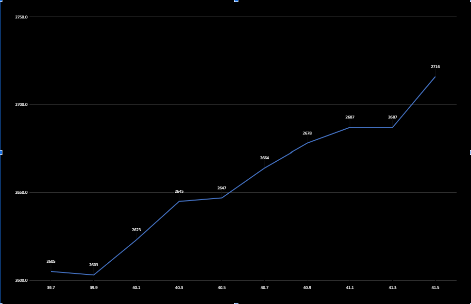

I did a 10 shot ladder load with a COAL of 2.800.
Velocities from my Garmin Crono were below with grain weights
1-39.7-2605
2-39.9-2603
3-40.1-2623
4-40.3-2645
5-50.5-2647
6-40.7-2664
7-40.9-2678
8-41.1-2687
9-41.3-2687
10-41.5-2716
So I picked the higher node as the velocities were identical on the 41.1 & 41.3 charges.

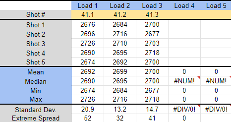

I loaded 5 of each for 41.1, 41.2 & 41.3 and ran them through the crono again.
This was the data i got.

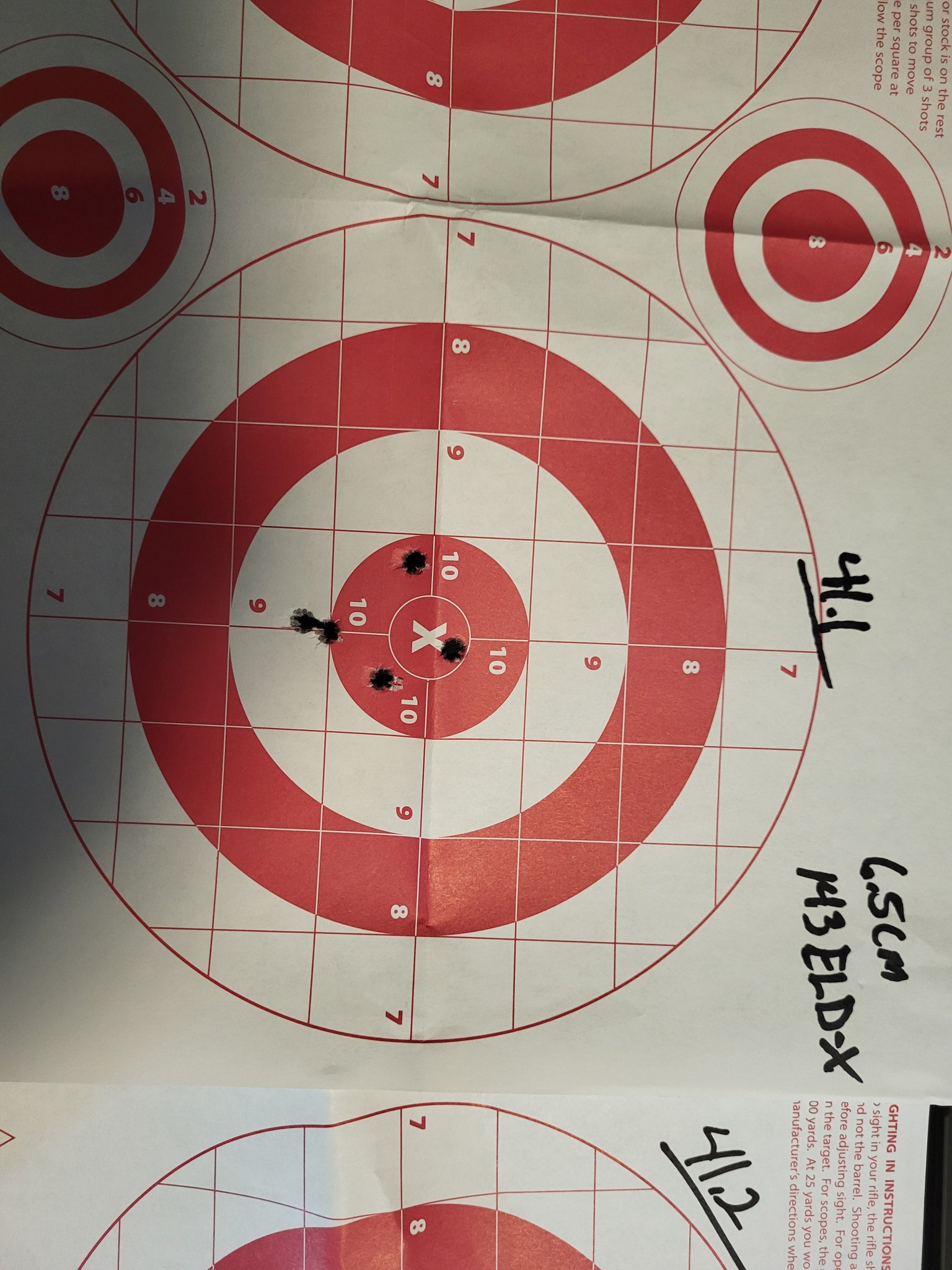

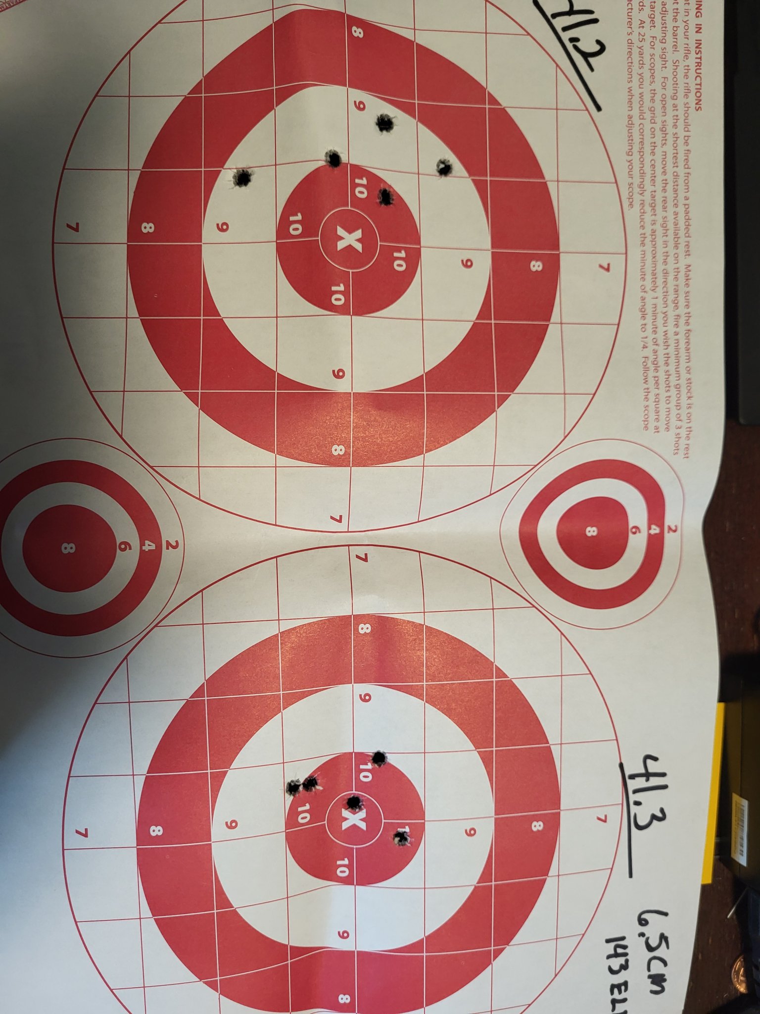

the 41.1 load had about a 1.75" group for 5
the 41.2 load had a large vertical string of about 4"
and the 41.3 load group had about a 1.5"

None of the 3 really grouped well at all.
The 41.1 Group was about 1.75"
The 41.2 group was about 4" and in a large vertical string
the 41.3 group was about 1.5" group

No doubt in my mind, you should be getting much better than 3/4" groups with that powder behind those 143 ELD-X's.
That 10 shot ladder really doesn't tell you anything about where a good load is. You can shoot that same ladder more than once and each time you'll get a different looking ladder. It's what you get on target that really tells you what you need to know about the performance of your loads.
Looking at the Load 1 - 3, you're ES's look pretty high to me for just 5 shots each. It makes me suspect there's a lot of room for improvement in you loading and/or brass prep. You should be able to easily get you velocity ES's to around 20 or less.

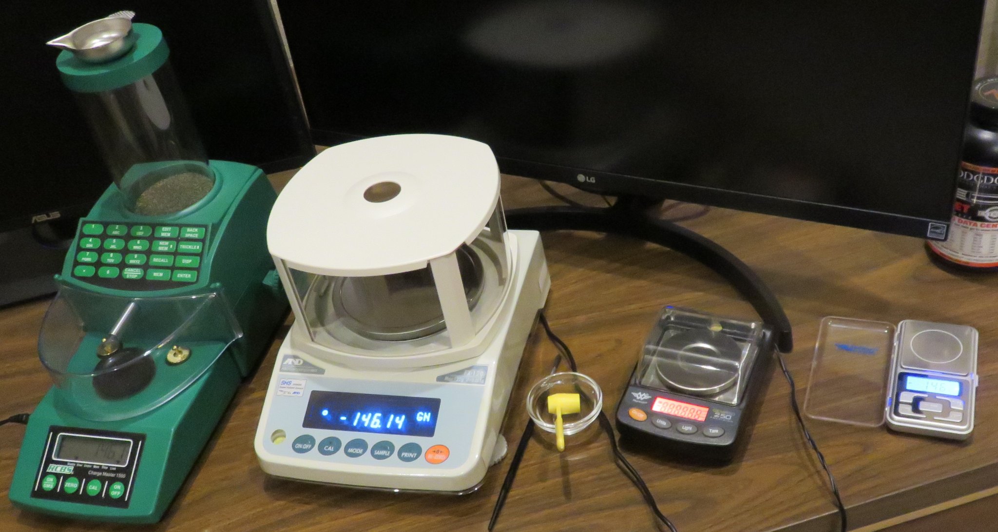

It's a good idea, you won't be sorry going to the Alpha brass.
I also have an M500 balance beam that I started out with, which I no longer use. I strongly feel that's at the heart of your issue. I tried all kinds ways to get my M500 to produce consistent and accurate results. But my chronograph kept showing me I was at a limit. . . not being able to improve my ES's and SD's where I wanted to be. For me, the goal was single digit SD's and I know with such SD's I should be getting good ES's too.
When I went to a digital scale the could measure to +/- .02 of a grain, that's when things really improved. What's now an old Gem-Pro 250 is one that worked well in that way, but it was a little hassle keeping it from drifting, which slowed down my loading process. You know that buy one cry once thing ;) . . . I eventually went to the FX-120i, which took away that issue for me.
If price is a concern, Creedmoor Sports has a nice digital scale that should do the job for you (the FX-120i is much better for a couple hundred more). The one I'm thinking is their TRX-925.
Other than that M500, these are the scales I've used:

If you’re going from 41.1 to 41.2 and getting that big of a jump in groups it’s not your powder charge. Something else is wrong.
That’s 1.75” to 4” then back down to 1.5” for 41.3. Some peoples scales aren’t even that tight and shoot good groups.
x2
@champ198 the 41.3gr charge in your ladder test is a great example. If you graphed the mean from your subsequent 41.3gr 5-shot group on your ladder instead, it would have been a nearly linear increase from the previous 2 charge weights on the ladder.
You see people claim that a flat spot across a couple or few charge weights in a ladder shows consistency across that range of charge weights, but never you never see the same people acknowledging that the flat spots might actually be caused by charge weights that are more inconsistent & have higher SD/ES. Why not? Per their claims, some charge weights are less stable. Why not those?
I don't subscribe to OCW, but I still always shoot & chrono ladders to get a baseline and check for pressure when I'm using a new powder or considerably different bullet weight. I'm not advocating for statistical significance - life's too short.
