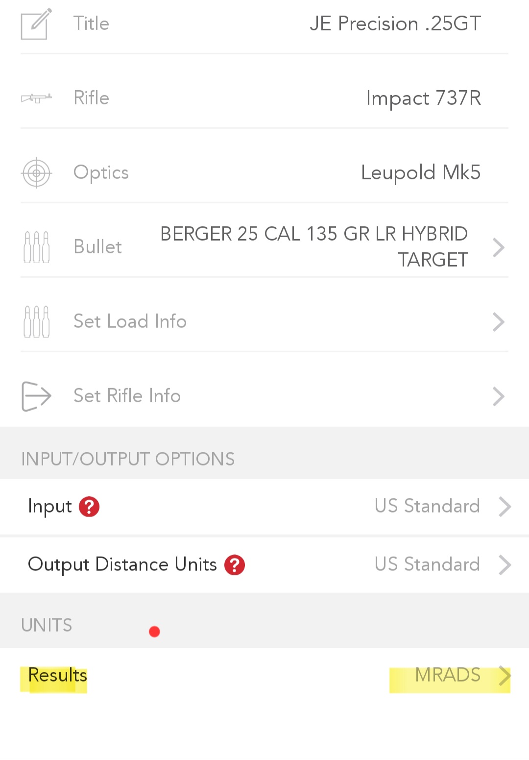

Go into the "edit" tab for your rifle and then select the hilighted part in the screen shot I've attached

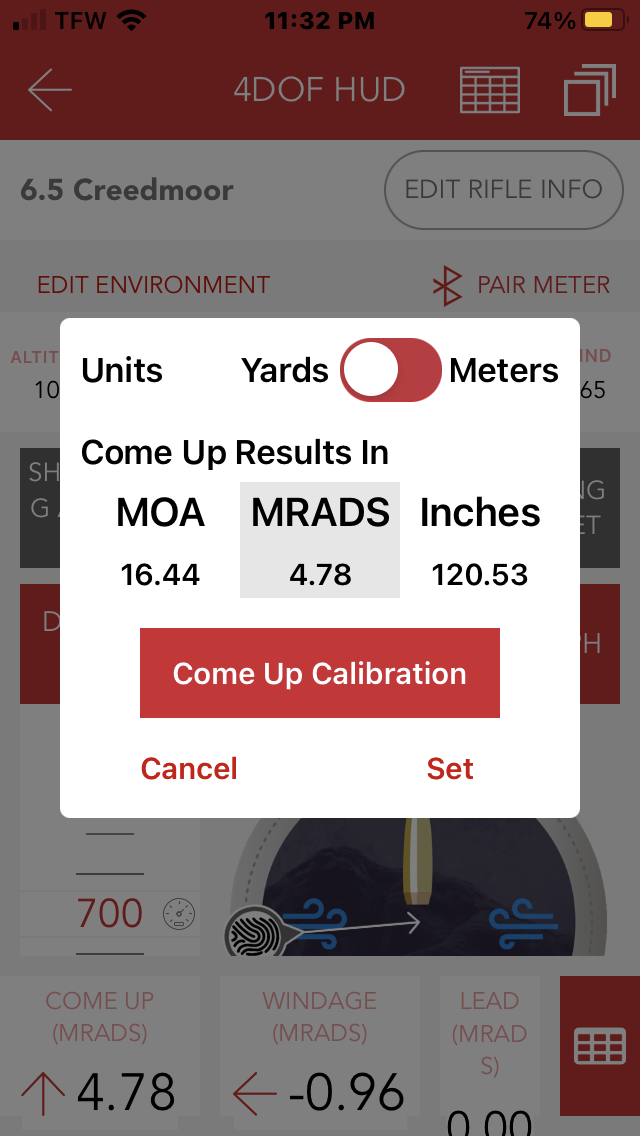

You can just click on the bottom corner where it gives you your come up in moa and this will come up below. Just hit MRAD and then set and you will get data in mils.
