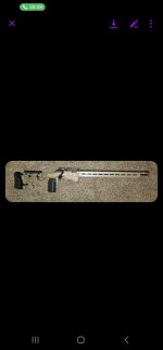

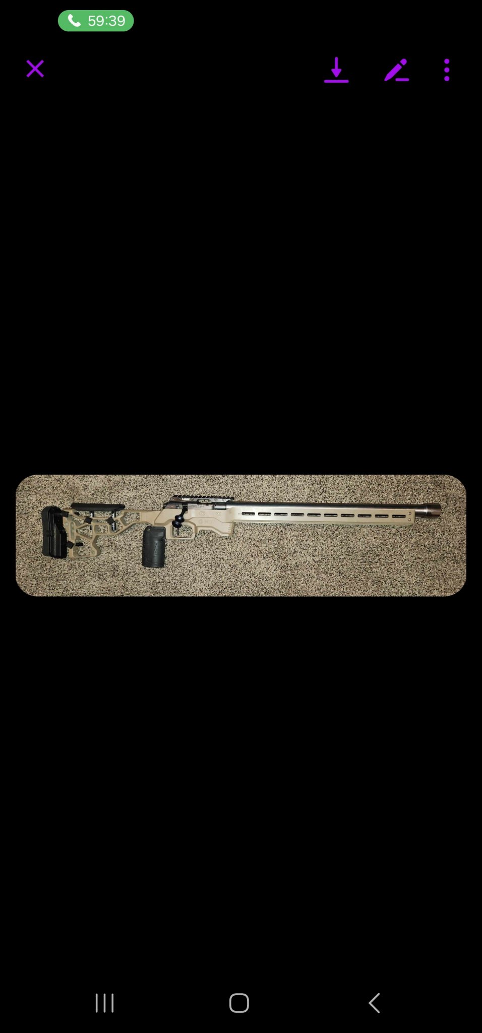

Hi guys I'm new to the rimfire game and am wanting to get started with a nicer .22. With that being said I'm not really familiar with custom builds and their used prices so of you can give me your options on what you think this would be worth. Was said to have about 1500 rd through it.
Cz 457 action with a costume 1.20 straight 21.5in long bartline r5 1-12twist barrel
Ec v2 tunner
Area 419 30moa scope base
Timney curved trigger
Mdt acc chassis with internal weights and the elite grip

He's asking 2k for that setup.
Looks to be a decent deal fornthe rifle
That's a pretty solid setup right there. At 1500 rounds it's really just starting to get broken in.
Original approximate value with good deals on this would be as follows (my experience and opinion):
  • CZ 457 action - $400
  • Custom 1.20 straight 21.5in long Bartlein R5 1-12twist barrel - $600-$800
  • Ec v2 tunner - $155-$170
  • Area 419 30moa scope base - $100
  • Timney curved trigger - $180
  • Mdt acc chassis - $1300
  • Internal weights - $170
  • Elite grip - $100
So he probably spent a little over $3k on that whole setup. That being said, $2k for everything is a pretty decent deal. You could potentially build a RimX with a cheaper stock/chassis for $2k, but it would be tough.

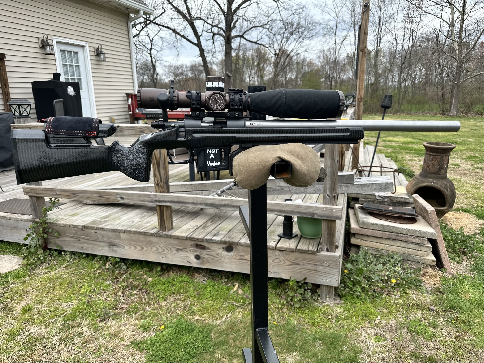

Having owned both Vudoo and RImX, I will probably sell my RimX barreled action when convenient and repurpose the trigger, chassis, and optic to another build to play with. I competed with both rifles last year... each has its pros and cons... [shrug] I just like the Vudoo a wee bit better, and I've had a long and very positive relationship with Vudoo as a company. Conversely, I have two buddies who owned both and ended up keeping their RimXs and selling their Vudoos. PERSONAL PREFERENCE.

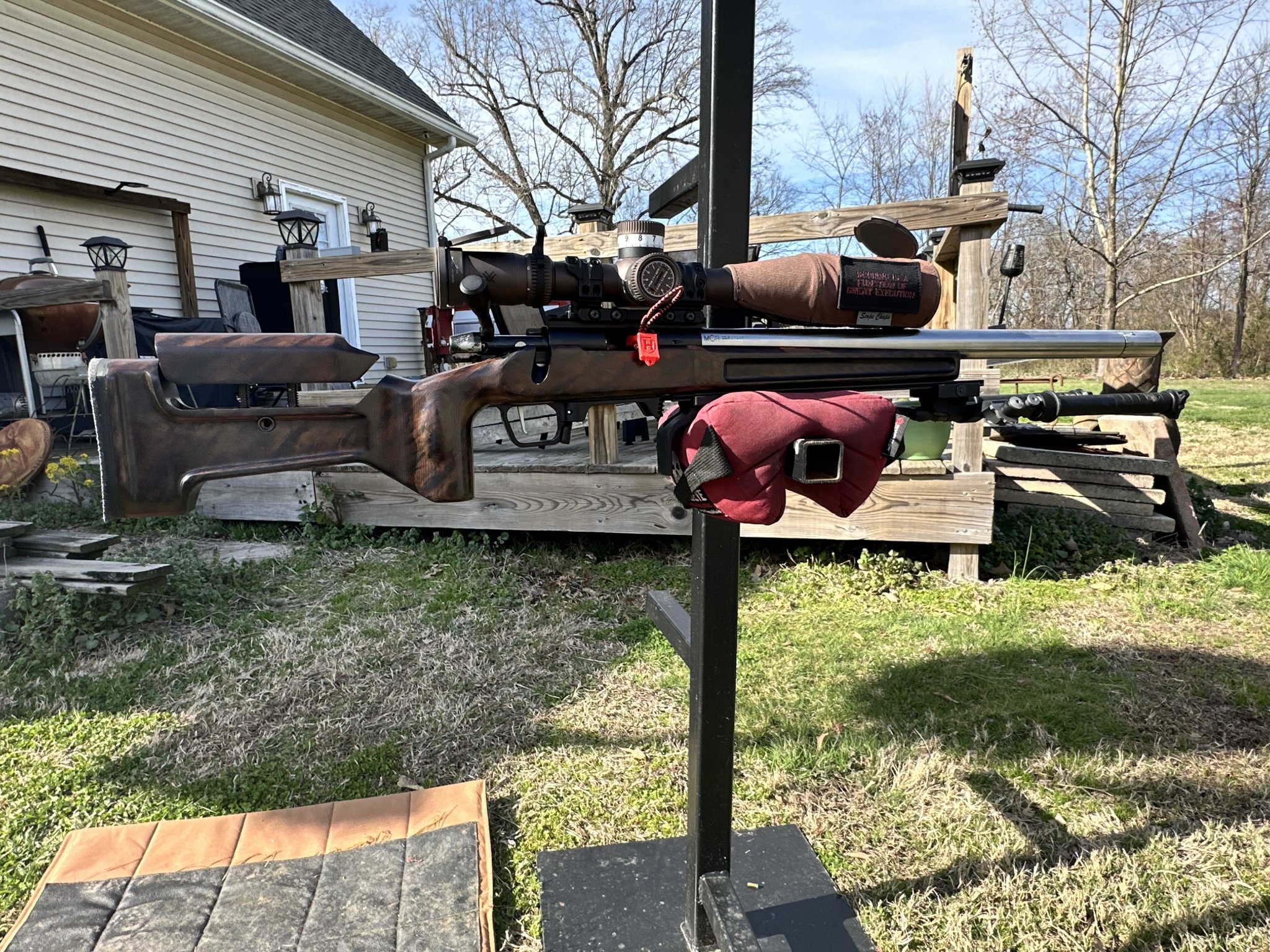

After building a Bergara NRL22/NRL X setup, I kept my CZ 457 with the original wooden stock and KRG Bravo stock as a loaner/plinker/field gun.

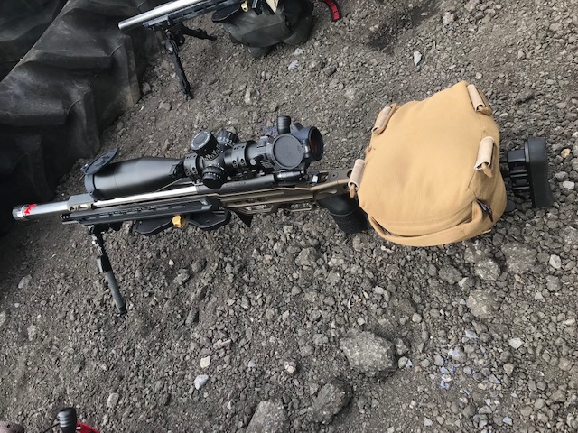

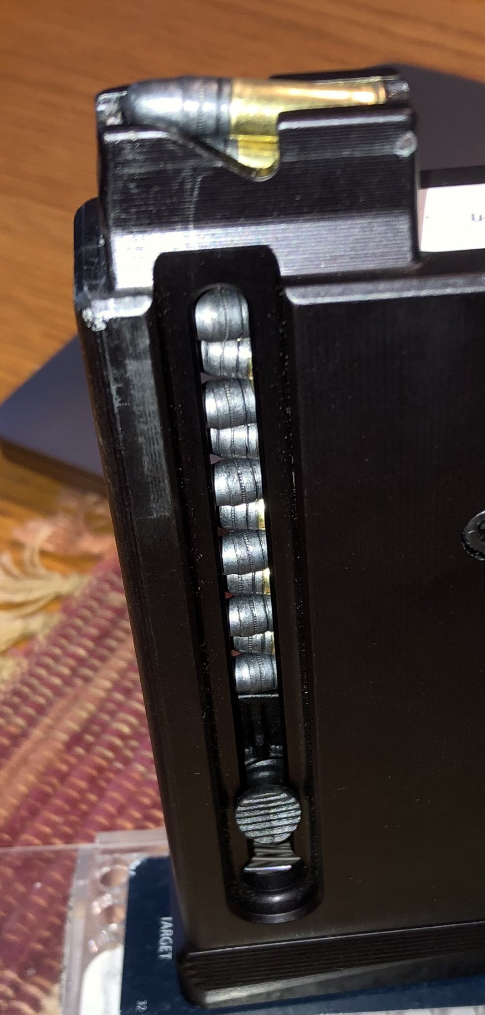

I'm still convinced most of the Vudoo mag issues are user error induced. Yes, it would be nice if you didn't have to be as careful loading them, but I went through 500 rounds my last range day and only had 1 malfunction. It was rimlock and definitely mine or my brothers fault because one of the rounds wasn't loaded properly.
Reactions: Rob01
Not just loading though as using SK or Lapua you don't have to be careful but with Eley it can cause an issue if not loaded properly. Some people buy a barreled action and don't know how to set the DBM up to load properly. This is why you have some companies now working with adjustable mag catches.
Or adjustment induced.
When I got my gen-1 V22 in an MPA BA Comp chassis (complete rifle purchased directly from Vudoo), there was maybe 1/8 - 3/16 of an inch of vertical play in the fully-inserted magazine. I would experience frequent failures to feed the last round. The solution was that MPA provided a prototype adjustable mag latch. After installation and adjustment, vertical play was eliminated and the problem disappeared. My understanding is that adjustable latch is now standard but I don't know that from direct experience. It's imperative that magazines are held firmly in the correct position for reliable feeding.
Wrt user error: yes, failure to follow Vudoo's magazine loading instructions can cause failures to feed, especially with magazine extensions. With that acknowledged - it's been over two years and several thousand rounds since I had a feed failure - and I regularly run Vudoo's now-discontinued original aluminum 15-round mags in matches. I am very careful to visually verify the loaded rounds are in a staggered column, especially in the 15-rounders (photo).
