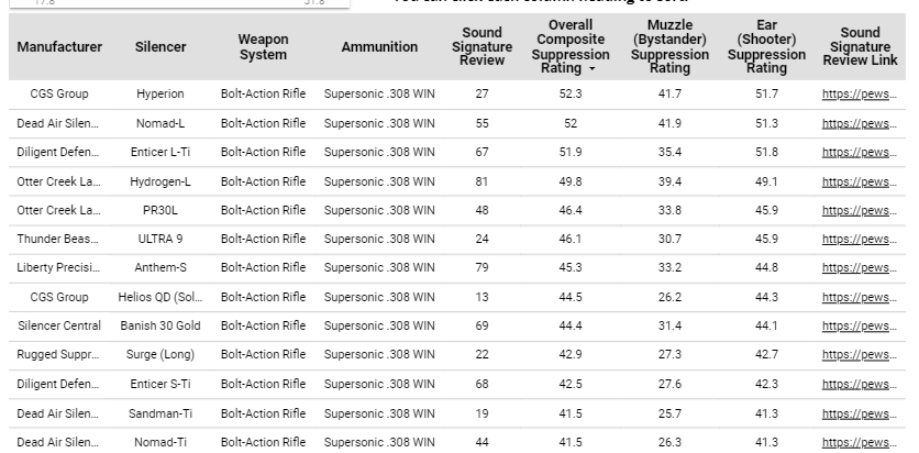

I don't know; looking at decibels from an independent tester (pewscience below), the Anthem S is 2.5" shorter than a TBAC Ultra 9 and has the same suppression at a significantly lower cost. The TBAC Ultra 9 review is from 2020 so might be their Gen 1 model, but I don't necessarily see the benefit for going TBAC.
Why would you suggest going with them?
The TBAC you’re referencing (which no one would recommend for AR use) is like 4.5oz lighter than the Liberty. Hell, it’s 8oz lighter than the aforementioned Nomad L and 2.5oz lighter than an LTI. I don’t understand how people can compare suppressors without including weight.

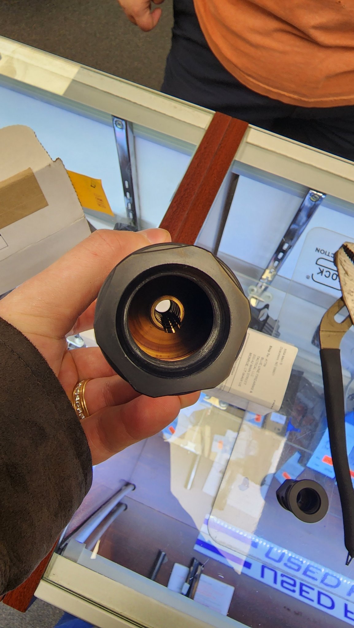

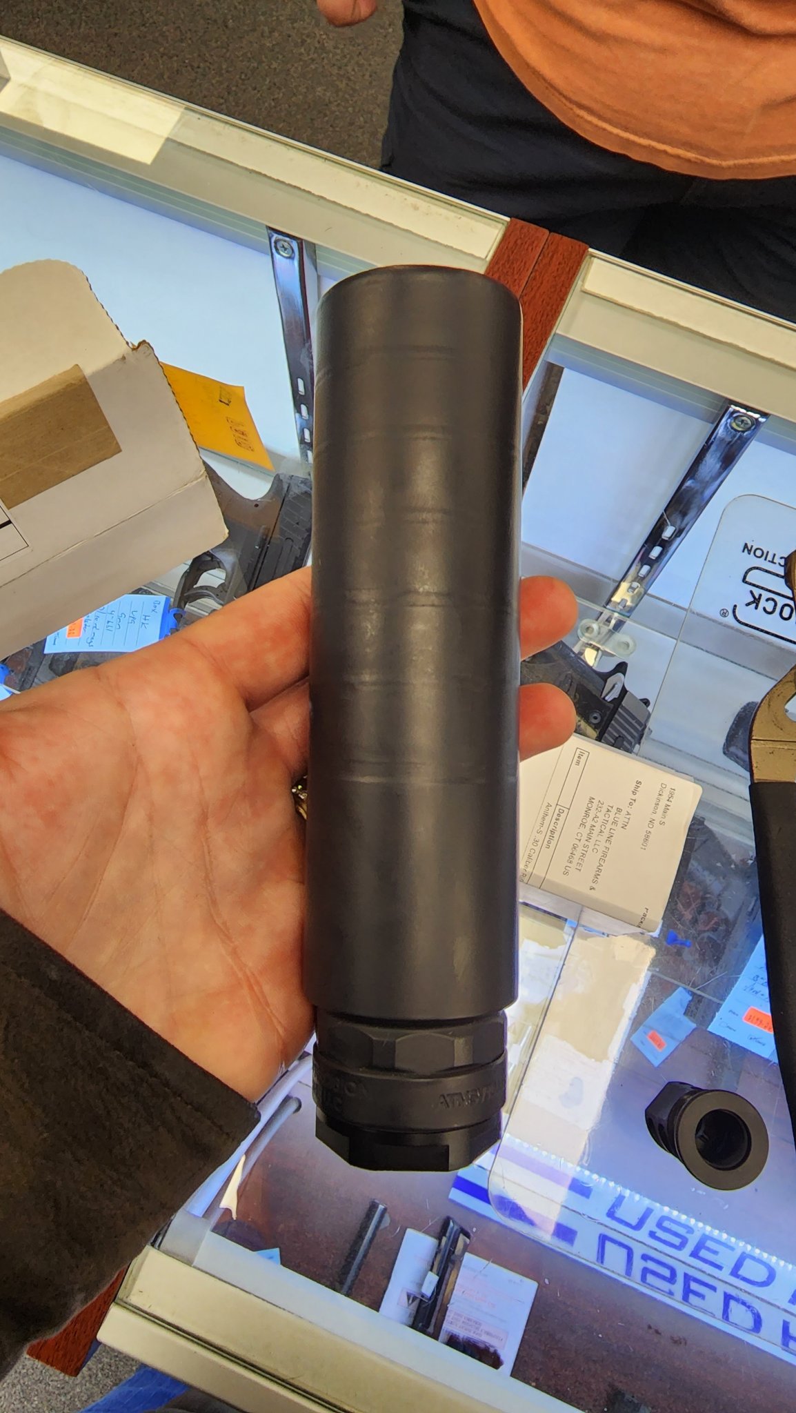

Definitely excited for mine, I'll follow up with you guys when I do. Here's a peak inside, pretty interesting. I know there is some coaxial element I can't see from the outside, presumably skirt ports like the Q and Sig cans. They also have a variable geometry on the baffle clips down the can not too different from how ports on a brake are different down the line, pretty cool.
Love the idea of the energetic armament ID Ring and wrench flats on the body. All cans should do this. Excuse the finish, it was a cold day and the moisture from my hands is on the can, it's not its finish.

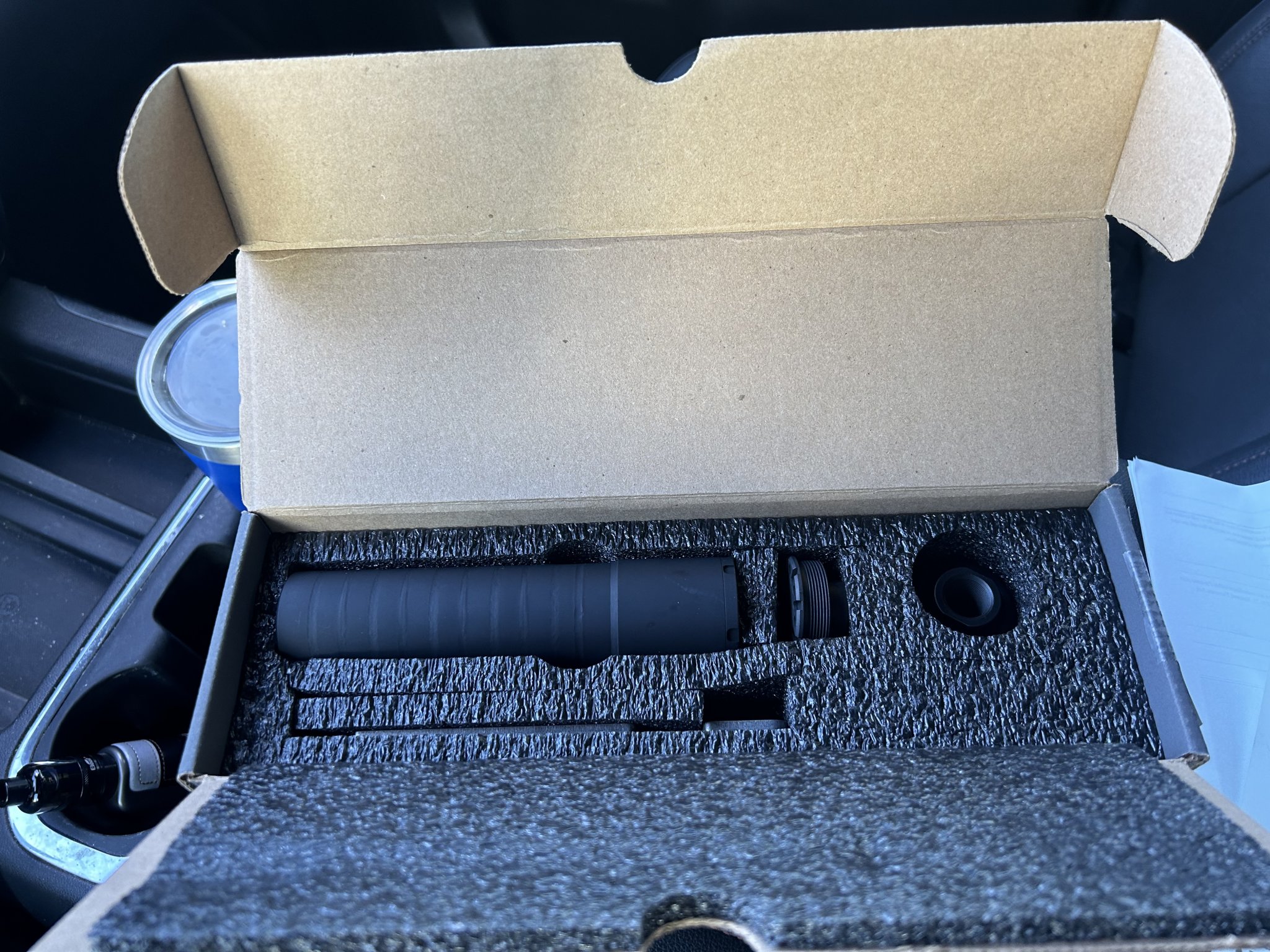

My first can just got out of paperwork jail on Monday, I picked it up on Wednesday, and shot it for the first time on Friday. I ordered a SilencerCo Harvester Evo .30 Cal so I can run it on my 5.56’s, my .300BLK’s, and my 6.5CM (until I can afford to get dedicated cans for all my rifles). I will admit, at first I regretted not just getting a 5.56 can or whatever off the bat, but now I’m not. So happy I picked the .30 Cal one.
The can came with direct thread adapters in the box (if you’re running 1/2” or 5/8” threaded barrel), or I just put SilencerCo’s muzzle device on all my rifles and threw a Bravo Device in the can. The only problem I had was the cover I ordered was a tad bit too smoky after a couple mags. The suppressor wasn’t smoking, the inner liner of the cover was. But I’m having a Nomex one made, so that should stop that.
