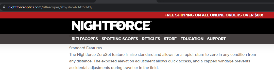

    Took couple of pics. From other pics it looks there may be have been a change in design.
    It’s called “zero set” the turret will bottom out once you have it set. If you run out of elevation loosen the screw pull up on the turret a little and retighten the screw. You now have more adjustment.
    Once you have your zero, loosen the set screw align it to “0” and push the turret all the way down until it won’t move and tighten the screw.
