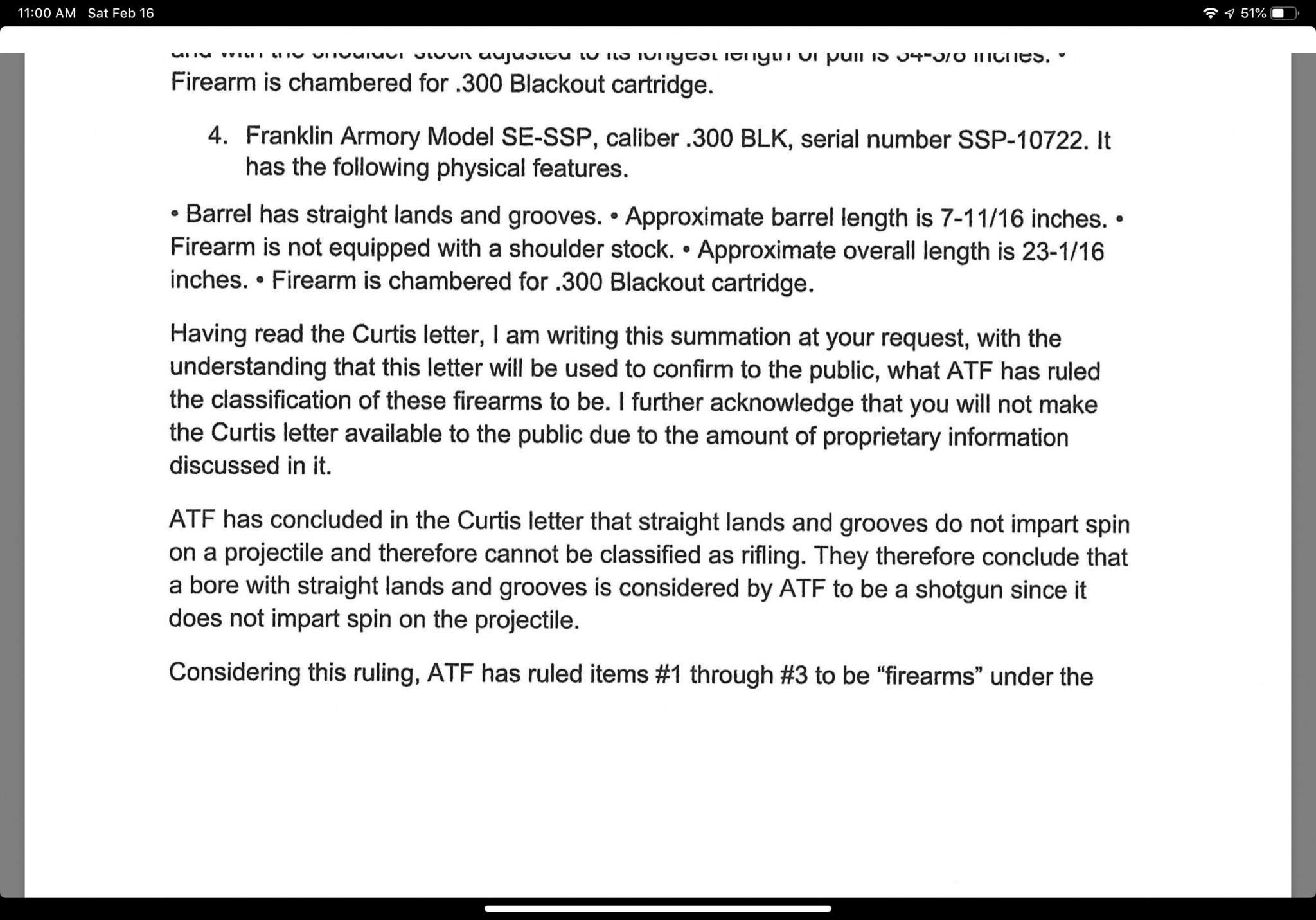

In these letters, the ATF says that a pistol > 26" OAL can have a vertical foregrip without being AOW and instead classify it as 'firearm.'
Specifically, the requester asked about building a weapon similar to the Franklin Armory XO-26:
https://franklinarmory.com/bfsiii-equipped-franklin-armory-xo-26-s/
So what if a pistol has a variable OAL (folding, adjustable brace) that can be measured in lots of different ways, some ways greater than 26" and some not while still being an operable firearm?
This letter says the OAL can be measured by 'extend or fold out the shoulder stock to its extreme length, if applicable.'
Now we get more into grey: If this is a pistol, it doesn't have a shoulder stock, that being a rifle term, so not applicable? Should OAL then be measured in a minimalist way with things and folded/collapsed, the way barrels are measured in similar minimalist ways?
That's where we're at in this thread, with the ATF being inconsistent with the way they measure OAL in practice and agents roaming around doing it this way and that way. Hence the 'grey' area between 'firearm' and 'AOW' without a determination letter.

ATF Form 4473 Section B
Question 16. Type of Firearm(s): "Other" refers to frames, receivers and other firearms that are neither handguns nor long guns (rifles or shotguns), such as firearms having a pistol grip that expel a shotgun shell, or National Firearms Act (NFA) firearms, including silencers.
If a frame or receiver can only be made into a long gun (rifle or shotgun), it is still a frame or receiver not a handgun or long gun. However, frames and receivers are still "firearms" by definition, and subject to the same GCA limitations as any other firearms. See Section 921(a)(3)(B). Section 922(b)(1) makes it unlawful for a licensee to sell any firearm other than a shotgun or rifle to any person under the age of 21. Since a frame or receiver for a firearm, to include one that can only be made into a long gun, is a "firearm other than a shotgun or rifle," it cannot be transferred to anyone under the age of 21, nor can these firearms be transferred to anyone who is not a resident of the State where the transfer is to take place. Also, note that multiple sales forms are not required for frames or receivers of any firearms, or pistol grip shotguns, since they are not "pistols or revolvers" under Section 923(g)(3)(A).
