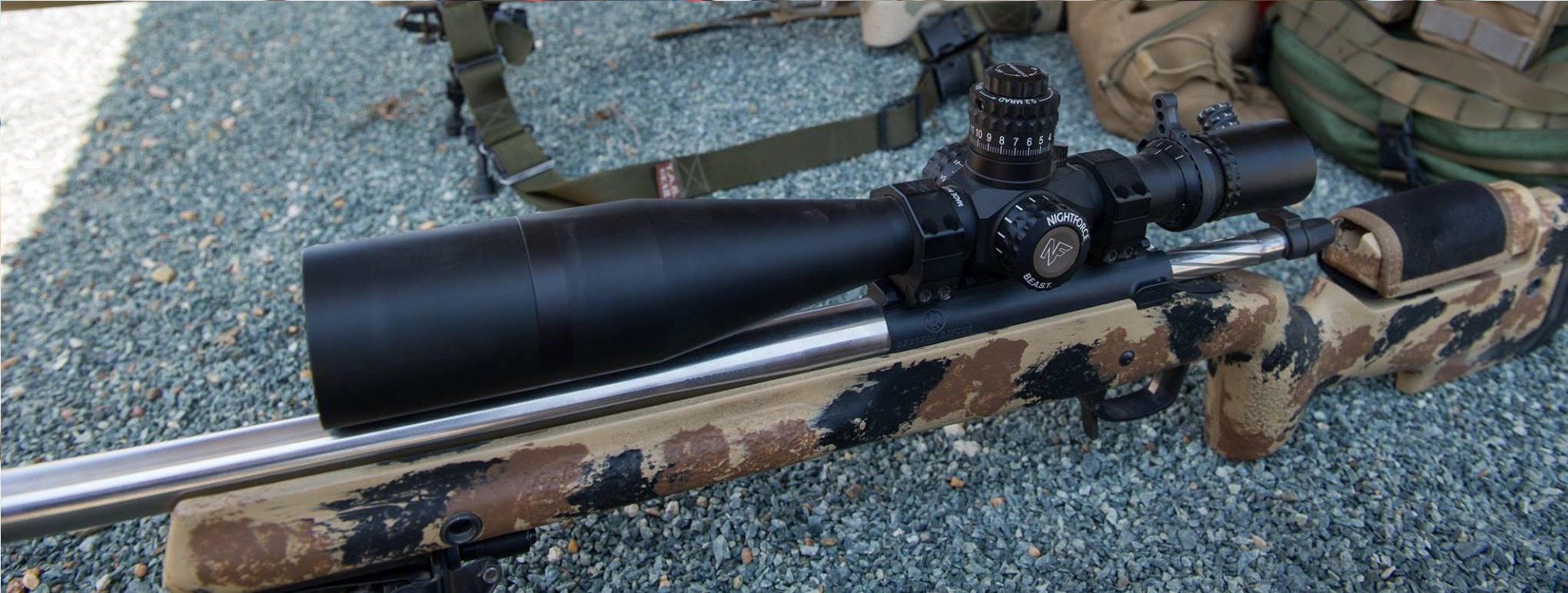

I've had mine for a few months and have used it on my main comp rifle for 2 large matches and several local ones. First of all it's a scope not some magic unicorn shit, for those thinking it's going to solve all their shooting issues or be able to see into the future you're thinking way too much. I'm not here to convince anyone to buy it but what this scope does/has for me is: reliable tracking, excellent glass, quick adjustments. I like tall turret designs as I can see where I'm at while behind the gun, I had to get use to the reticle but now it's fairly intuative for me, and the brake on the turret is really a non issue for me as you don't need it (as long as you know what you are doing) if you're transitioning from one target to the next. I do find it amusing as a pevious scope compared earlier in this thread is one I had to get rid of because it would track worth a shit. I like the Beast and if I had the cash would spend it on another.
I've had mine for a few months and have used it on my main comp rifle for 2 large matches and several local ones. First of all it's a scope not some magic unicorn shit, for those thinking it's going to solve all their shooting issues or be able to see into the future you're thinking way too much. I'm not here to convince anyone to buy it but what this scope does/has for me is: reliable tracking, excellent glass, quick adjustments. I like tall turret designs as I can see where I'm at while behind the gun, I had to get used to the reticle but now it's fairly intuative for me, and the brake on the turret is really a non issue for me as you don't need it (as long as you know what you are doing) if you're transitioning from one target to the next. I do find it amusing as a pevious scope compared earlier in this thread is one I had to get rid of because it would track worth a shit. I like the Beast and if I had the cash would spend it on another.
I'm a bit perplexed. When you say it doesn't see into the future......what exactly do you mean by that?
What kind of cheek pad is that?
