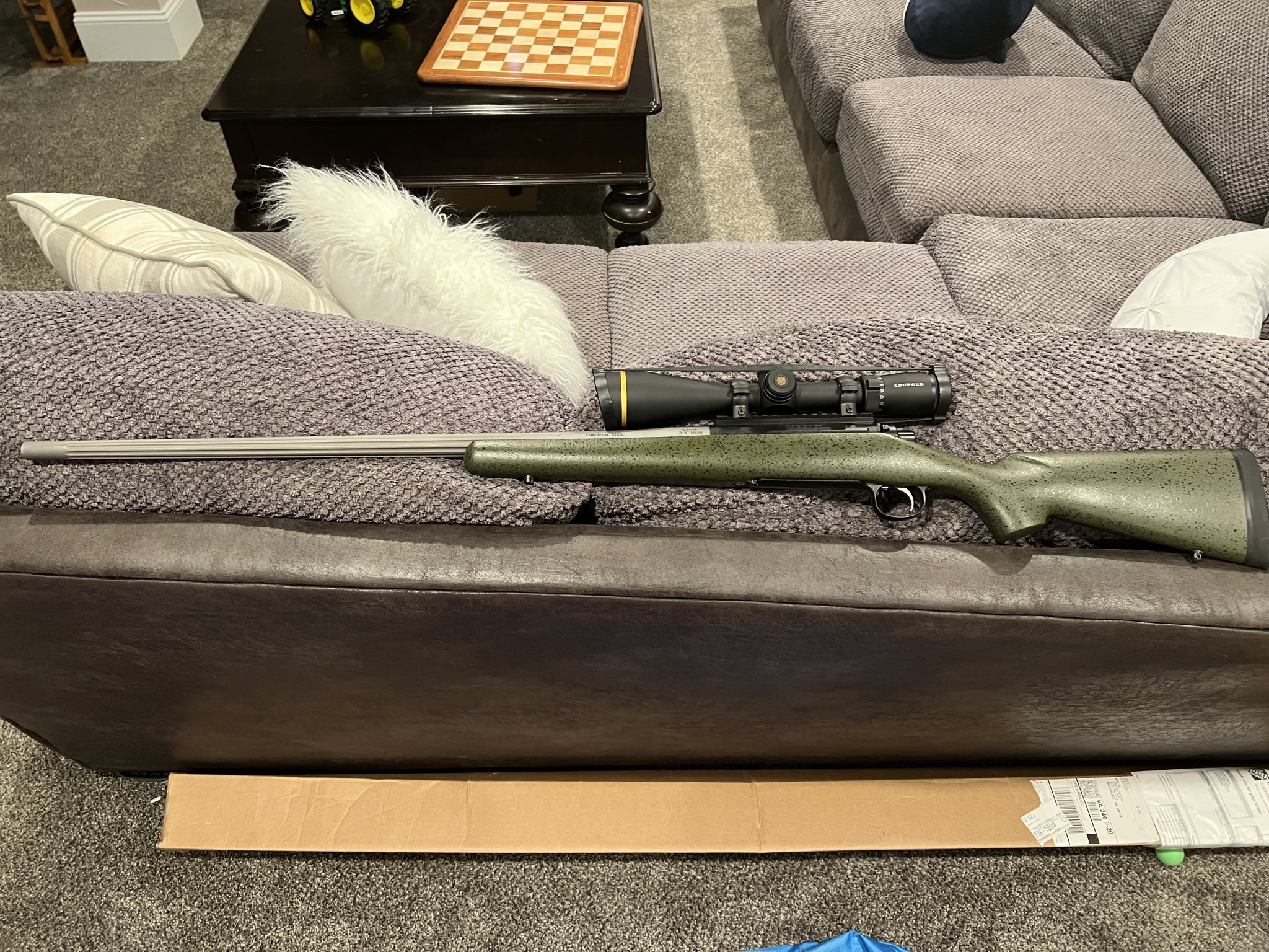

I have a stainless action and need to swap barrels but want the finish to match. Anyone know of a company or smith that does this type of finish work on barrels? Looking to match the flat nickel look pictured here from the buy/sell forum. Recommendations appreciated. Thanks in advance.

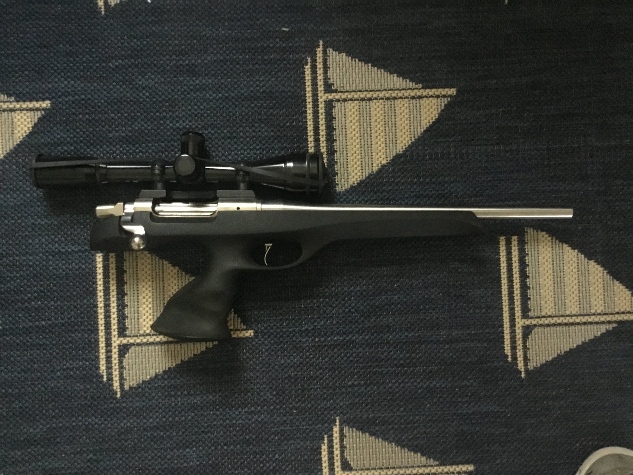

Not a perfect match, nickeled action, stainless barrel, but this little fellow Can Shoot.
if you look closely you will see a slight reddish tint on the action, particularly noticeable on the bolt shroud. Technically not the greatest picture.
Reactions: paramil
