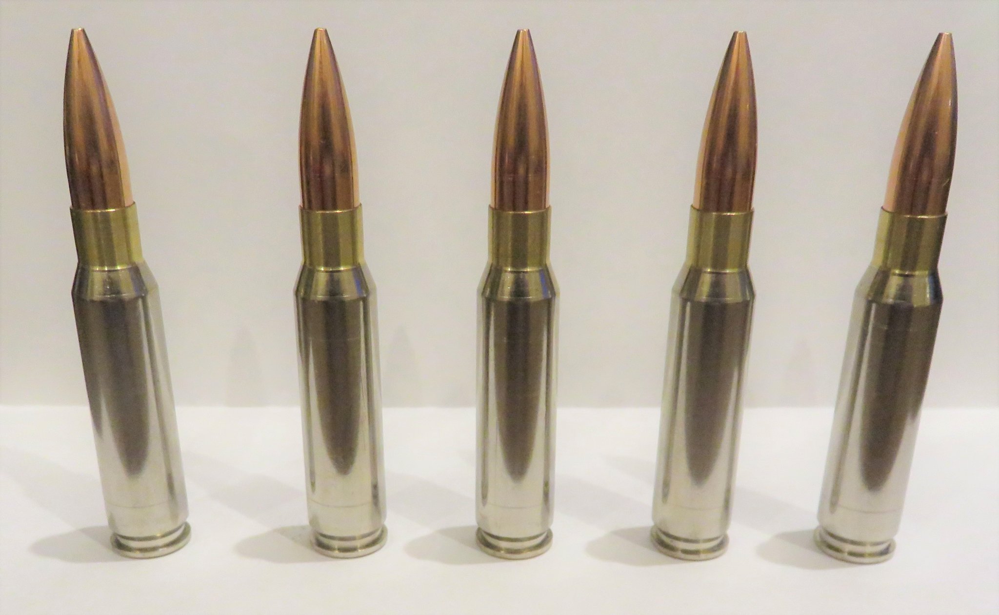

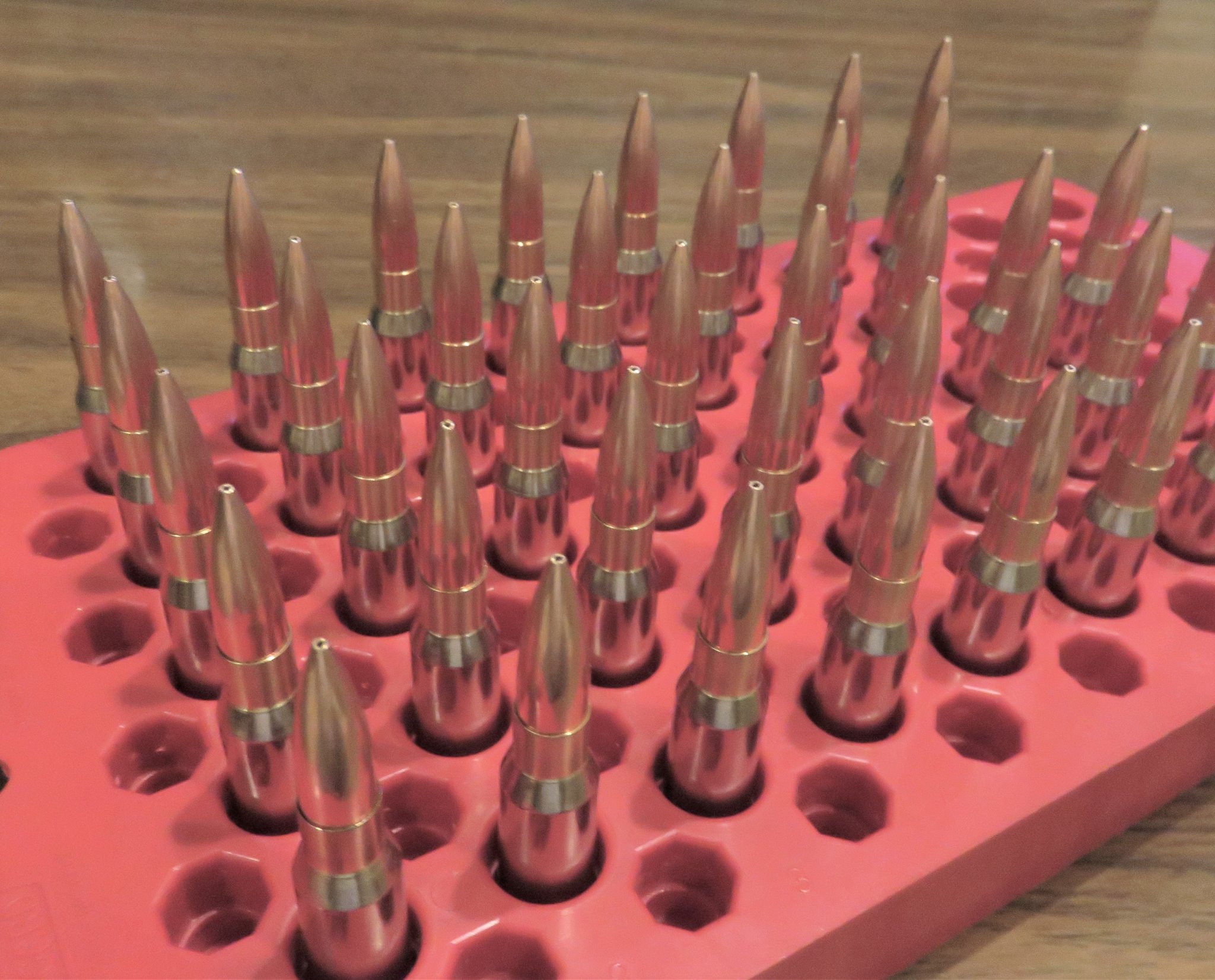

I have not had "a lot" of experience with them. But I have a batch of Federal .308 cases that I picked up as range brass and processed them for precision loading. I've turned the neck and they've been fired 4 times so far and ready to be fired a 5th firing. I was curious how they would do and so far they are doing just fine having had no issues with turning, annealing or sizing them. They've done as well as my regular Federal .308 cases that have been processed in the same way.
Here's some pictures of them:
