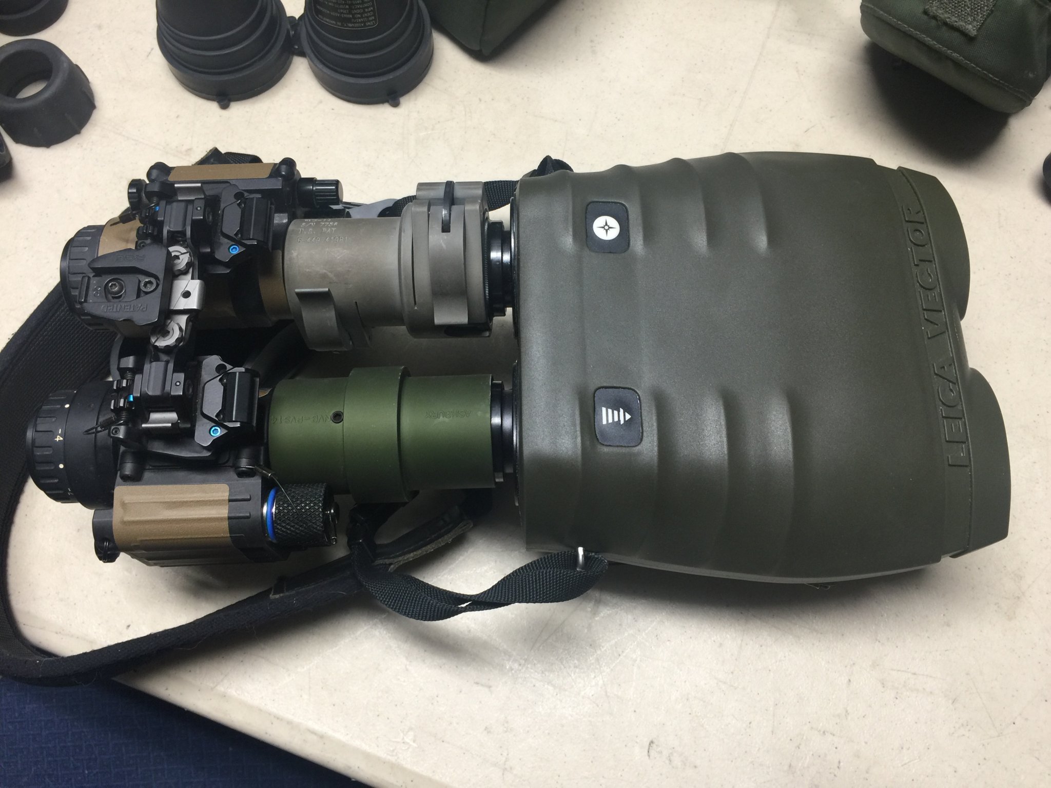

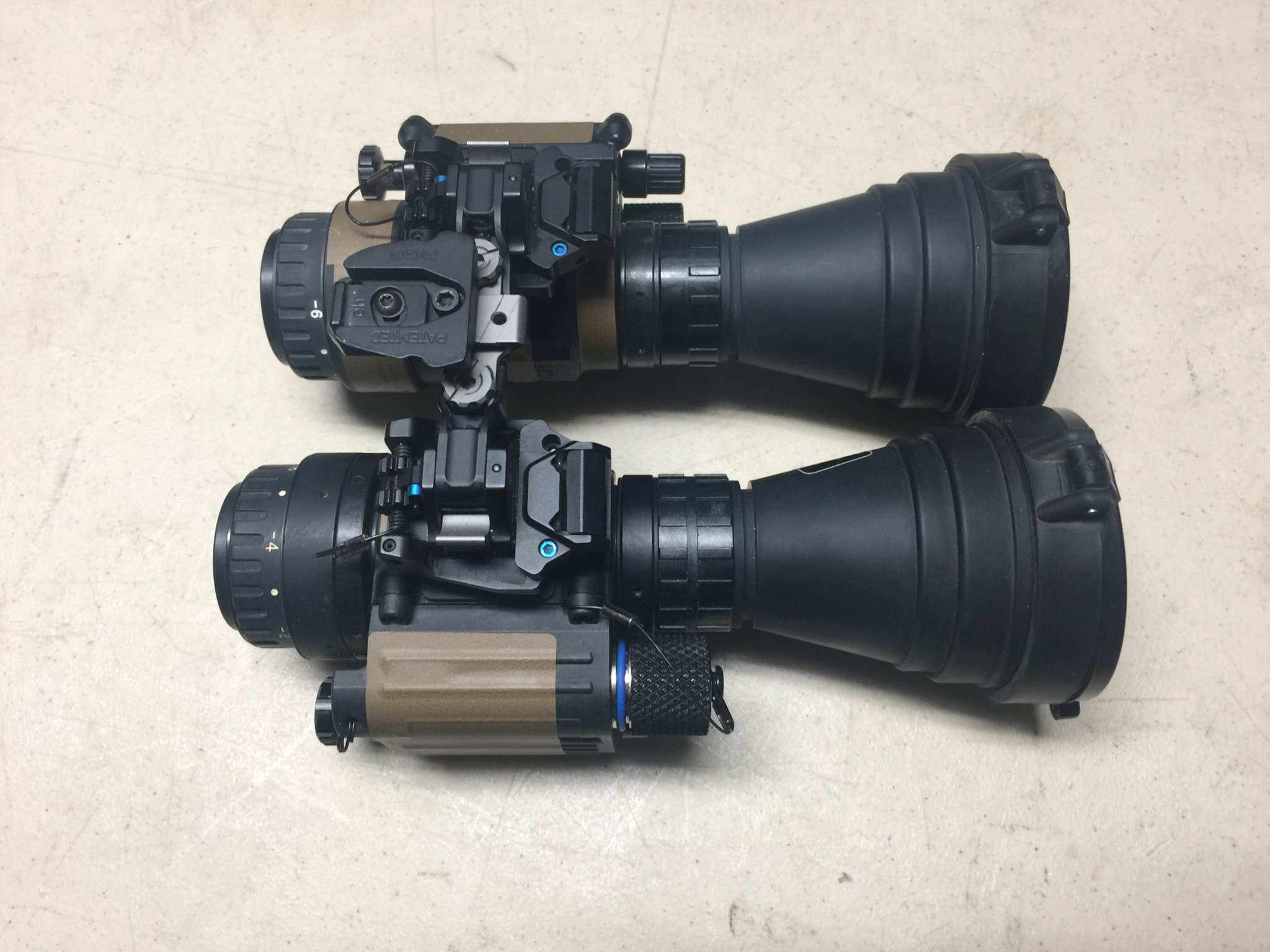

Picture, Cory?
14's as a set of 3x binos on an RQE bridge mount
The same 14's set as a 7x rangefinder bino via the Vector IV set to night mode, using the standard PVS-14 mount along with a MonoLoc to stabilize the setup.
