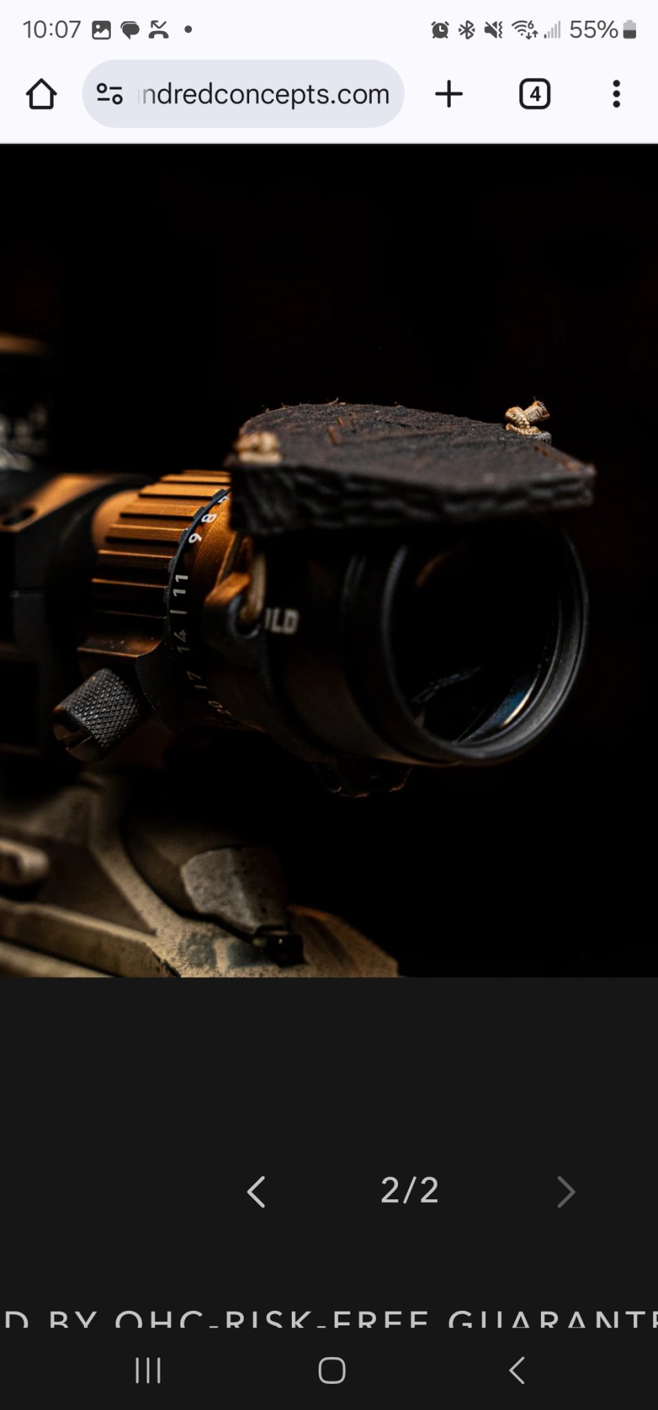

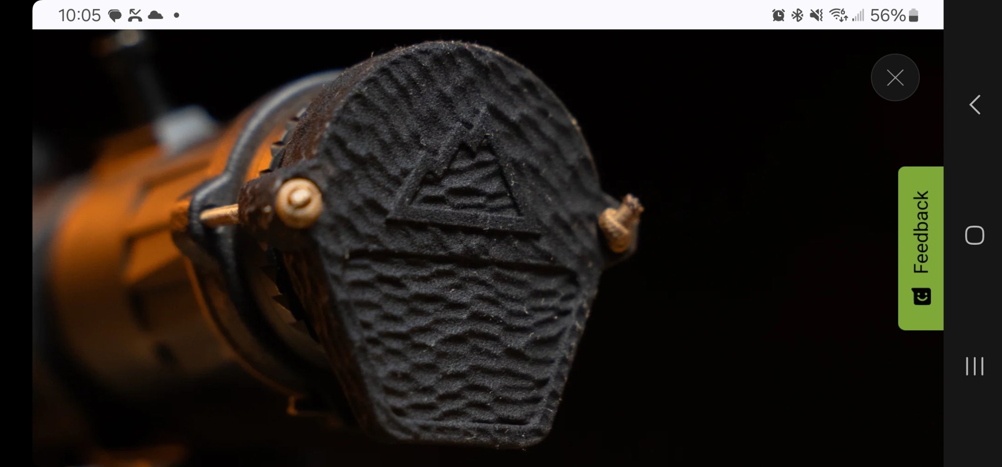

Some say the 100 concepts rear scope cap might be a good solution for the atacr rear rotating magnification eyepiece. I haven't tried the 100 concepts on my 4-16 atacr yet but plan to in the future.
Lemme know I’ll be ordering some if so. But still at the 6 o’clock position my bolt is gonna hit it i feel like
