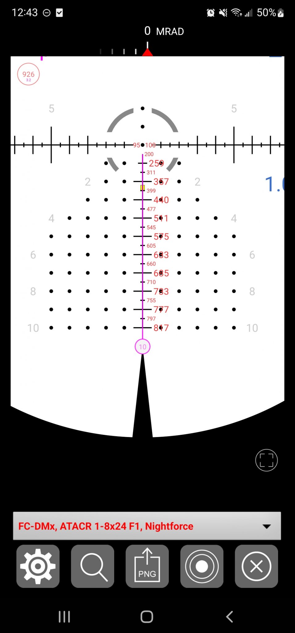

Just to understand,
At max magnification, everything below the 5mil line is blurry?
