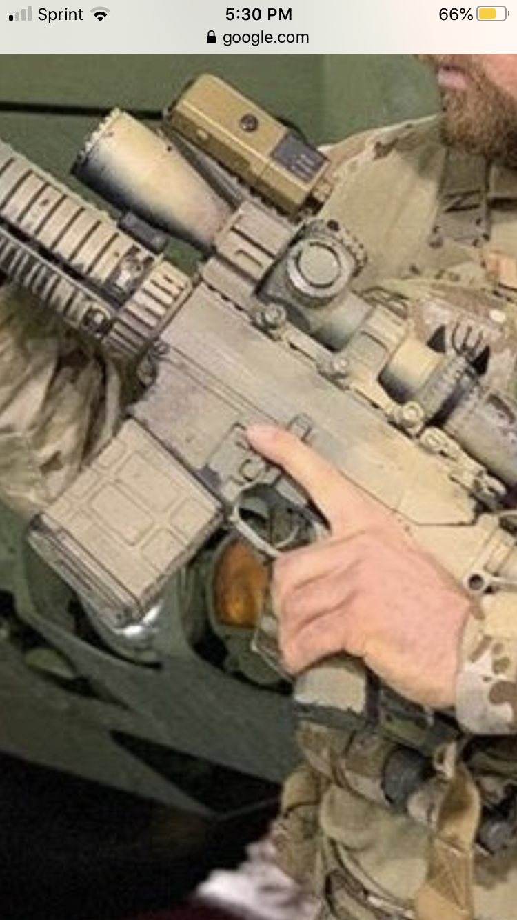

Is the same shooter using both of those rifles? Unless it is an optical illusion, it looks like the same face could not possibly establish a proper cheekweld on both rifles. The scope looks to be at least .5" higher.
Yes, I manage to shoot them both.
The Larue mount at a height of 1.53" is 0.27" higher than the Spuhr. The LaRue .260, being a big block gun, has an additional 1/8" or so more drop at the comb of the stock than does the small block Grendel. So, we're looking at a total height difference from the comb of the stock to the center of the optic on the order of around 0.4".
Why the different heights for the mounts?
The LaRue mount is that 1.53" height to ensure it is coaxial with our military's clip-on night vision devices. It's a bit high for me in the prone position but fine for all others. Since most tactical shooting is done from other than prone, the height is an intelligent compromise.
The Spuhr mount, originally produced in this height for the Noveske Shooting team, is really the height I prefer shooting prone. But it requires an aggressive cheek weld in the more erect shooting positions. Another compromise. Seems to work for me ok. Looks cool, too!
I guess I do have one big melon of a head. It must therefore provide me with a lot of options as to where and how I establish my cheek weld.
To drift the thread, I don't have a big head and my jaw doesn't seem wide or anything, but I can't shoot guns with a tight cheek-weld.
Remington rifles and shotguns with irons, I literally can not look down the sights at all. My scoped rifles I shoot with cheek weld at about the corner of my mouth.
I do decent with a 1.5" center on an AR,but it feels low and is very fatiguing to use for extended time.
