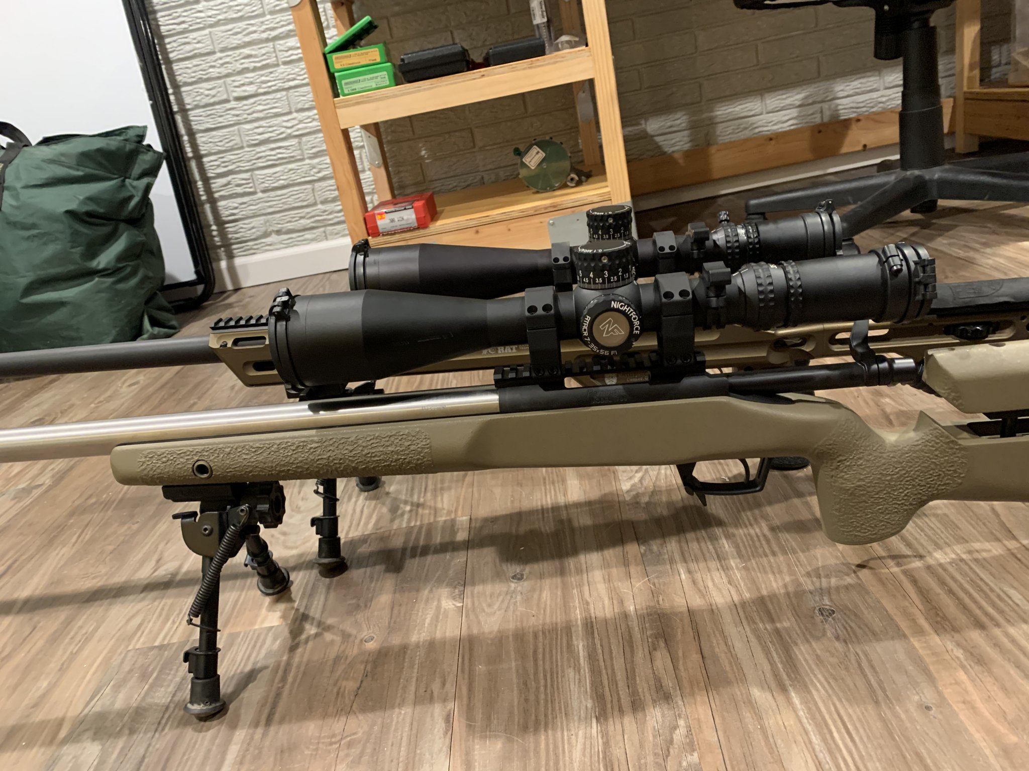

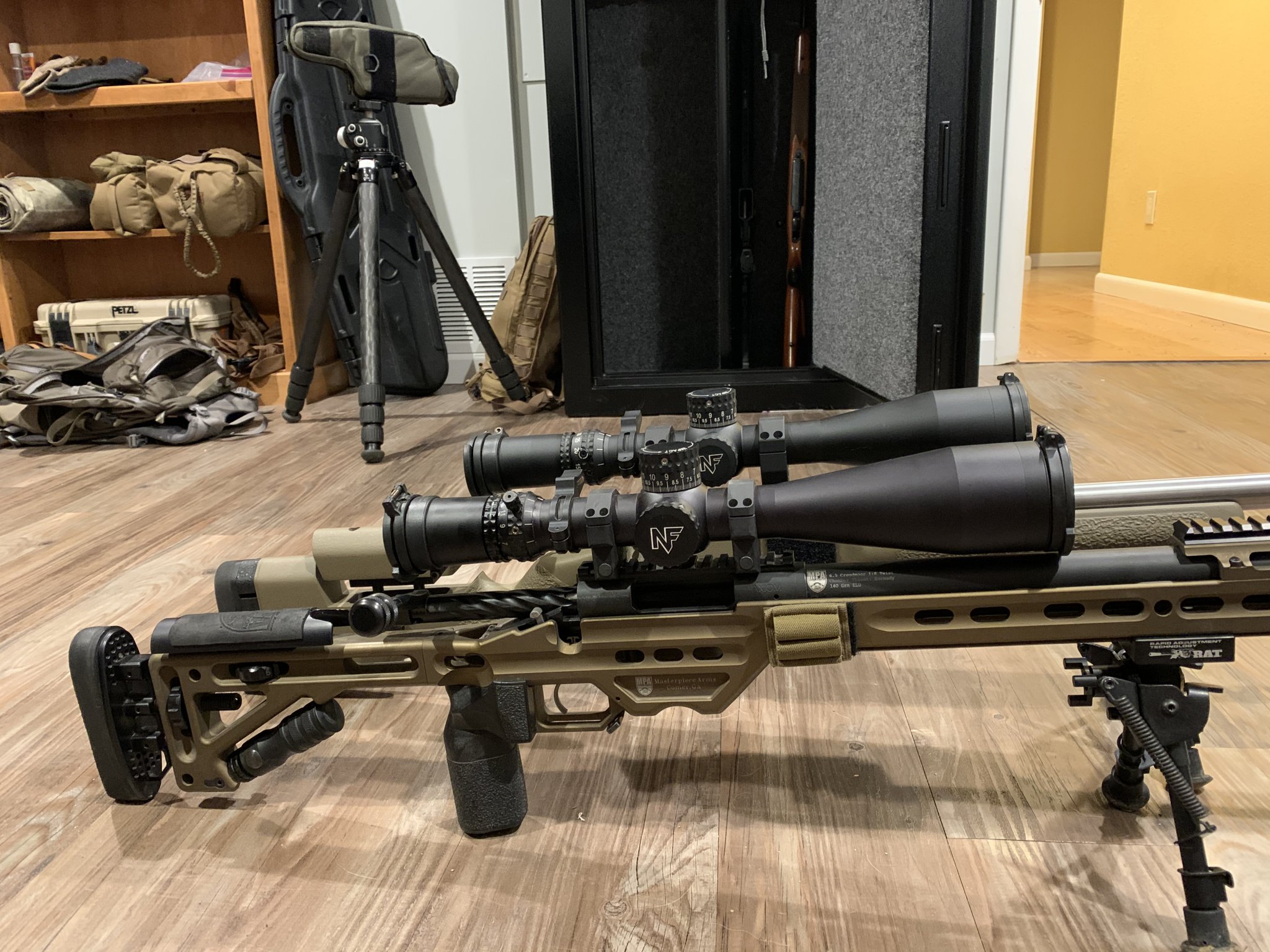

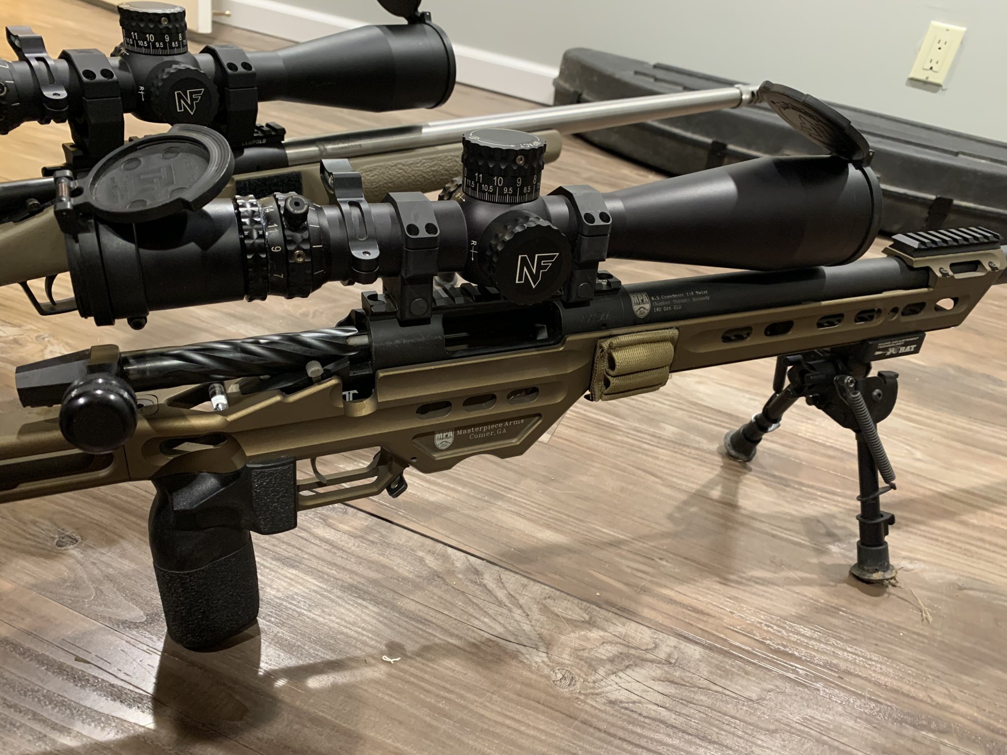

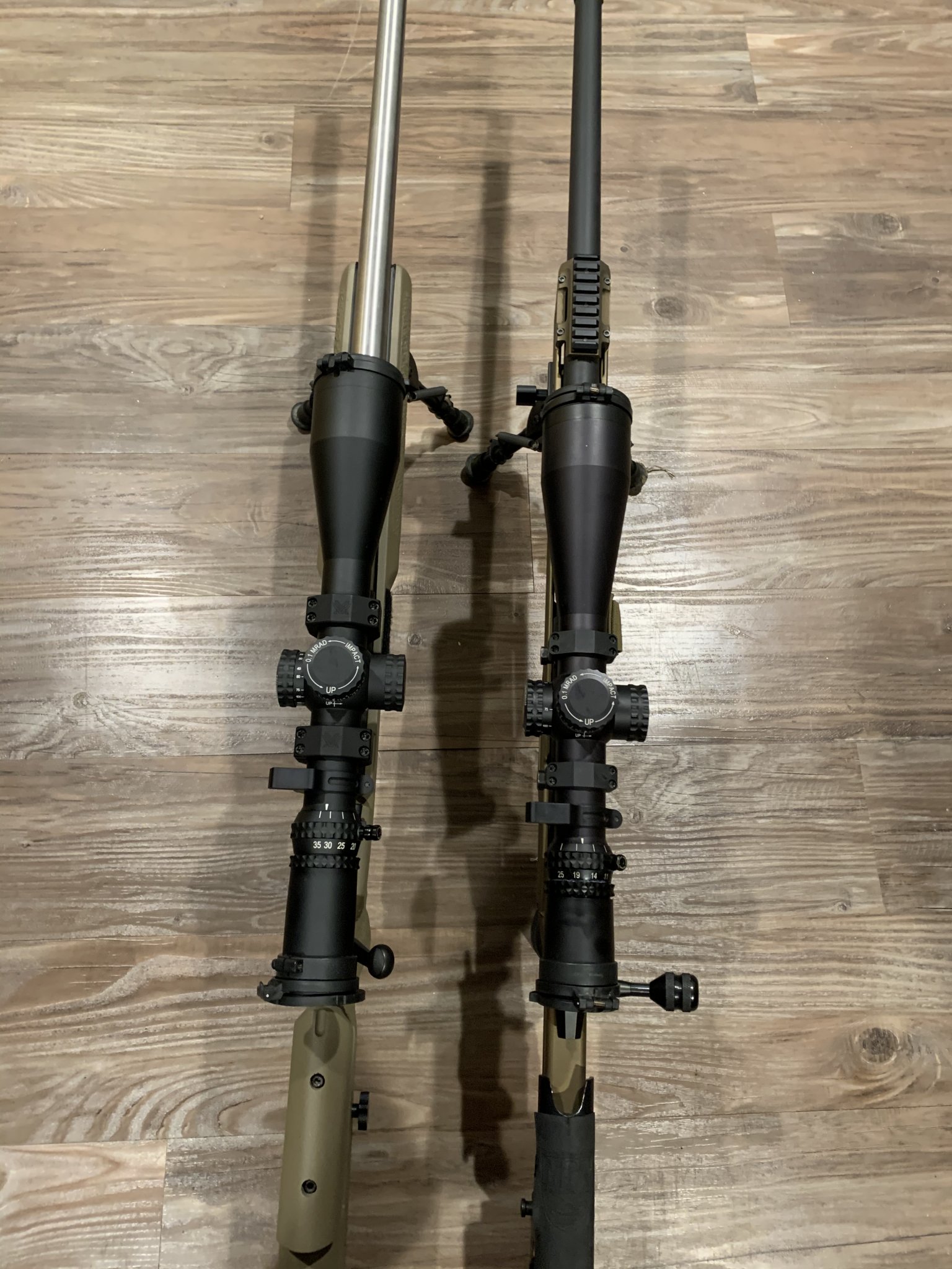

Yea no problem. I love NF scopes! I bought one after I had one on my m110 which I put through the ringer overseas and it held up great and outperformed the leupolds by a long shot. After that I was sold and have bought them since. The MIL XT reticle looks good. I just love all the features of the T3 but that's what I was taught on so I am partial.
Anyways maybe (if I remember) I'll get some pics of it on the range this weekend other wise I can get some out my window or something. I always find it nice to see some pics. I'll get some down the glass the best I can. And of the two on the guns so you can see the size comparison of the two.
