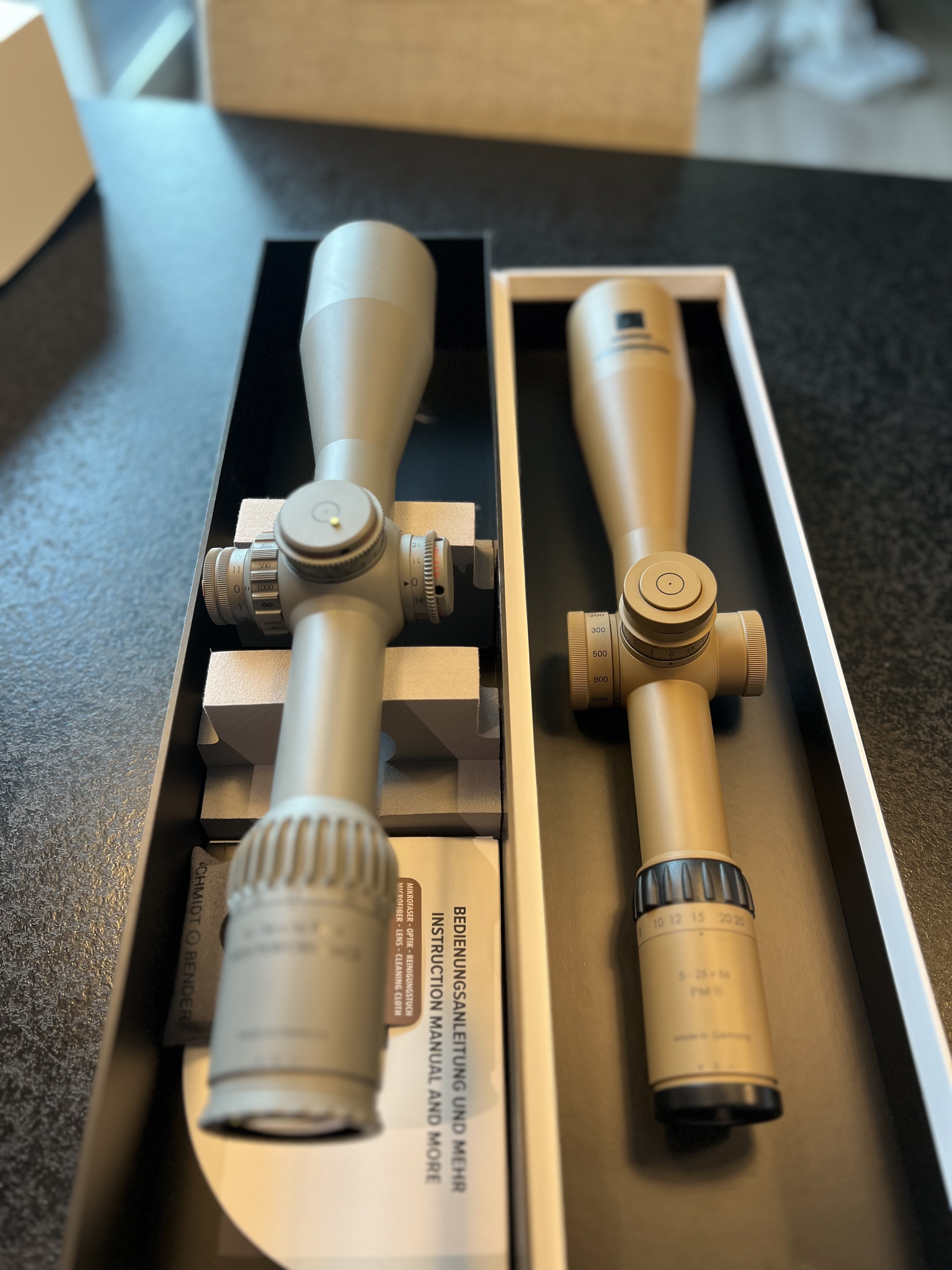

No tunnelling in the 6-36 in comparison. I really enjoy the wide FOV in my non US spec 6-36. I would say S&B has done alot right with the newer gen scopes, great optical properties, many different configurations and alot of elevation adjustment.
