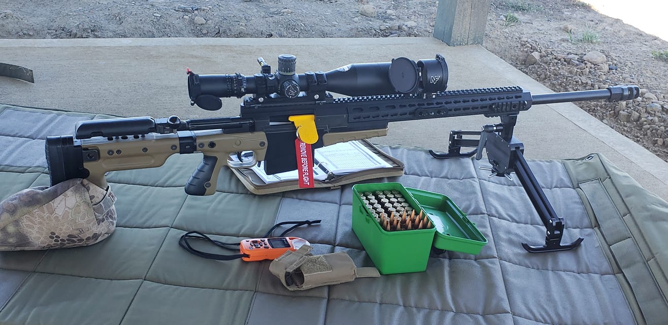

I use the Nightforce Wedge (50moa) to stretch my 300NM (NF ATACR 5x35) to 2500 without holdovers. The young lady who won King of the 2 mile this past year had one on her 375 CT although I believe she used the 100 MOA version. Same wedge on my 338LM
