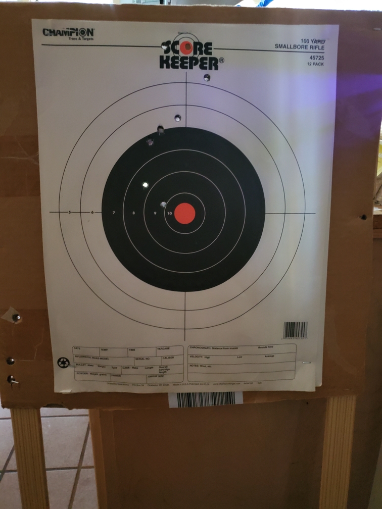

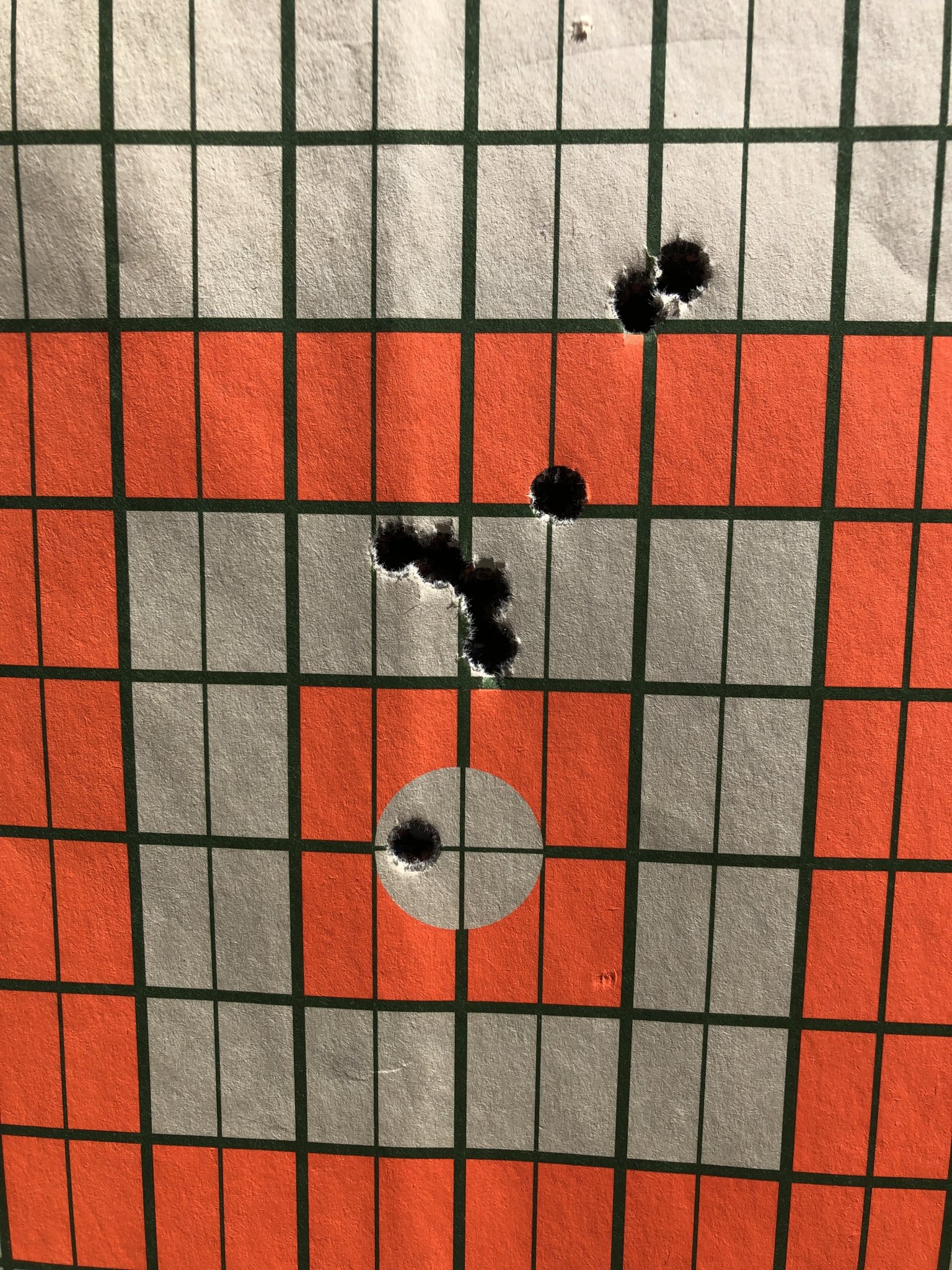

My first post. I mounted a NXS 5-22x56 that I bought frim MOA RIFLES on my Weatherby Mark V 338/378. I spent enough ammo to dial it in at 200 in the black and parked it. Went to range a month later and fired @ 200yds and not even on the paper. Only had 12 rds with me re bore sighted at 100 and put in black again at 200-ran out of shells. Went to range next day with more ammunition set up 100&200yds shot 4 @ 200 not on paper shot @ 100 9"" high . Re bore sighted put center @ 100 did not adjust scope shot 8 consecutive shots and impact continued straight up by 1"-1 1/2" each ahot until off the paper. Checked alltorques on rings and bases perfect. Removed scope called MOA received zero help other then to send back to NF. Leaving for hunt in 12 days. Purchased new SHV Mounted shot 4 touching perfect . Killed giant moose . Recived NF NXS5-22 back from repair with note that said scope was perfect no repair- BS - that thing had to either be replaced or they did jack shit to it can these guys take ownership for having a broken scope or am I hallucinating

No can zered it 3 times on200 each time afte couldnt hit paper put new scope in same rings and bases shot great going to put it on 30/378 and shoot it . If it shoots good NF is lying about repairs if not it's going back to IDAHO again
So back at it. New bases and rings for my 30/378 steel 1 piece nightforce base 4 screw nightforce rings with rear leveler everything torques to nightforce spec mounting bolts from actuon to stock torqued 65. Bore sighted the gun with Weatherby ammunition 180g accubonds. First shot after bore 3 " left made appropriate correction started shootin less then 1/2" groups programmed G7 and hit everything out to 650. Returned scope worked as one would expect a nightforce too. So only conclusion I could believe after the problems with it on my 338/378 was that nightforce fixed or replaced the scope and just didn't want to cop to one of there scopes having an issue.
