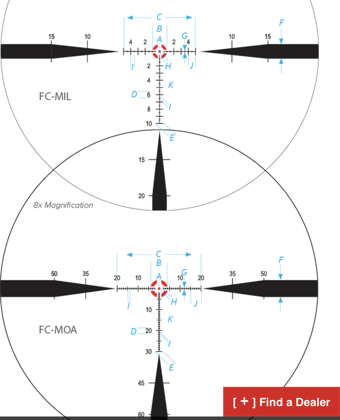

Side note on the nx8 which reticle do you prefer and why? the moa the stadia seem obtrusive but workable, but the mil seems potentially hard to pick up on a lower power. (having not looked through either thats just a perception for the website)

And those MOA and mil reticles on the nx8 made me switch to mil when I realized how little serious scope manufactures care about MOA shooters. That MOA reticle SUCKS !

Nx8 4-32 with the mil-c was very usable down low, to the point of being too thick up top. But, let's face it, 8x erector is a giant compromise on either end.
