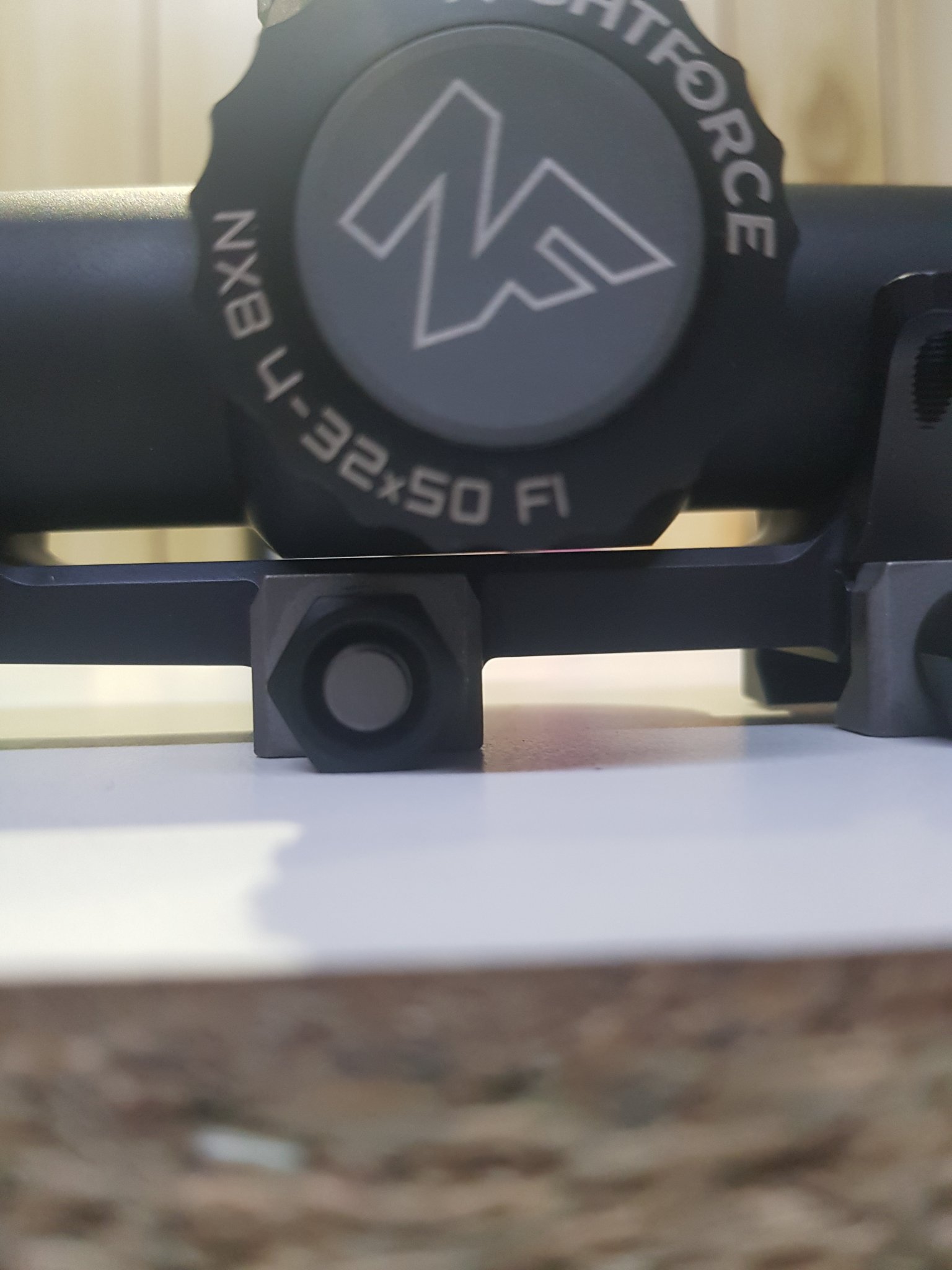

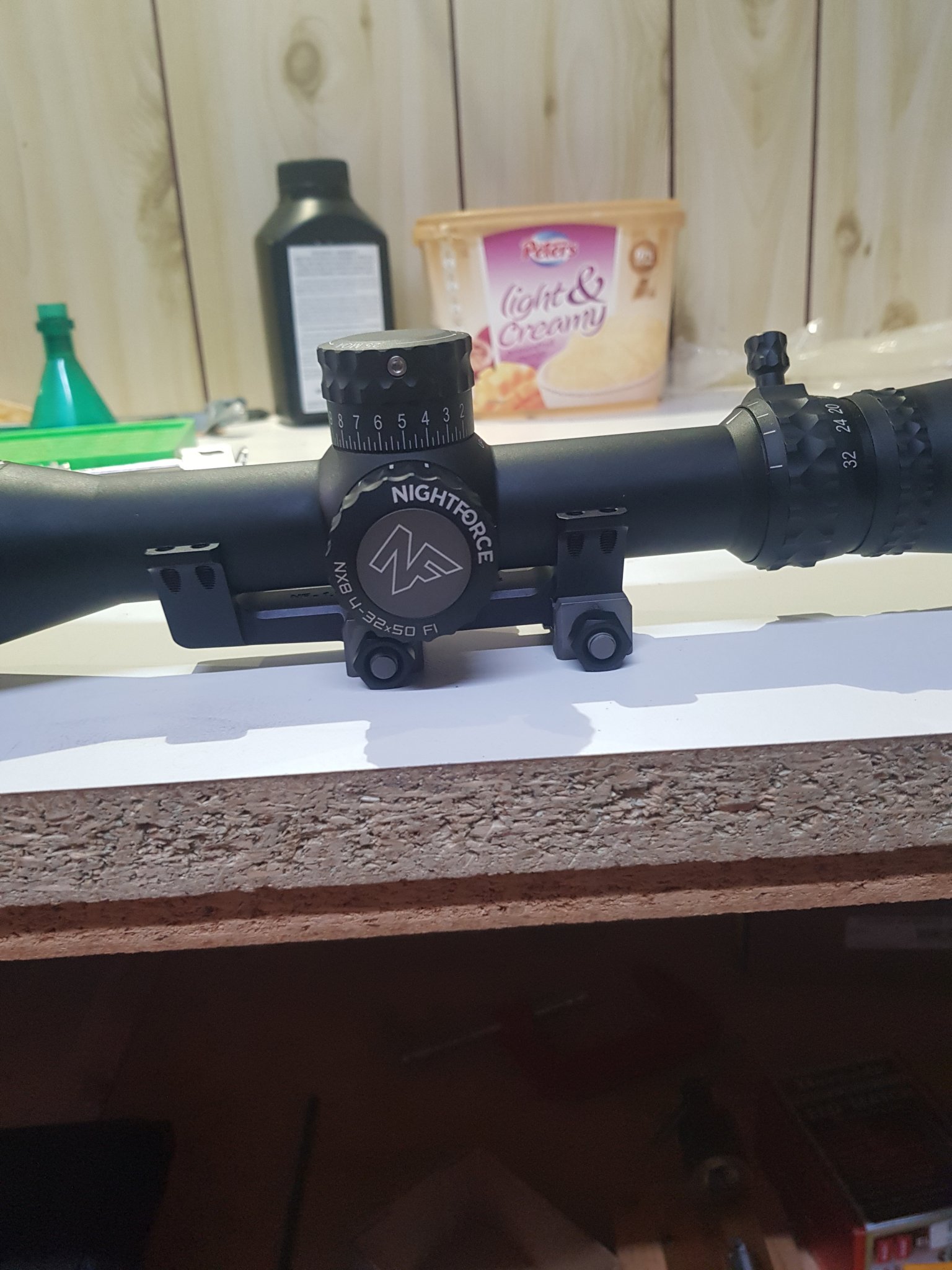

    Wondering if you can help me with a question the clearance on my Nightforce Unimount 1.125" and the bottom housing of my Nightforce NX8 4-32x50.
    I got this height mount as it matches up great on my KRG Bravo and still has a fair bit of clearance between the objective and barrel.
    BUT......as you can see in the photos attached theres a very very minimal amount of clearance between my rail and scope. According to my feeler gauges theres only 0.002" or so.
    Is this normal? Or have I stuffed something up?
    Thanks for your time

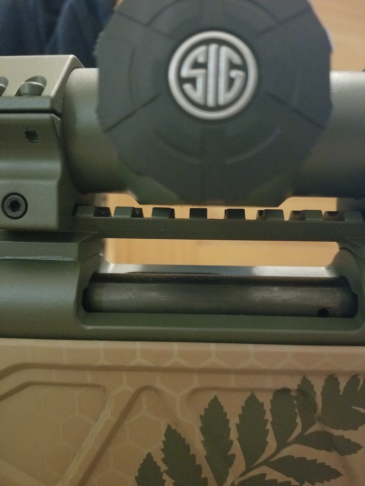

    I ran that setup in the picture with absolutely zero problems. The only difference I see, I had rings and you have a mount.
    There is some speculation that under recoil, a mount will flex a bit and cause the bell of your scope to hit your barrel. In your case, that could be the erector housing to bottom out on the mount. My opinion, run it as is. After you put some rounds downrange, check for a shiny spot on both the erector housing and mount. If present, that will be your indication that they are making contact under recoil.
    I don't really believe in this theory about flexing under recoil, but I'm a "see it to believe it" type of person and I have never seen it in my setups. Again, I've got rings and you have a mount so our setups aren't exactly the same. Just run it and keep checking for those rub marks. They probably won't appear at all.
    Be prepared though, I've got a feeling that just about everyone else will probably comment that you need to get a higher mount lol.

    As long as the erector housing isn't touching the mount you are good to go! If you ask me that's about perfect. No reason for it to be higher than it needs to be.
