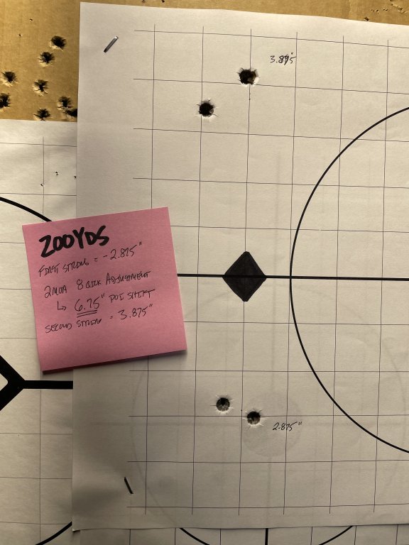

I start at 200yds and am about 4” low. I dial up to my zero, then go back to 400yds and come up the corresponding MOA and I’m 11” low. I dial back down to my zero and go back to 200yds to re-confirm and I’m now 2-3” high at 200yds. All grouping well, just off elevation-wise. Now I’m getting upset and frustrated and decided to take a break and think things over. I went back home. I checked action screws, ring bases, ring screws, everything was tight at spec. The gun and scope did not fall or get hit at all. Nothing rattles in the scope. Rounds are all from the same batch I loaded early this summer. Rest is the same. I have about 60 loaded rounds left from this batch and leave for a hunt in just over 2 weeks so I’m feeling some pressure here. I’ve been through something like this before with a Leupold VX6HD scope that lost it’s tracking accuracy due to a broken internal part that Leupold repaired. It held zero like this one does, but as soon as I dial a turret, it never would go back to the same zero.
I next decided to try a vertical MOA dial test to test the elevation dial tracking. I get to the range. Set up to zero at 200yds and fire 2 rounds. I’m 2.8” low (see photo). I want to be 1” high at 200yds so I come up 8 clicks or 2MOA (2.8” + 1” = 3.8”/.50(per click) = 7.6 = 8 clicks rounded = 2 MOA. I fire 2 more rounds and my POI is now at +3.9” high. I stopped at that point and went home, if I’m off with a 2MOA vertical dial test, I’m sure I would be way off with a 20 or 30MOA vertical dial test. I can’t think of anything else other than the elevation tracking is off in the scope?? After dialing 2 MOA at 200yds which should have been 4” my POI moved almost 7”. I don’t have unlimited rounds left to shoot, so before wasting anymore ammo, I went home and planned to ask you guys what your thoughts are?? Has anyone ever experienced failed tracking in a NF scope? I specifically purchased NF for their dependability. Guy who I bought the scope from said he never had any issues with it and it worked great all summer for me. I also plan on calling NF today to see what they say. Any suggestion or ideas? Almost the exact same thing happened to me with that VX6HD just over a year ago and after driving myself nuts for a couple weeks, it ended up being a broken scope. I should of never touched it and never tried to adjust that 1 click down, it's too late now. I don’t have another rifle ready to go I can put it on to test. I do have a couple other VX6HD’s I can swap it out for on this rifle but I lost all confidence in those the last time one of them broke on me. SO FRUSTRATED!!!

UPDATE: It ended up being the clutch screws on the turret stem. I first did an elevation dial test with the scope and a large piece of cardboard at 100yds with a plumb line and length numbers. When I dialed up everything seemed to track well, but dialing down I never got back to the same starting point. I tightened all 4 clutch screws and everything fell back into place. Fired some rounds and she's hammering again. However, I have not re-set the zero stop, I don't want to touch that whole clutch system again with my hunt so close. How much do you guys usually leave under your zero setting on the elevation dial if you ever need to dial down from your zero? 2-4 clicks?
