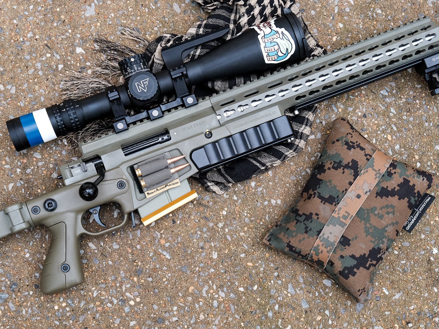

Anyone know if the Nightforce RAP (rail top ring cap) A428 will work on a Unimount which uses the 4 screw top ring cap? Their website description says it will... I already have the scope mounted with an old 10moa (maybe 20?) Unimount and was looking to add the rail cap. I want to mount an old Docter red dot sight I have sitting in my safe above a Vortex AMG on an AR I built. I had a setup like this years ago using ARMS 22M rings and liked it.
Cant use an angle/side mount as I typically run an E&L brass catcher that snaps onto the side.
RAP™
Our Ruggedized Accessory Platform (RAP) provides four inches of rail space above your riflescope for mounting of lasers, illumination tools or other accessories. The RAP is optimized to withstand heavy recoil and still maintain zero with even delicate accessories or sensors. Designed to fit four- and six-screw X-Treme Duty™ rings and Unimounts.
It does. It comes with a half ring to mount to the two extra screw holes, and can be mounted in the front or back.
