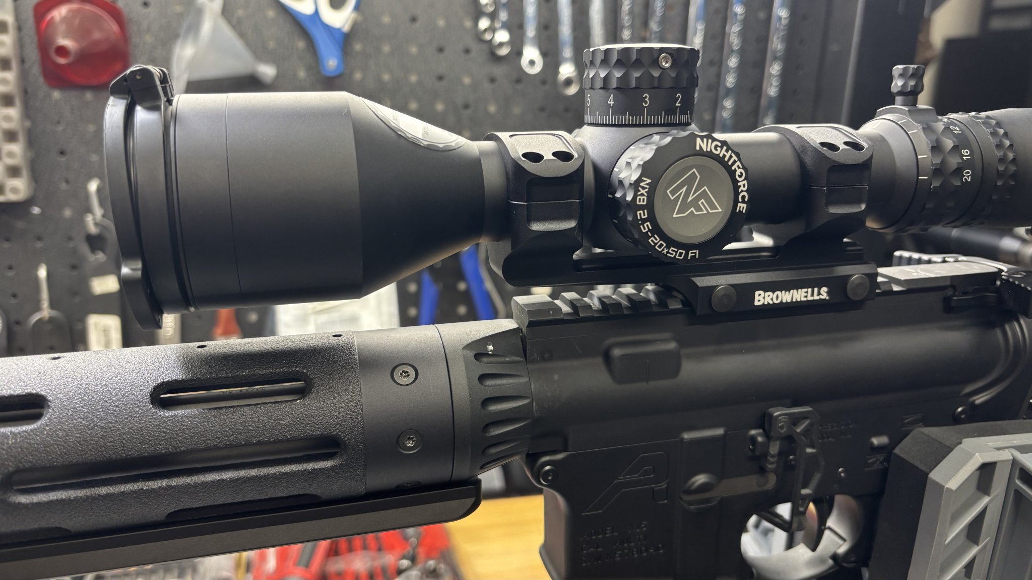

Will the 20 MOA 1.375” Uni-Mount with a 2.5-20x50 NX8 clear the rail of an AR?
I’m actually running a JP handguard without a rail on top on this rifle so I assume it would but you never know.
If I move it to a rifle with a full rail will it still fit.
Would the 1.125” fit this rifle? I assume the 1.125” will not clear a traditional handguard and rail?
Pay no attention to the cheap Brownells Mount. It was free. Just acting as a stand in 😃
The A191 1.375 20MOA will clear the top rail of an AR handguard, so you'll definitely be good to go with the JP handguard. If you'd like, I can snap some pics when I get home tomorrow afternoon.
