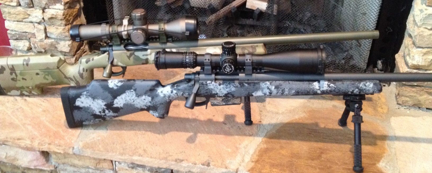

I have both the F1 and the 3.5-21 ERS. I have plenty of rounds downrange through both in all sorts of conditions. The glass on both is great. I prefer the F1 knobs, but not by much. I just find the NF to be faster, especially when my hands are cold and I can't see the knobs for whatever reason. Some folks prefer the Bushy knobs. They both have a zero stop and I will never buy another scope without this feature. The illuminated reticle of the F1 is a huge plus for me. As has been stated it is not easy to adjust. Out of the box is was far too bright. I first got a look at it in complete darkness and it about blinded me. I set it once and have never touched it again. Getting the cross hairs on a south Georgia hog at 2 a.m. at 300 yards and a crescent moon is not an option for me without an illuminated reticle (NV coming up next year). The Bushy is not illuminated, but I have never used it where I may have needed it. It picks up IPSC steel at 1,200 yards (and beyond) in foggy low light conditions just fine. The extra magnification versus the F1 provides a nice view of the splash. But with mirage you probably won't be able to make use of that extra power.
