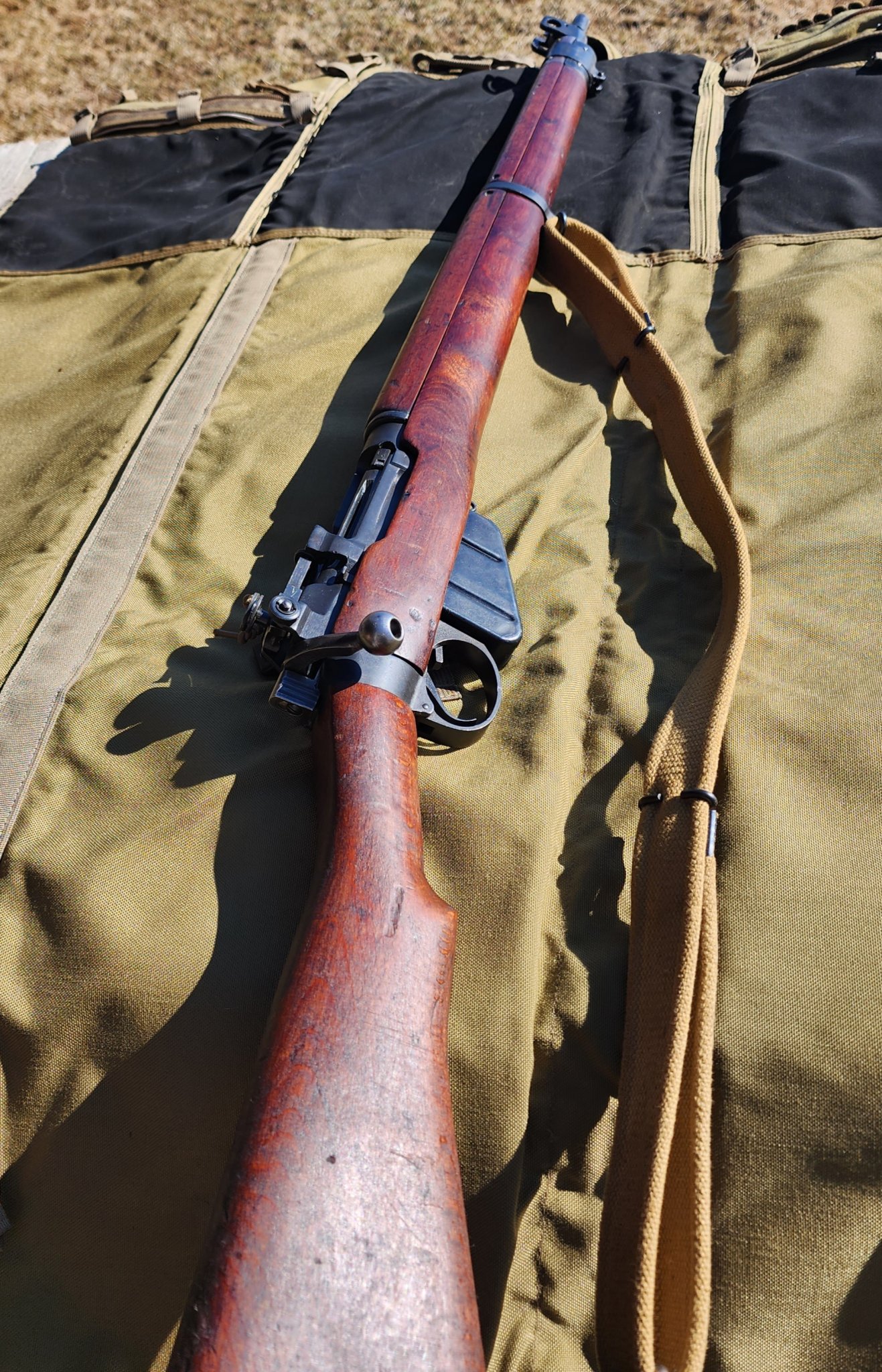

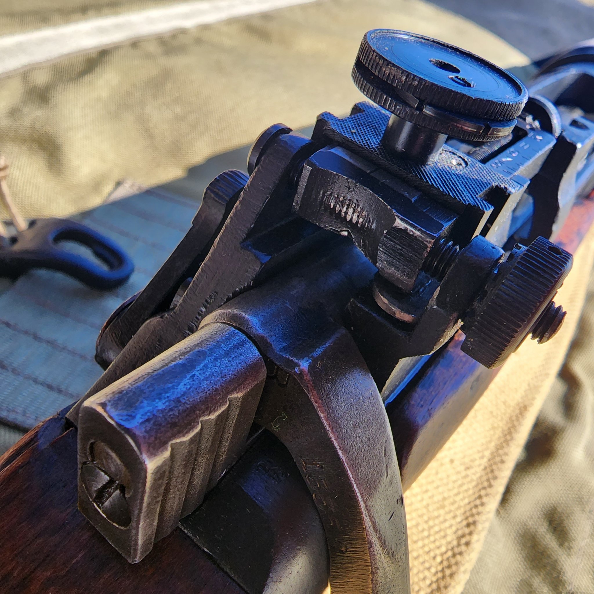

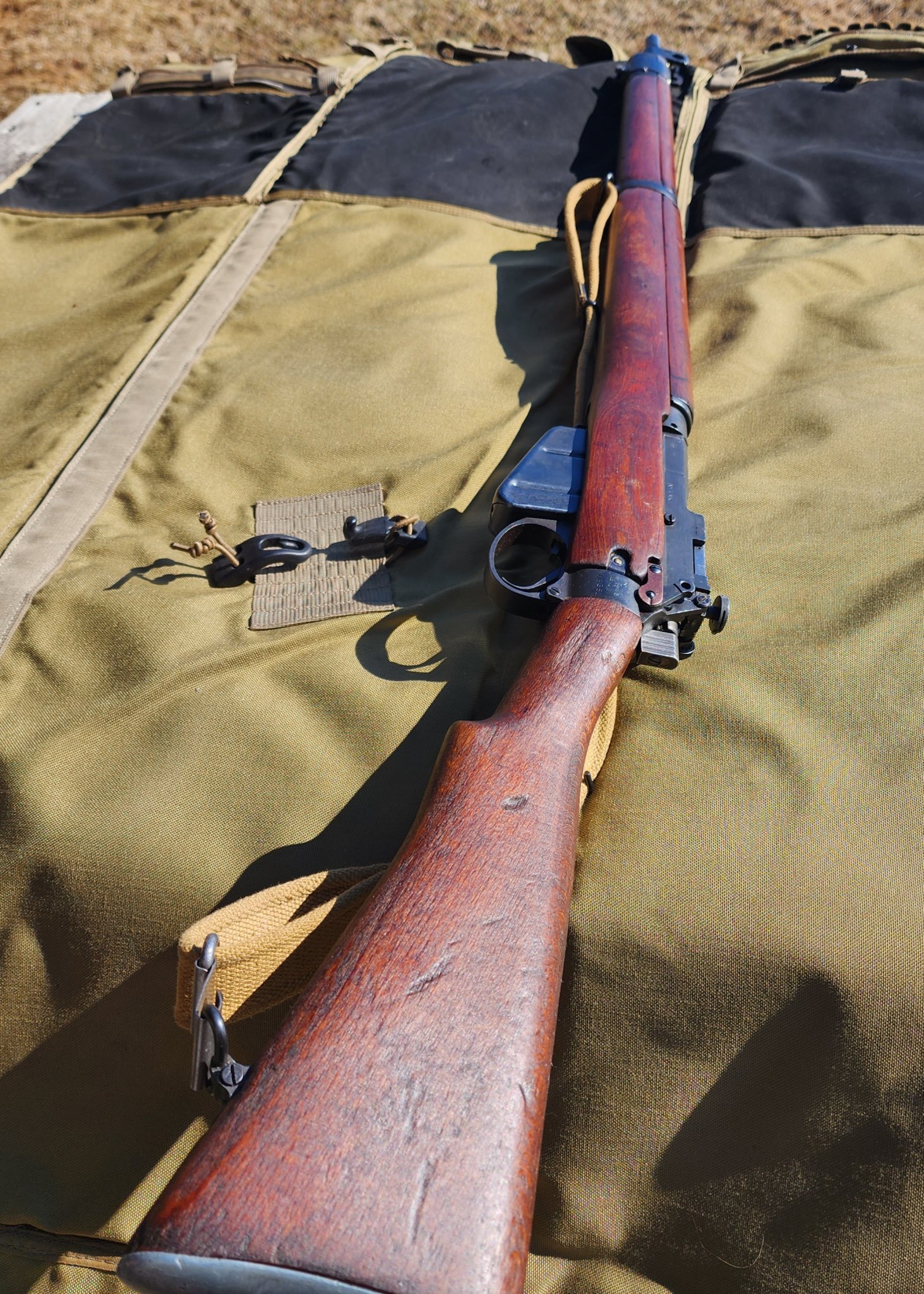

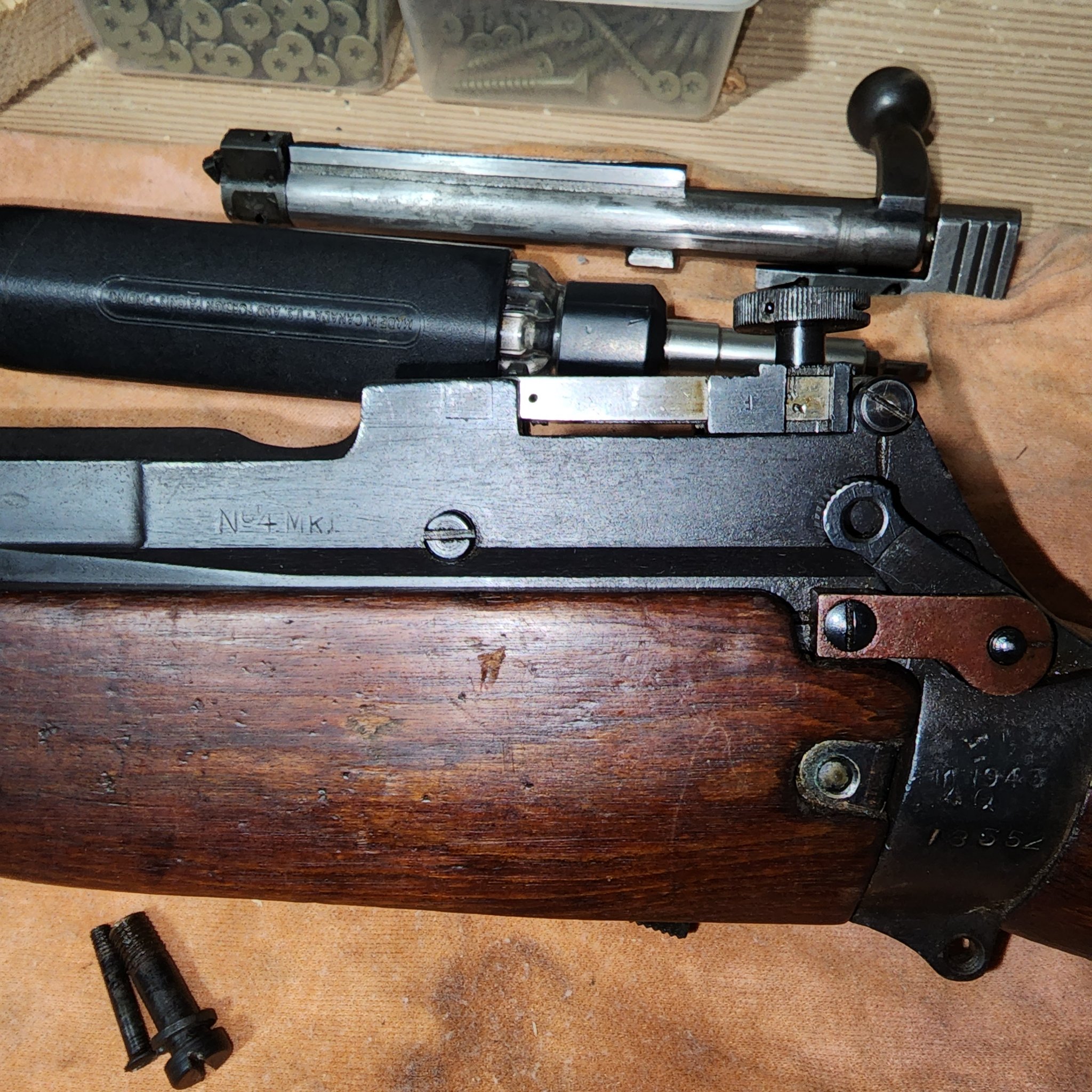

    Just got this. Wanted to make a No4T clone. It's so nice I think I'm going to just oil it and shoot it.
    The stock is tight were it needs to be. Has the right pressure on the barrel. The 2 groove rifling looks very strong. Everything is numbers matching minus the front barrel band.

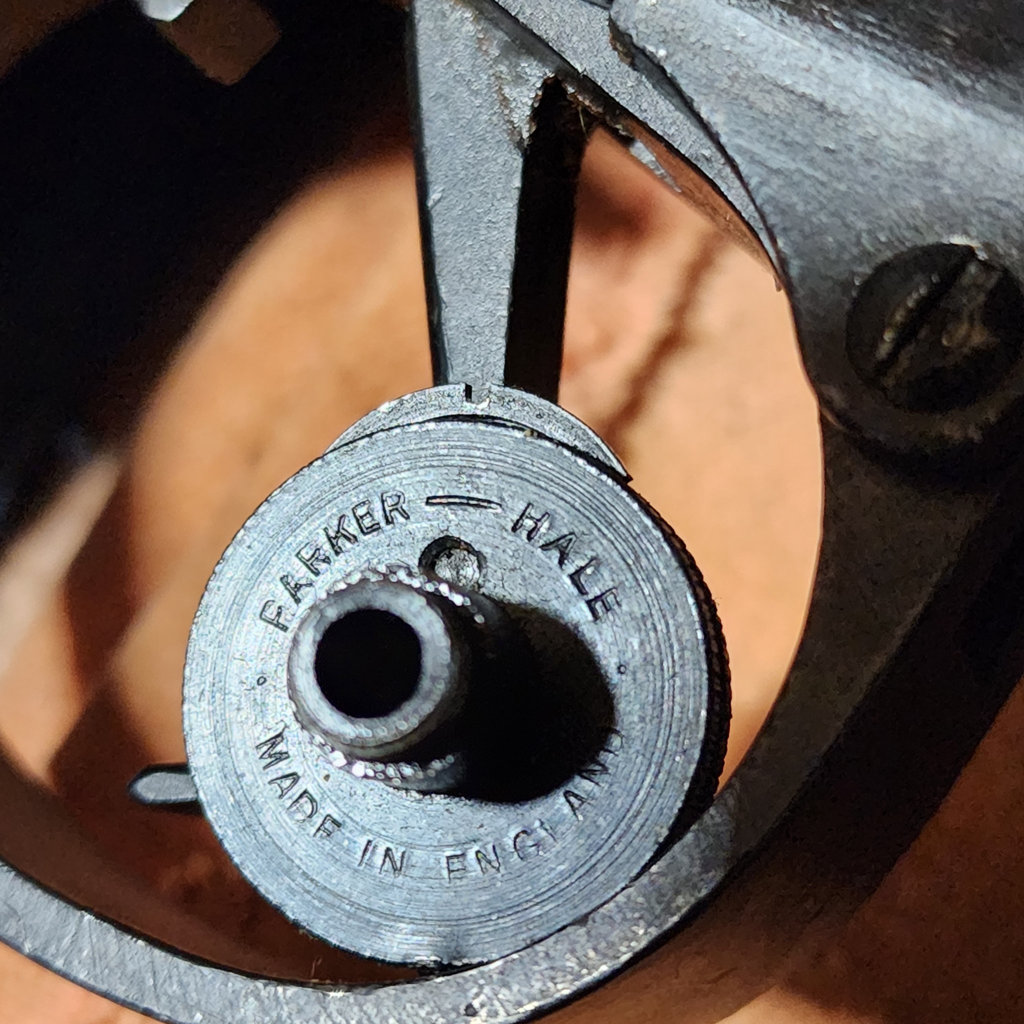

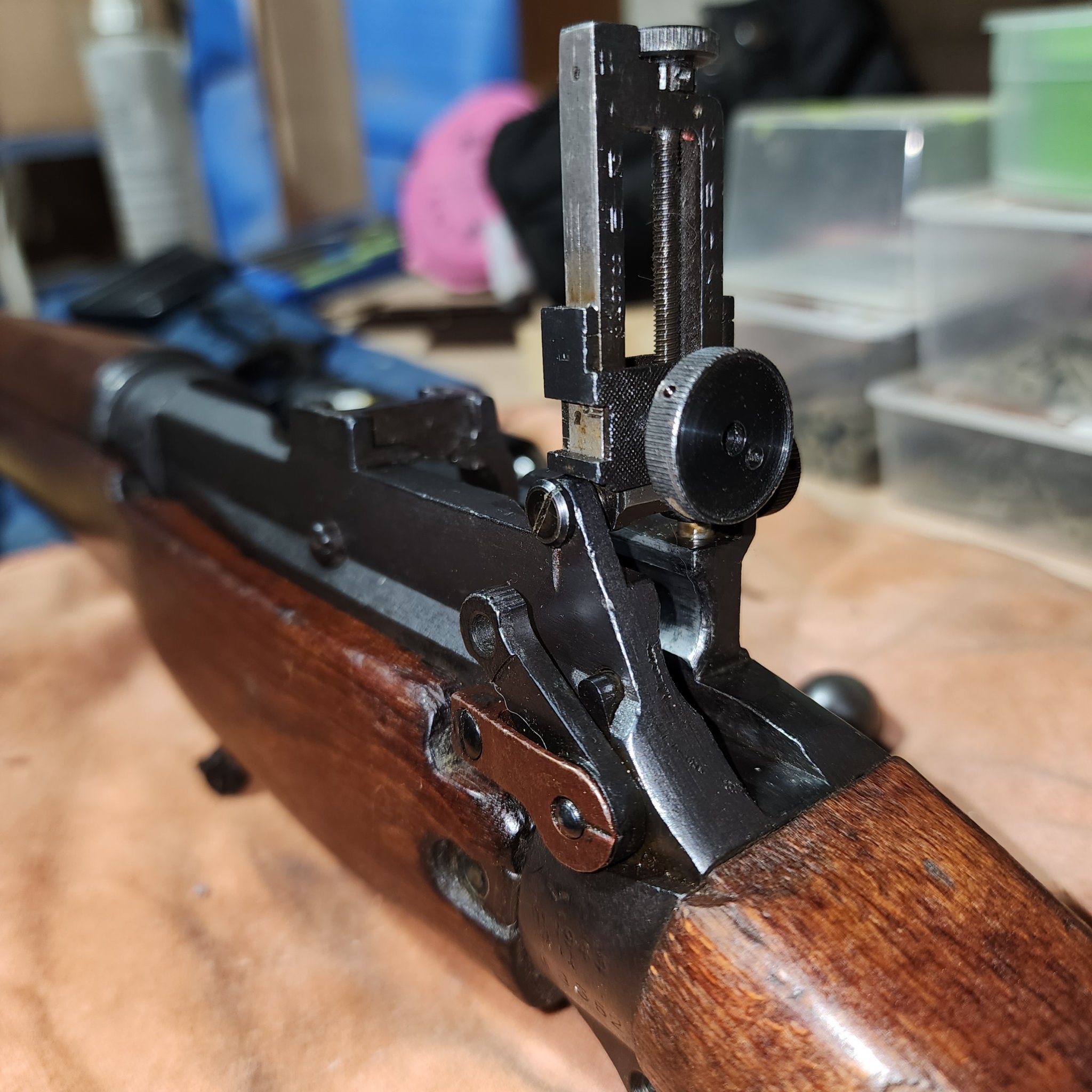

    I'm very excited to shoot it. Never seen a no4 with this parker hale peep sight. It has 5 selectable apertures.
    I've got one of those peep sights in a box somewhere. I'll have to see if I can fit it to my Lee Enfield No.9 rifle (looks externally like a No.4 but is a single shot in .22LR).
    The previous owner definitely tapped and modified the existing sight. There is some clearance taken off the bottom of the sight when flipped up. Hopefully my windage is on, because I don't think I can move it. They filed the bottom so much part of the screw is showing.

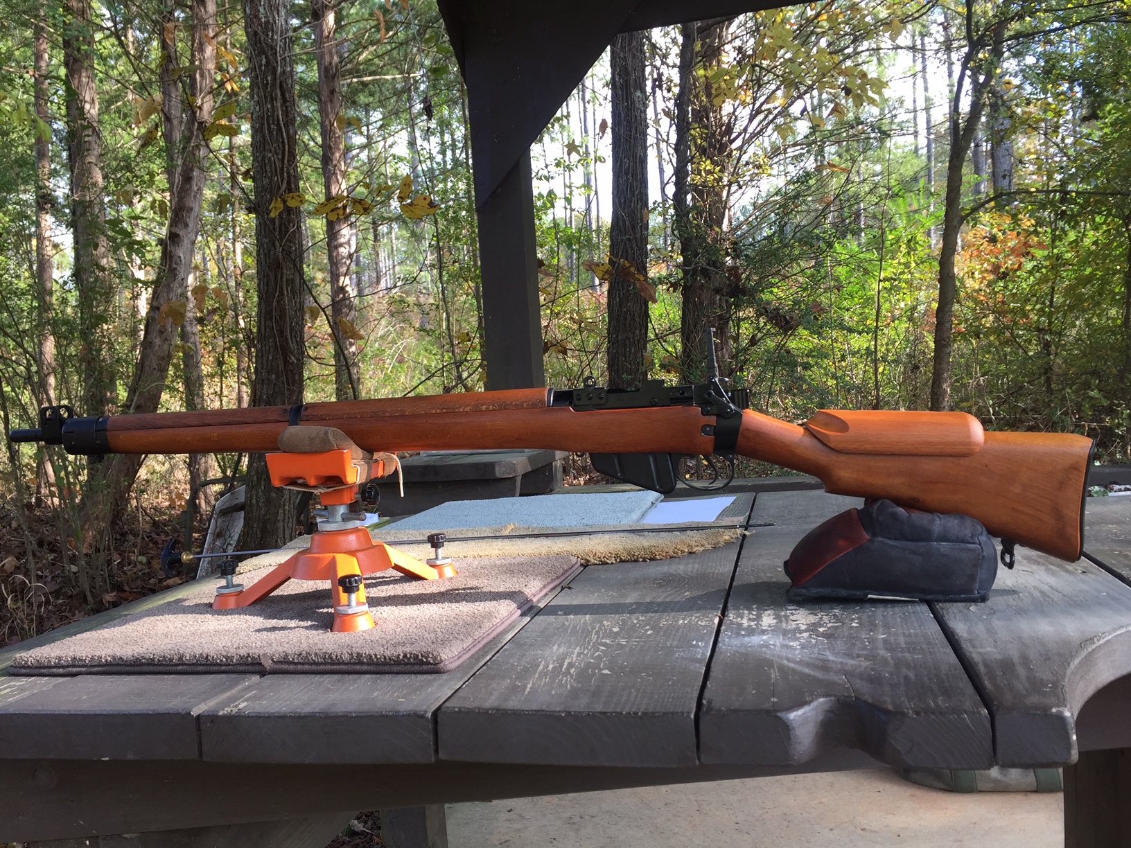

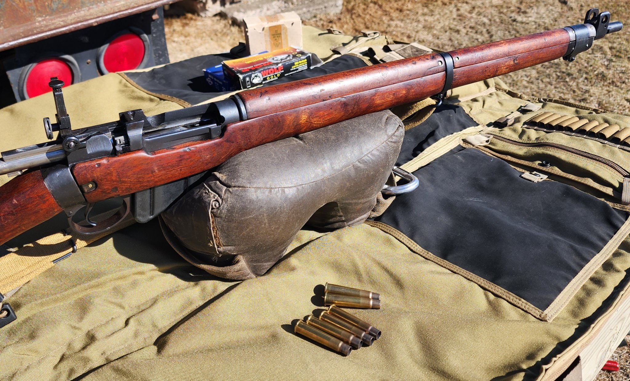

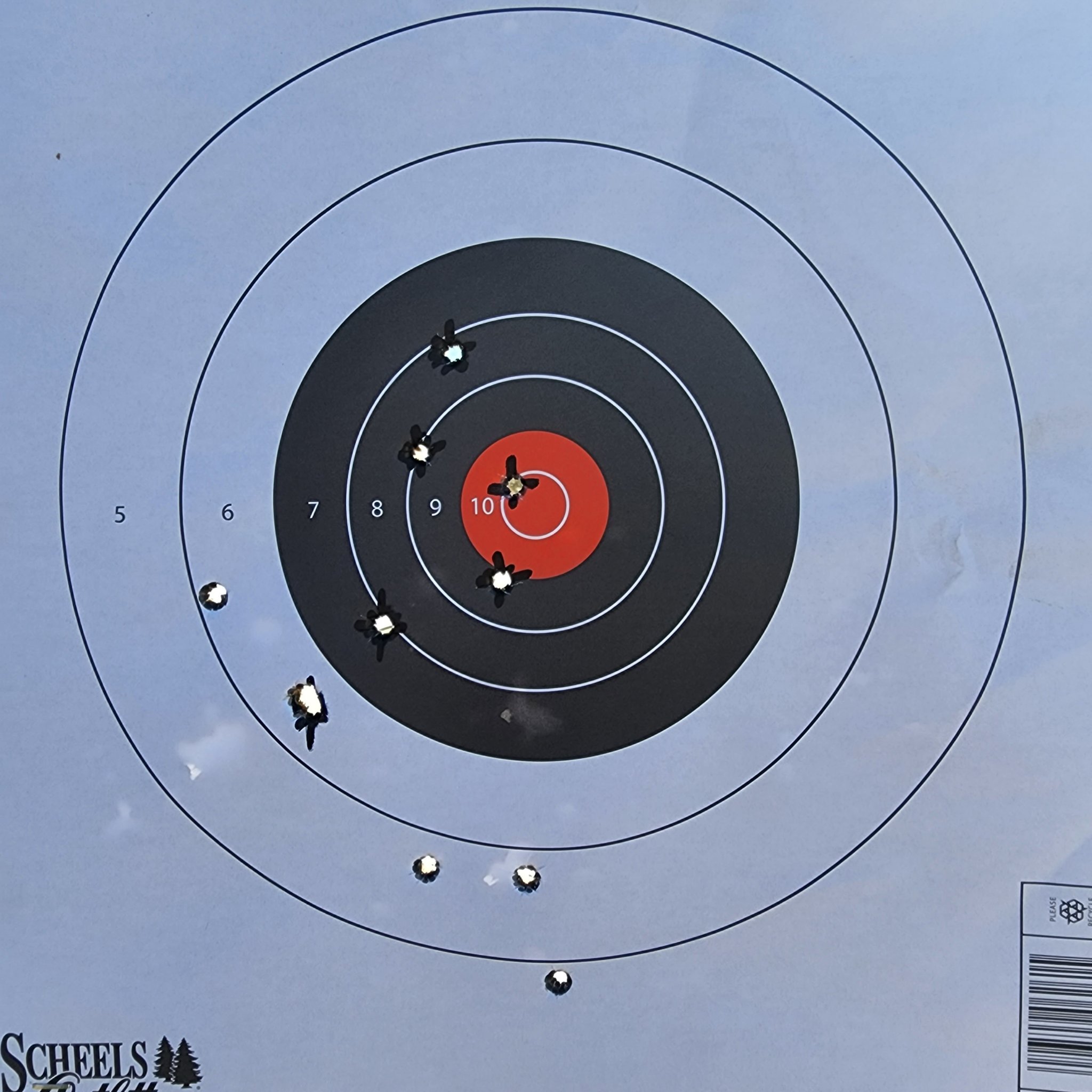

    Accuracy... let me tell ya..
    First 6 rounds of Wolf gold 174. It may tighten up after I get better at shooting the rifle and handloads. Going from Bix/Andy TacPro and Anschutz 5098 triggers to a 6 pound long trigger...
    5 more rounds.
    Lot of up and down stringing. Windage isn't too bad. I'm gonna re read the british manuals on maintenance and accurization. Go through all that and shoot some more.
    I also shot Mk7 that was all hang fires and hitting the primer twice to go off. Accuracy of that is tbd, Hang fires are great training for flinchies though..

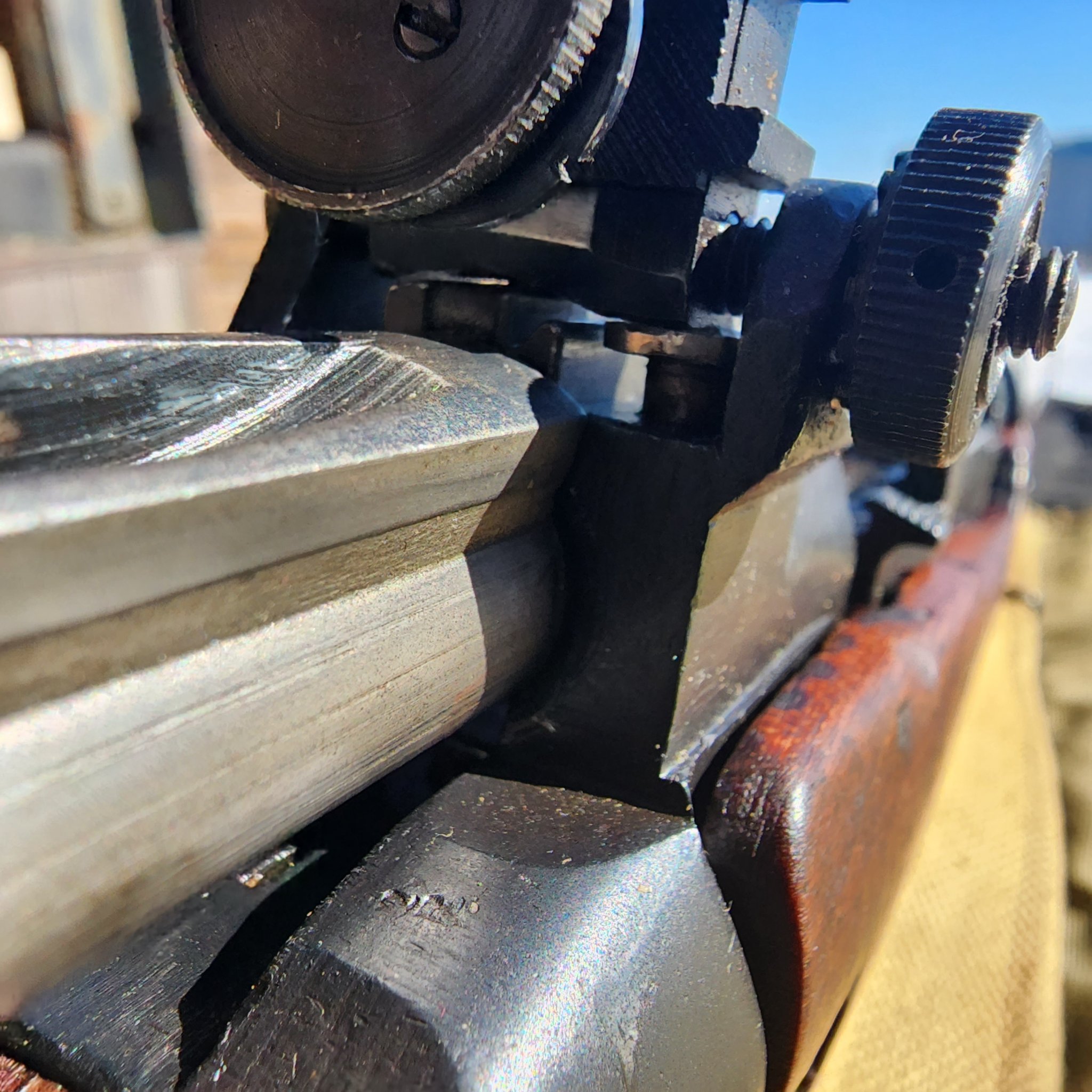

    The area at the base of the rear sight being ground out was an official modification to allow the bolt to be removed with the sight in the up position. It prevented damage to the bolt head.
    However, it has been drilled and taped to allow the screw to be used as a windage screw.
    As mentioned the sight is not normal for the No.4
    If you pin the knurled nut on the right hand side you have some windage, but a much finer thread is normally used and a spring detent on the nut.
    You can either use a hole in the receiver with a ball dentent and spring or a spring on the nut.
    I have seen many done this way.

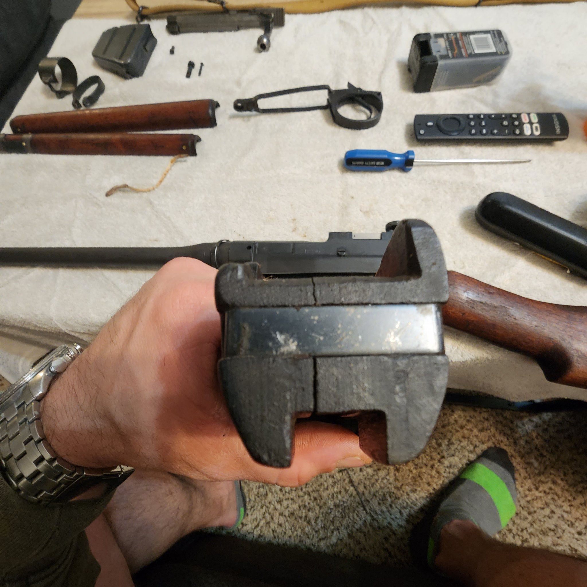

    After inspecting the rifles condition some more. I was wrong about the barrel tension on the front band. It's not correct and there's alittle side play to the left and right.
    I've just got to sit down and read through the Canadian manual I have. I think it's the same as the MOD.

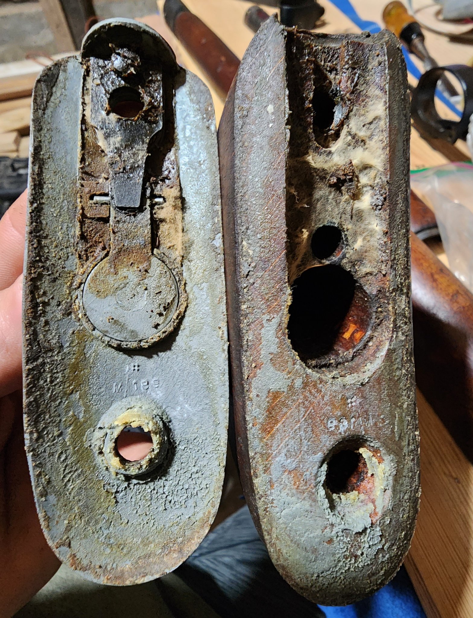

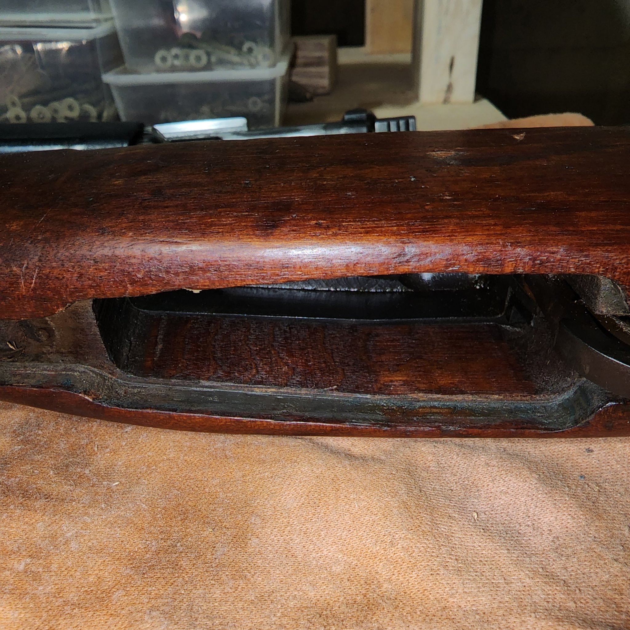

    Inside of the stock is decent. It does have a crack in the center of the "recoil lug" area.

    Thats the crack. Its all the way through.
    That needs to come off so I can clean out the area and Acraglas the crack together. How does the metal band come off? It looks like it was a pin and the ends are kinda smashed to make it non removable?
    Otherwise the stock looks quite serviceable. No washers or spacers, totally unmolested. I've got to learn the correct way to shim the front barrel band. 4-7 lbs of pressure I think is what the book says. So lots of reading to make sure I comprehend the correct way to go about it.
    I really appreciate everyone's insight and comments on this. Thanks a bunch!!

    The magazine is number matching to the rifle. I've loaded it in the gun and shot 10 rounds. The second to last has always jammed into the left side of the receiver. I need to get some stripper clips and I'd like to get a bandolier or two. After looking at the feed lips, they are beat up alittle. I think I'll hold off tweeking them for now.

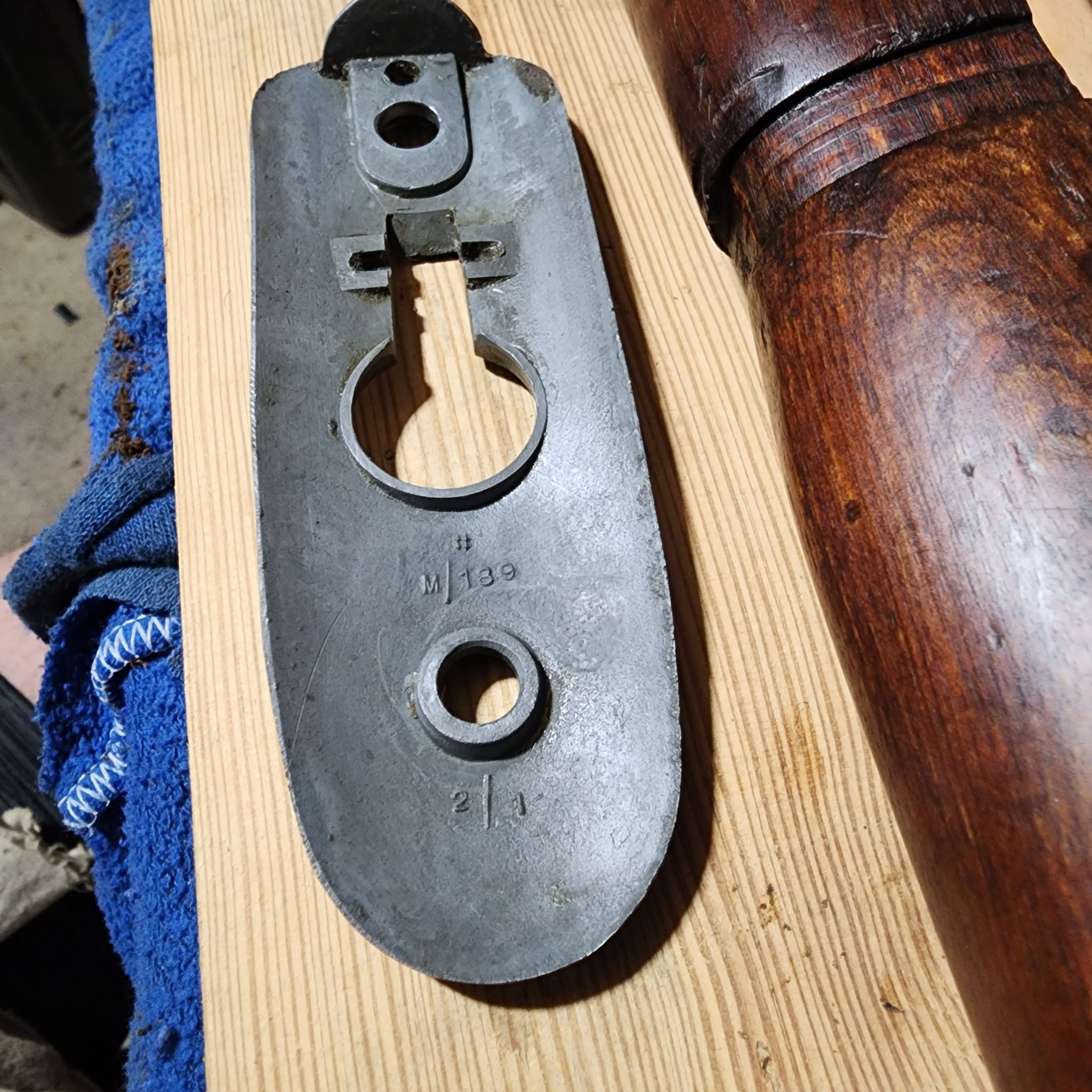

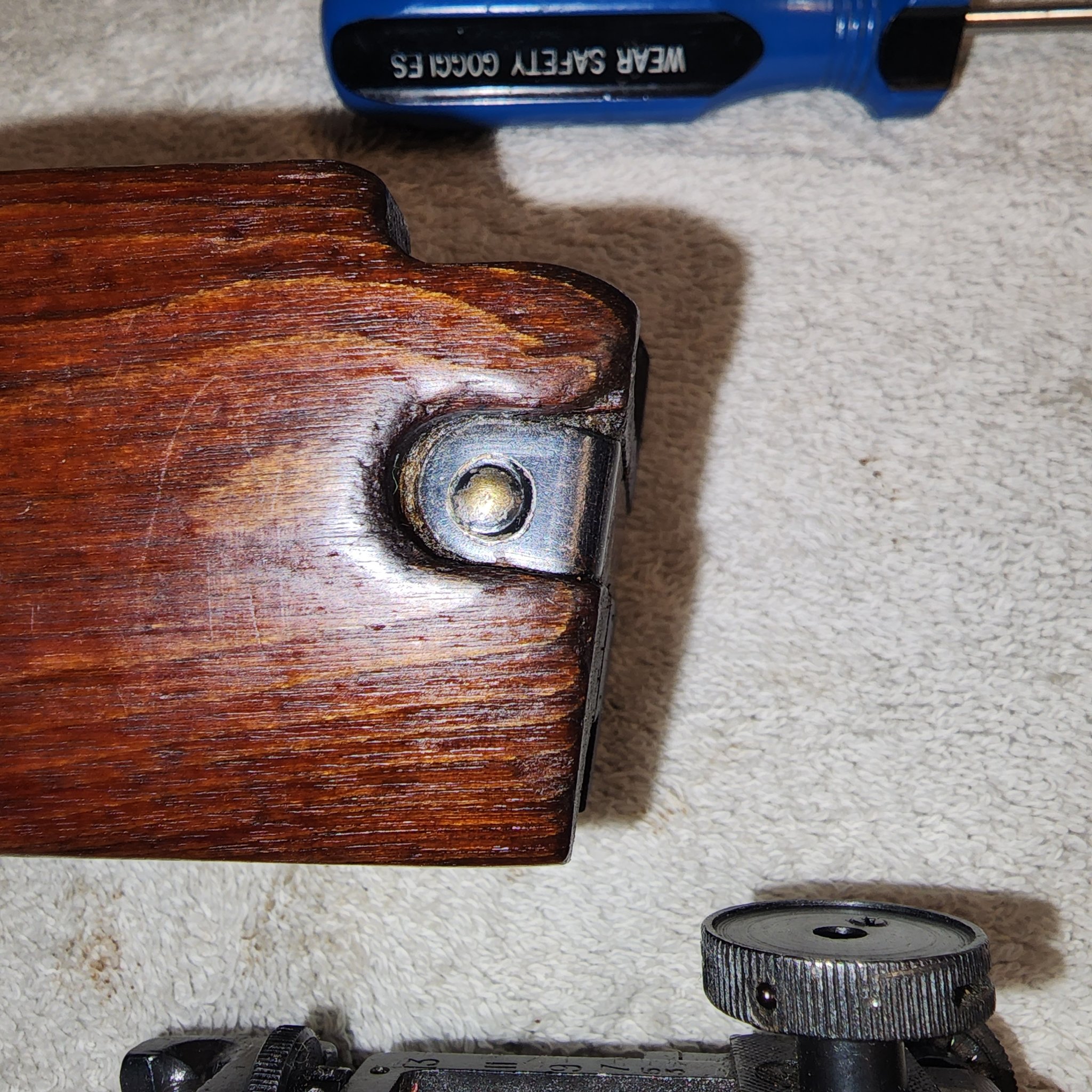

    Hey mate,
    So holding that tie plate at the rear is a rivet, not a pin so it’s not really made to come out but if you do you will need to replace with similar, a long rivet that then gets cut off .
    Regarding the forend pressure, that’s actually achieved at the rear bedding not by shimming at the front . So if the rifle is bedded correctly at the rear it should end up with that pressure at the forend tip. Trouble is sometimes wood moves over time, occasionally all that’s needed to restore it is a good hit of oil, raw linseed oil heated it correct for the No4 . BLO is commonly used also.
    The mag lips are likely a bit dinged up from people using it as a detachable mag, that’s what tends to happen as they aren’t designed to be slapped in and out. Once you get it back working I’m sure it will be fine.
    Regarding the crack again, a good option might be to removed the cracked portion and replace with a new hardwood filler block . (Photo stolen from google)
    Another way small cracks can be repaired also is using threaded brass wire to reinforce the repair .
    A more ghetto way might be Accra-glass and a brass wood screw, don’t drive the screw the whole way in , use an over length screw and cut it off at each end , file the remained flush so it just looks like a brass pin when completed . If that makes sense . Will probably hold up to recoil better than Accra-glass or glue on its own .
