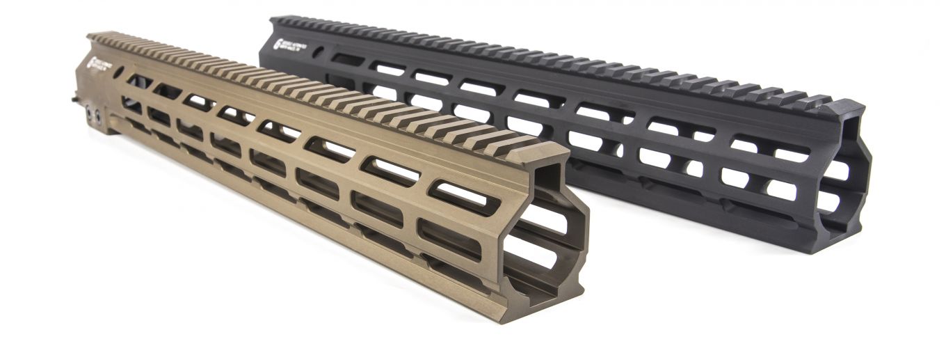

Yep your doomed forever never to rise above mediocrity to fall short of expectations of greatness you know they sell aftermarket rails didn't you ? I jest about the other stuff area 419 makes a great rail so do many other companies all things can be fixed through the marvel of modern science even hair loss bad eye sight or sagging boobs you too can have the boobs of a 19 year old chearleader , tummy tucks and wrinkles no longer will you have to suffer alone crying in a dark corner waiting to be burned as a witch .

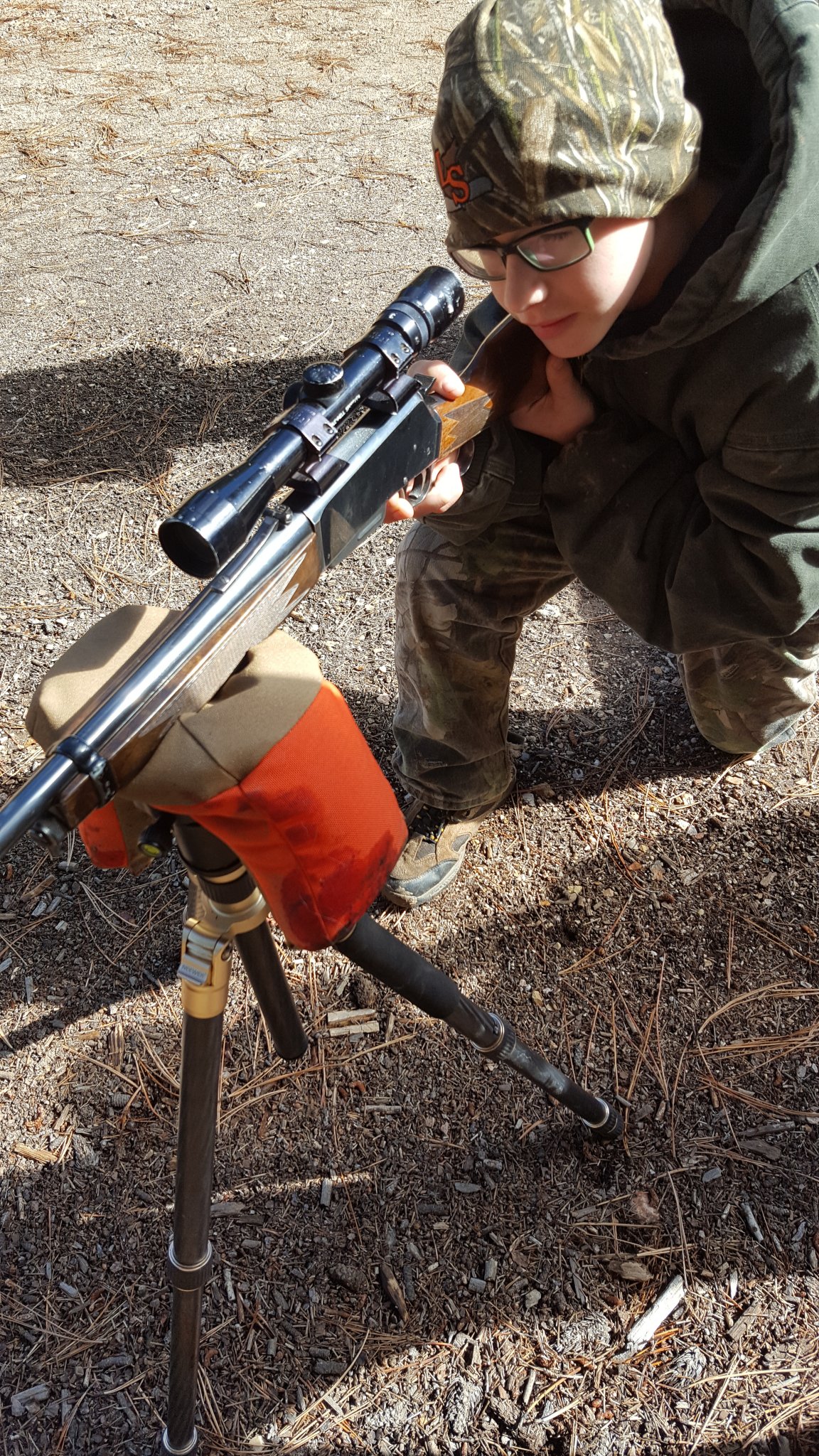

For NRL hunting matches and actual hunting, arca and tripod is all I use, cause carrying a bipod is unnecessary. I can shoot off a tripod or my pack in low prone. In my actual hunting, I have gone right to tripod. I can shoot moa or better out to 900 in seated tripod positions I have learned to build. Not very different than prone.
Bags are great to just flop over the tripod head and shoot. I sell bags that are great off a tripod and give plenty of support and stability, just as much as off any barricade. Its easy enough for kids to shoot.

View attachment 7569293View attachment 7569294
