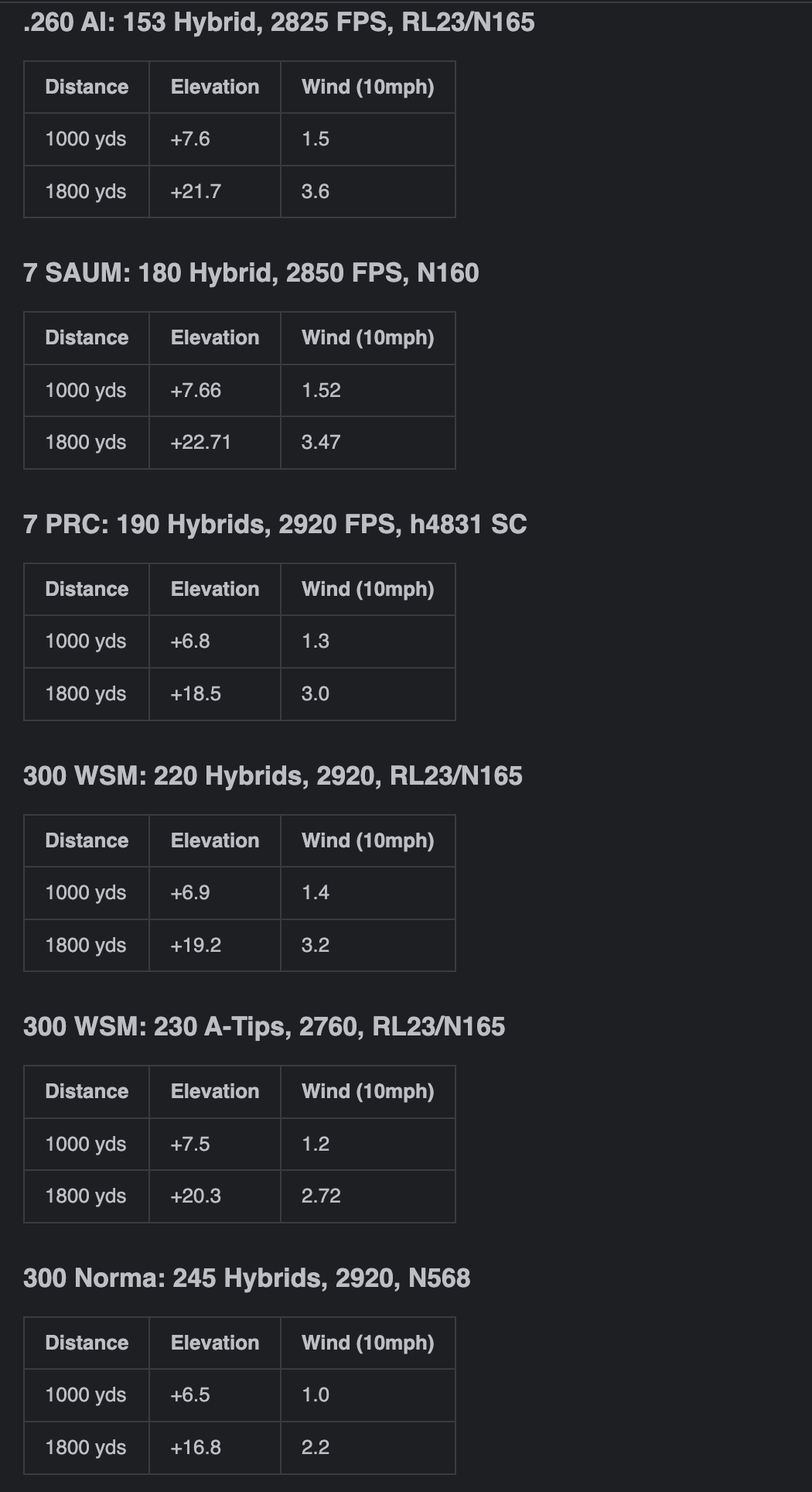

    Looking at building my first long action cartridge for ELR specifically, and have it pretty much narrowed down to 300 WSM and 300 Norma.
    I'm leaning toward the WSM based on the facts that:
    • There's Lapua Brass for $1 cheaper than Norma
    • 65 gr of powder vs Norma's 80ish
    • Abundance of excellent load data from the BR crowd, along with a lot of records having been set at 1k with them
    • I can load lighter 200s with my current stock of h4350 if I want
    • I can be a hipster and do something less mainstream, I guess?
    • I can shoot 220 Hybrids with the same BC as a 230 Hybrid, or if I want more BC, I can step down to the 2800 FPS node, and shoot a 230 A-Tip
    As far as I can tell the biggest arguments against the WSM is that it's not any good as a short action calibur, and isn't using the potential of the long action if you go that way, but... Does it actually lose anything to a 300 WM or PRC shooting 230s?
    I understand that you can push a 245 hybrid from a PRC and Win Mag, but at that point, why bother with either when you can do it more comfortably from a 300 Norma?

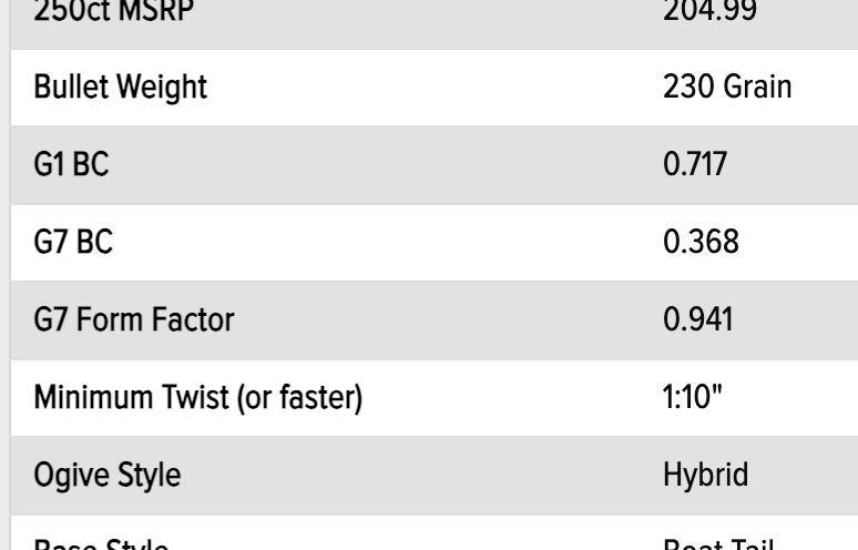

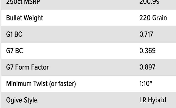

    Berger's BC numbers for the 220 LRHT:​
    Berger 230 Hybrid:
    Berger 230 Hybrid:
