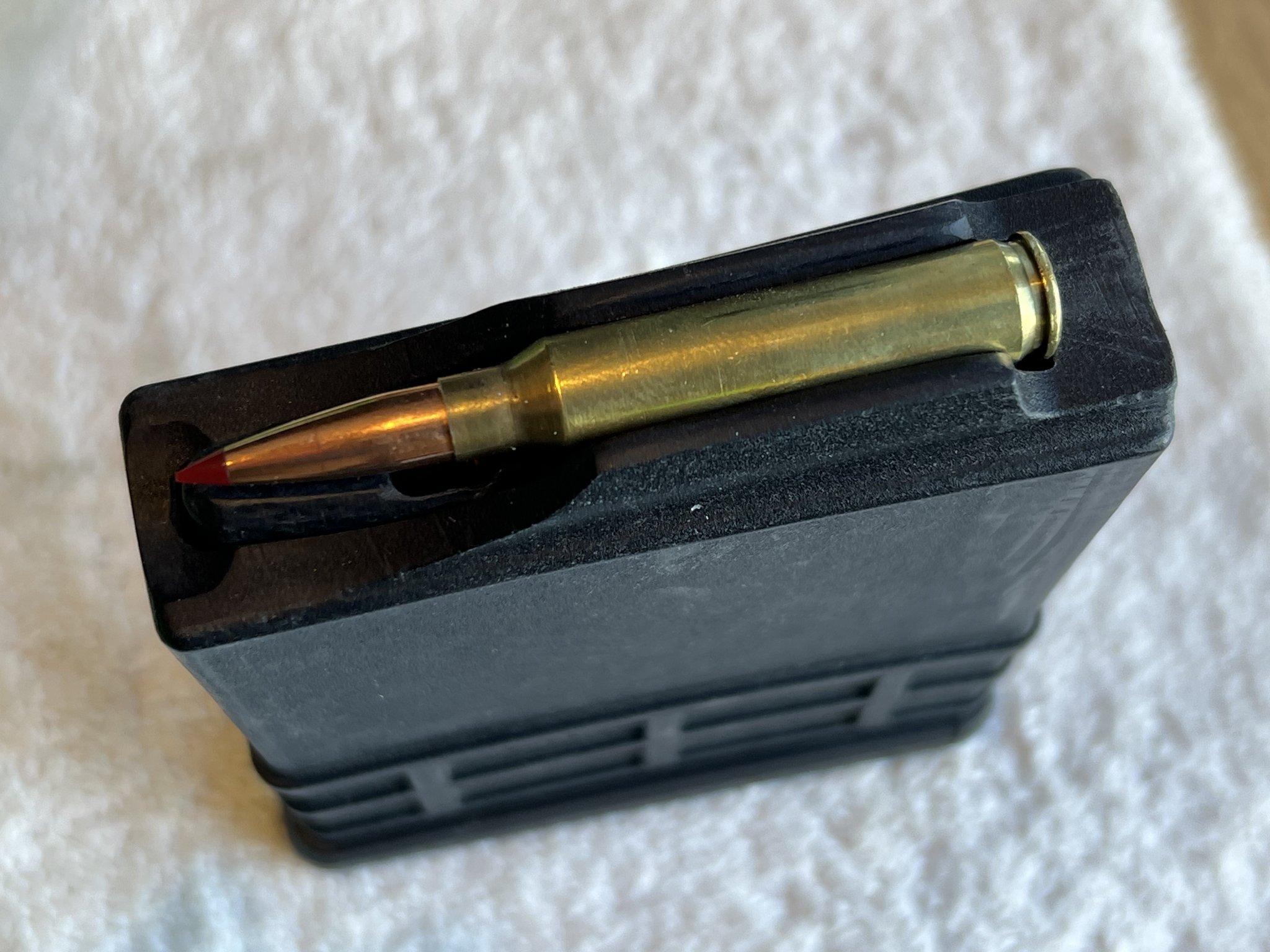

I’m running a 23” barrel, had to chop it a bit as I bought it used and made it into one to fit my switch lug. I’m not pushing the 88’s very fast, found a very accurate node at a little over 2600. I throated the barrel for the longer 75’s and 88’s and load them to an OAL of 2.505. They fit fine in the plastic MDT mags.
