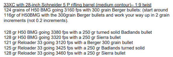

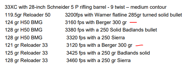

Hi all - David Tubb in his writeup recomends H50 or Vitavouri 20N29 for 33xc. However has anyone tried 33xc with H1000? The burn rate for H1000 is slightly higher than H50 so not sure if it will work as well...but checking if someone has actually tried H1000 for 33xc and what their experience has been. Thanks for the feedback/inputs.

One item to consider is that a LOT of the test loads are using copper solids and the DTAC is a lead core bullet. The bearing surface is going to be much different between the two causing different pressure curves. The XC cartridges are fairly new and typically used by very experienced reloaders - not trying to offend here but experience teaches many lessons. I wouldn't be trying to reinvent with powders that aren't optimal in a case that large without some good data from reliable sources to help me keep my face intact. H50 and US869 have been faily available of late and should offer better burn rates. Pioneering in this arena without the proper background could be hazardous to your health.

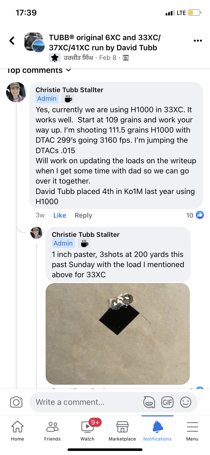

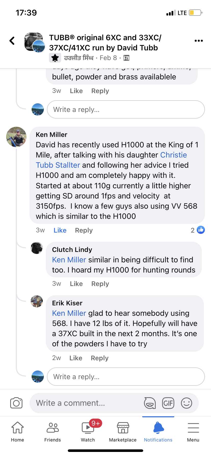

Not saying that the powder might not be the issue in my barrel… but just fyi, there are plenty of shooters using H1000 for 300 grain lead core .338 caliber. That list includes David Tubb, his daughter and some other top shooters.

I would definitely try a slower powder. Unless you are hung up on h1000 and cannot use anything else. I pressured out way too early with my 338lapua with 300gr and 285gr bullets. Not quite apples to apples, but it's pretty fast compared to h50
