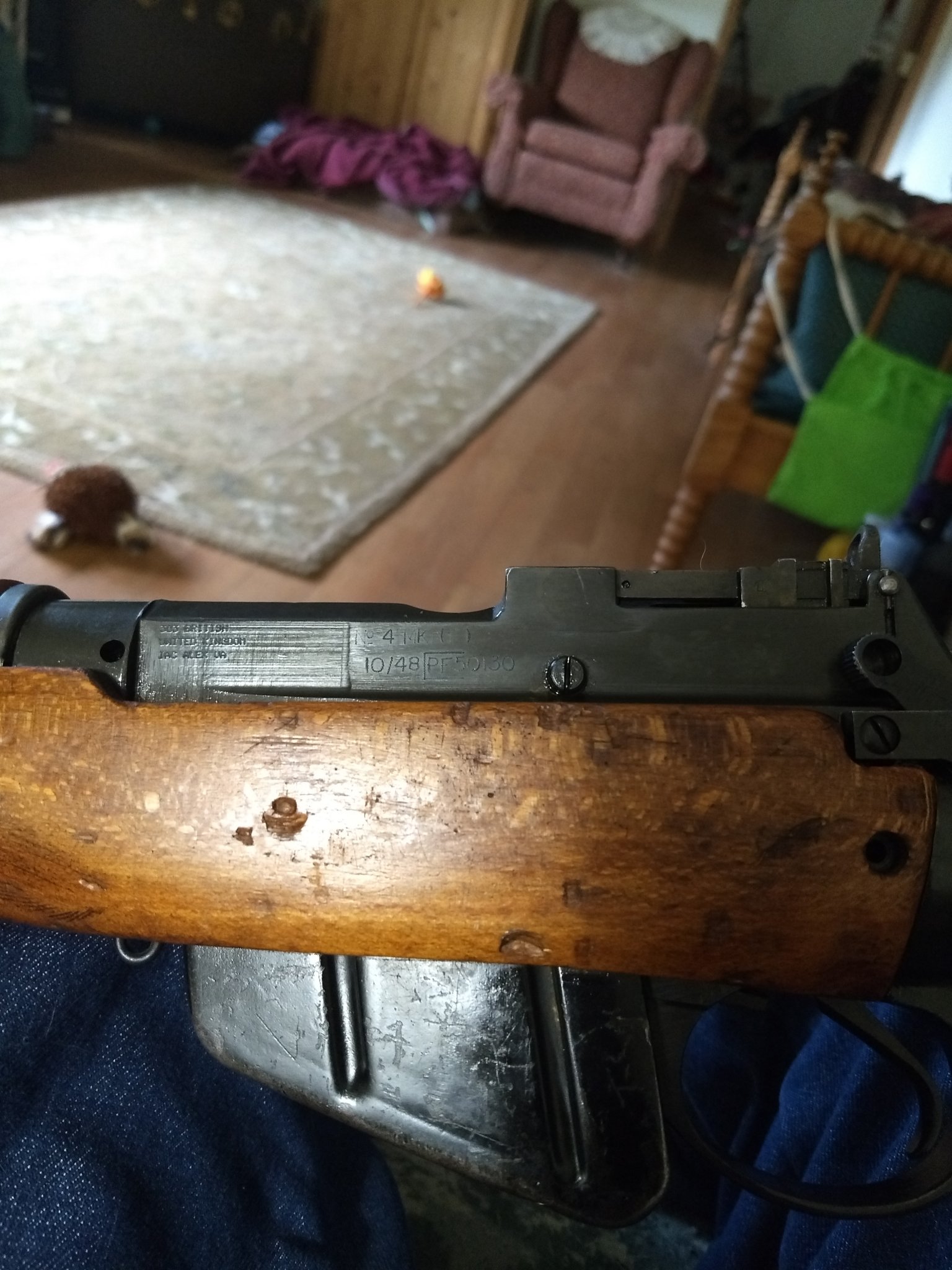

Thank you for setting my spelling straight.thays what I wanted. (F)
