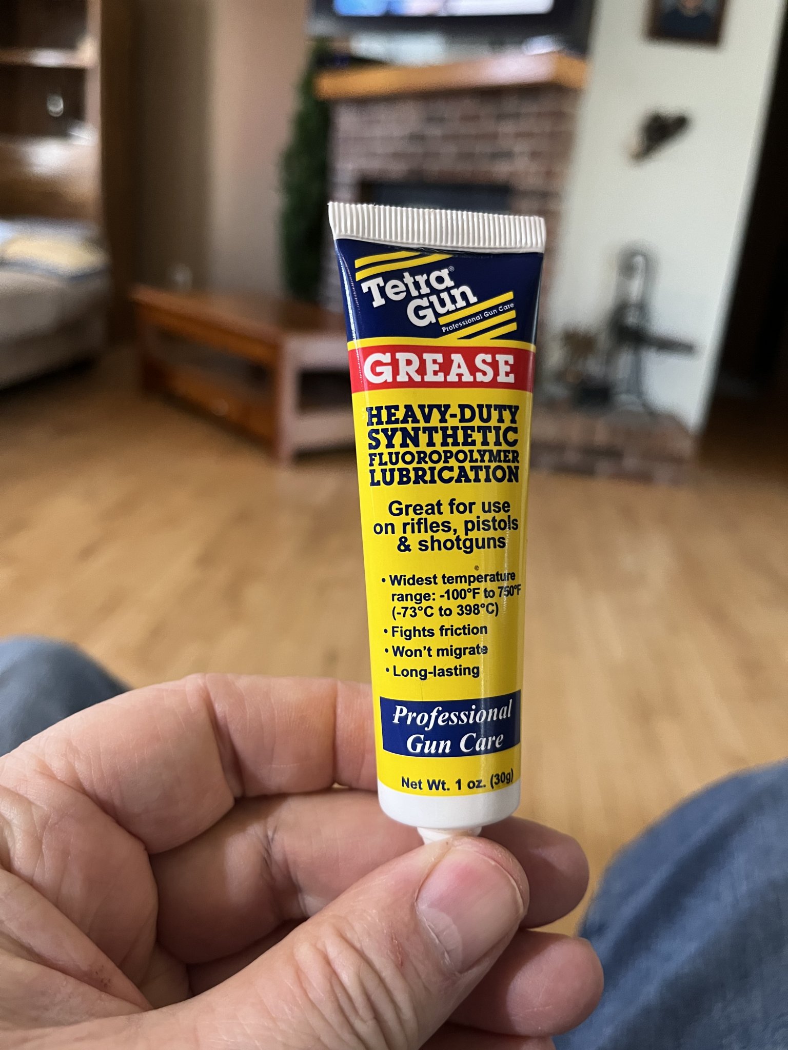

As mentioned, grease helps quite a bit.
If that isn't up to your desired results, a smoother interior buffer tube and a JP polished recoil spring should help even more.
Reactions: x248716x
I found this in my stash. It worked quite well. Not as noisy.
