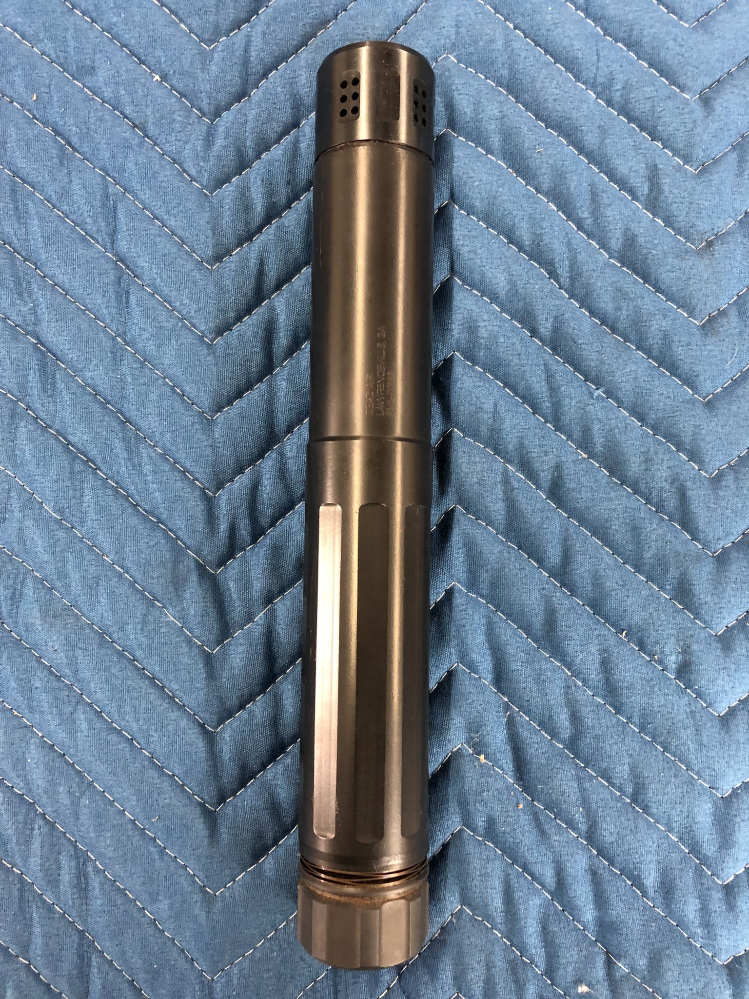

If I were looking at a dedicated can for my 270 bolt action, and chose a Nomad, what pros / cons would the E brake they offer bring?
and thoughts on FRP with and without Ebrake?

As for pros and cons a quick stab would be.
Pros:
Reduced recoil
A few dB quieter
Cons:
Adds an inch or so
Adds ~1.5 oz
I'll probably get one for my Nomad while it's in jail, for the price Hansohn Bros has them, might as well give one a try.
I put the Nomad E-Brake on my Sandman S which is used on my .308 AR-10 and .224 Grendel AR-15. The E-Brake works great regarding felt recoil and muzzle rise. And on the Sandman it helps keep the Cole-Tac cover in place.

About the same...really didn't notice too much diff in sound. Was talking to Mike Pappas about the E-Brake and he says they perform best w/ high pressure, full velocity rounds. Running subs, he said, the E-Brake wouldn't have much effect.
That makes sense. Did Pappas say anything about when the sandman e break would be available?
I didn’t notice any added suppression performance but the e-brake seemed to shorten the recoil pulse. The downside is it kicks up a bit of debris when shooting prone in the desert.
Picked up the Nomad E-Brake for my Sandman S last week. Wasn't expecting anything but I was very surprised to find it really cut down recoil on my 6 Creedmoor. Ran it in competition and found it to be pretty close to running it with a Hellfire brake. I will be running suppressed for the rest of the season for sure.
Yep, the E-Break is a performer. I have talked to Area 419 about making a Hellfire adapter for the Keymo so I can run the Hellfire for recoil reduction, now with the E-Break not sure that I would run un-suppressed with the Hellfire.
Any update on POI shift with and without the E Brake? I hadn't really considered that but it makes sense. I got the Nomad brake for my Sandman because (1) it comes with their front cap tool and (2) and it should keep a suppressor cover from sliding forward. I doubt I use it without a suppressor cover.

Minimal.
Honestly, who cares what the POI shift is, it's going to be different with your setup anyway. Shoot it, note the offset and you're good. I don't care if it's 4 MILS off, as long as I know and can account for the offset it doesn't matter. Also, just never shoot unsuppressed and you have even less to worry about :).
Nomad brake on a Sandman is what I'm running; same reason as you, to keep my mirage cover in place. Love it. Hanson Bros has them for the best price last I checked.
