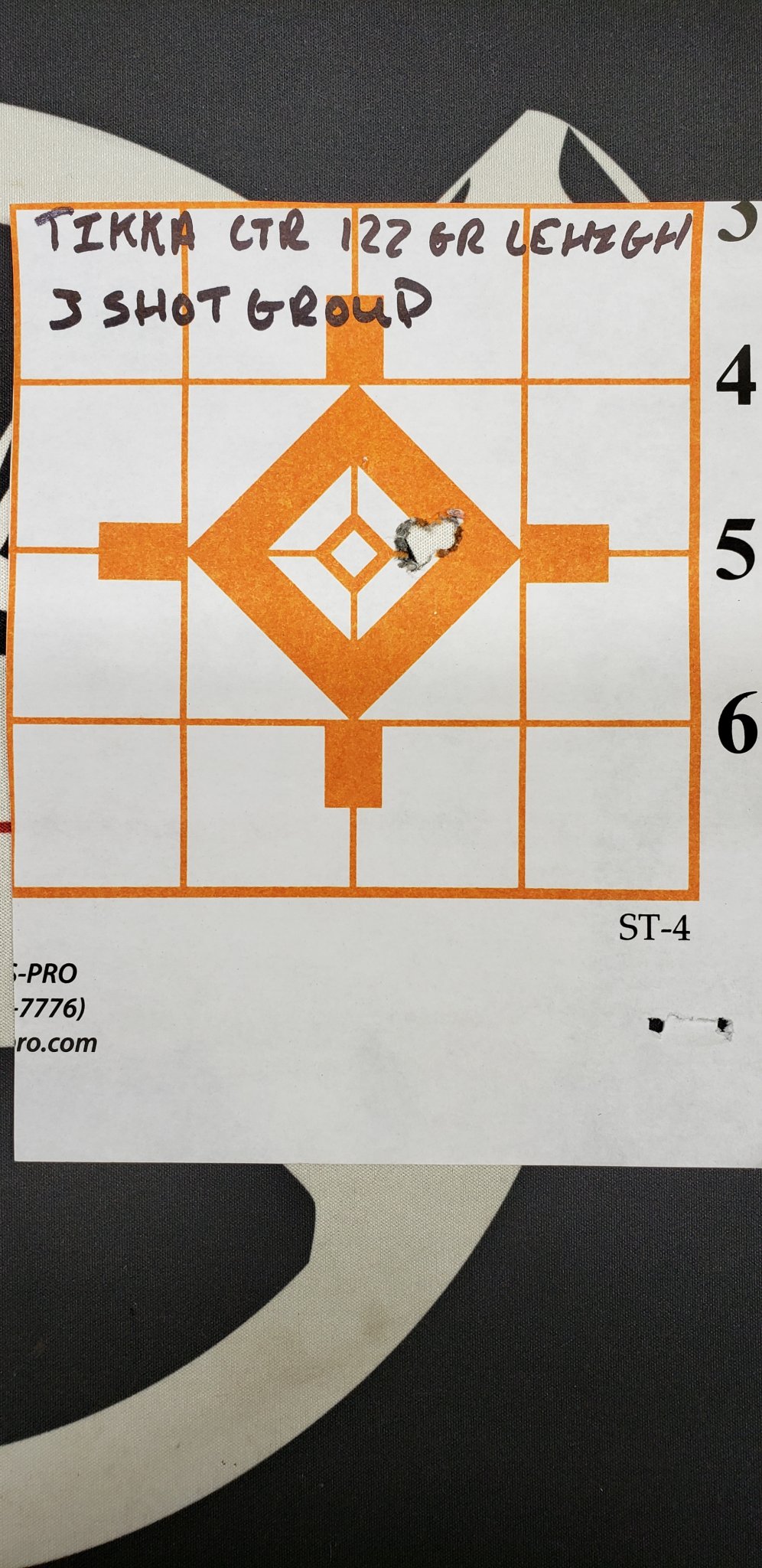

    I've had really good results with the Lehigh copper bullets. I use them in a 6.5 creedmoor and in a 7mm Rem Mag.
    Tikka T3 CTR 24" 6.5 Creedmoor
    Norma brass
    WLR Primers
    44.5 gr of H4350
    122gr Lehigh controlled chaos
    Averaging 2910 fps
    (coal 2.925) (B.T.O. 2.240)
    I dropped a smaller buck last year at 437yds. I put it right in the "crease" and he was DRT.
    Overall I'm happy with the bullet. The only drawback I see is they don't buck the wind as well as an ELD-X/ELD-M. But they are consistent, as long as I adhere to my dope for wind they hit where they are supposed to.
