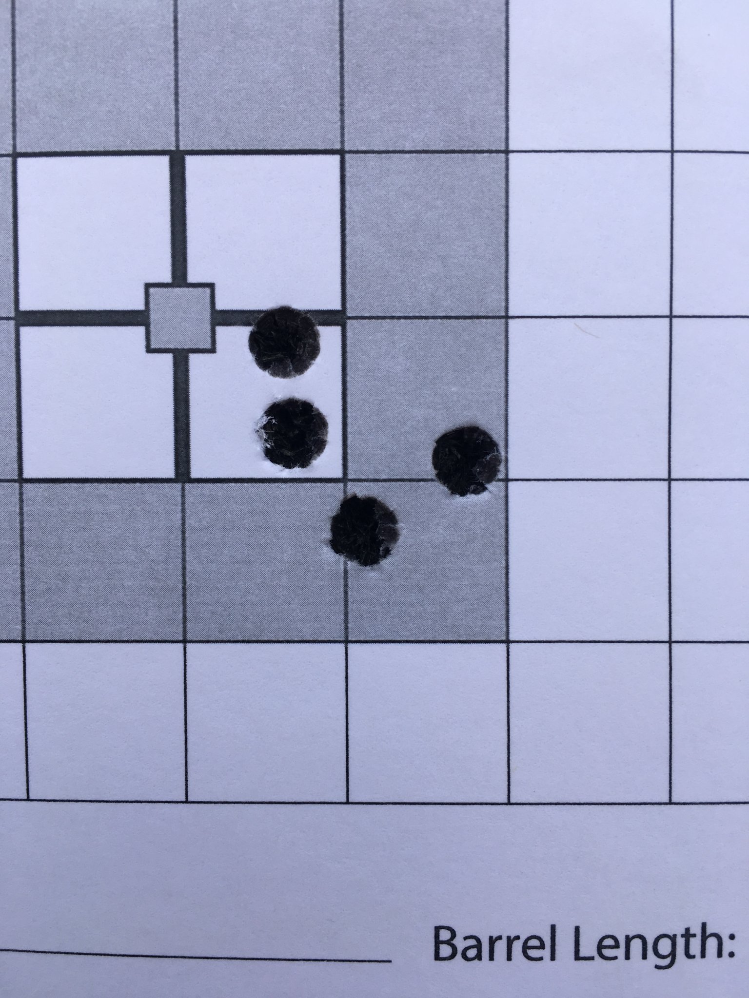

70 RDF@ 2900ish fps @ 200 from RPR
I’ll have to find pictures of gas gun groups w/77s.
