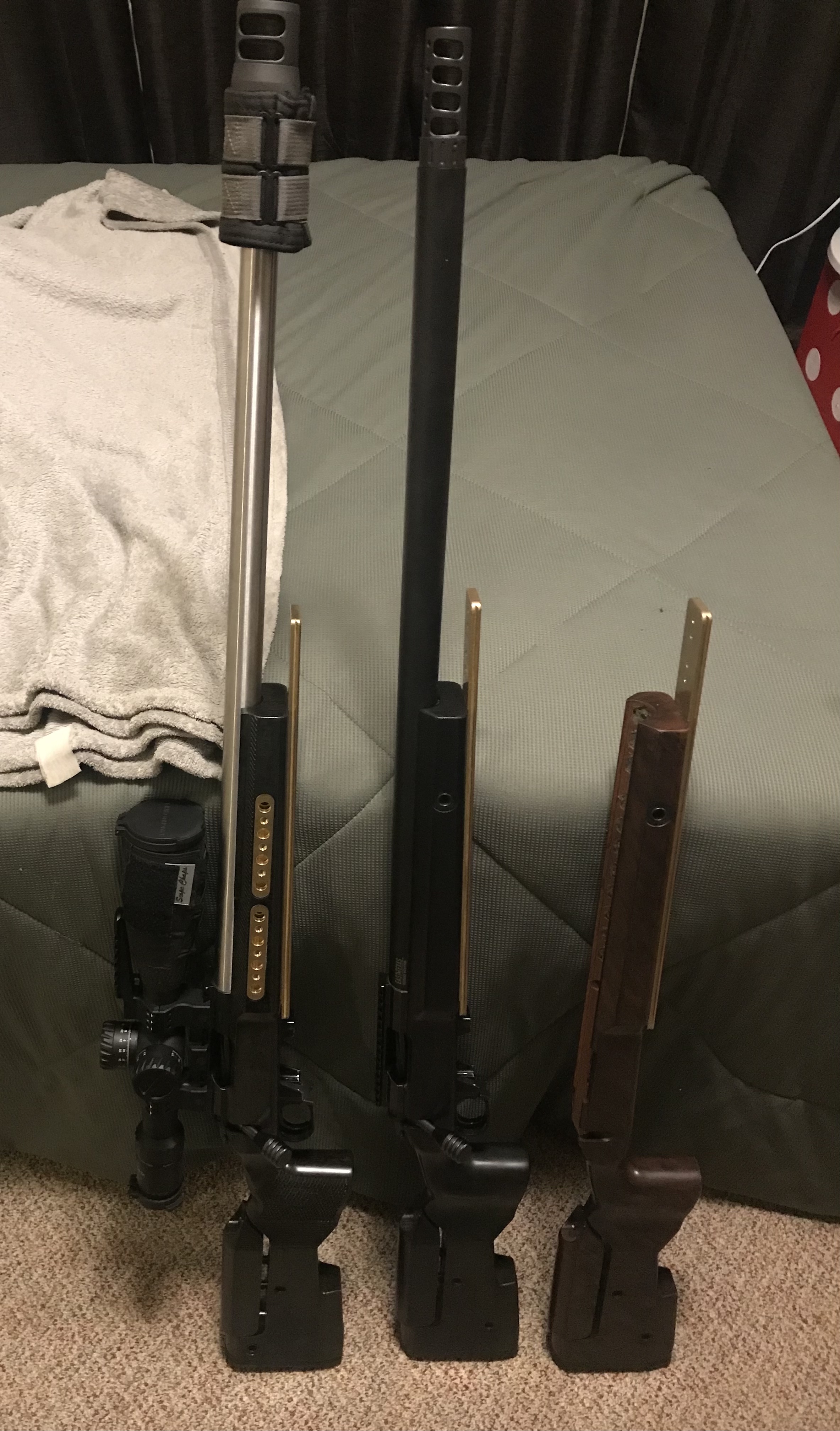

    I personnaly run 1.25" straight barrels at 26" on my Centurions and haven the balance point right about 4.5" in front of Magwell with the help of the brass weights. Next rebarrel I am leaning towards 28" tubes and worst case I can take a few brass weights out of the fore-end if needed. With my setup I was not able to get the balance far enough forward with something like a proof comp contour.
