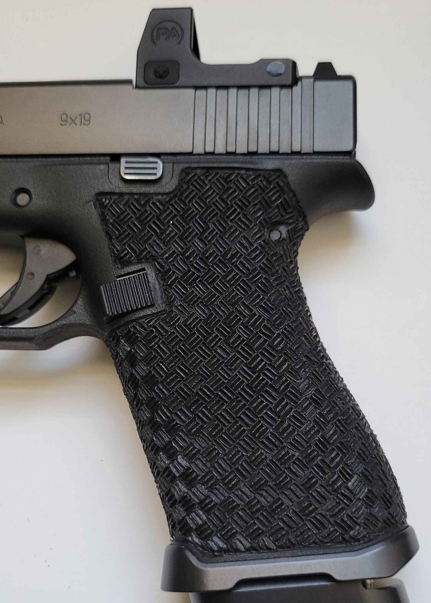

In my opinion, stippling would be the best choice by far.
I have no idea where you live, but everywhere in the U.S. likely now has a dozen people in every city offering that service at very reasonable prices.
There are a ton of "non-slip" die cut grip tape kits for every Glock model.
Example: https://www.amazon.com/Handleitgrip...-1-spons&sp_csd=d2lkZ2V0TmFtZT1zcF9hdGY&psc=1
The grip tape is effective even with sweaty slimy hands but it also grabs and bunches up any clothes material you might be trying to conceal under. Makes for 100% dead giveaway that you are carrying. Also almost guarantees you will trip on your dick and grab way more shirt than gun if trying to draw quickly or discretely.
Stippling provides >90% of the usable grip as grip tape but is not so sticky to clothing.

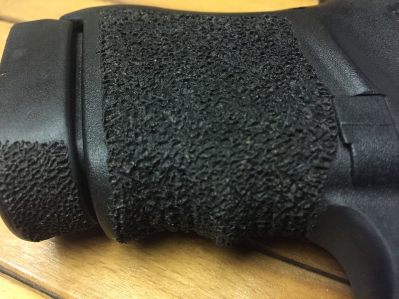

Or you can do it yourself. I did.
I'm too much of a pussy.
I wouldn't stop trying to get it "just right" until it was a melted blob. My shit would look like a Hi-Point and a Chiappa made a baby.
You are correct though. The OP could likely get a soldering iron and fire up the YouTube DIY tutorials.
I practiced stippling on cheap P80 frames. It's not too hard to master. You just have to take your time. I have no love for Talon.

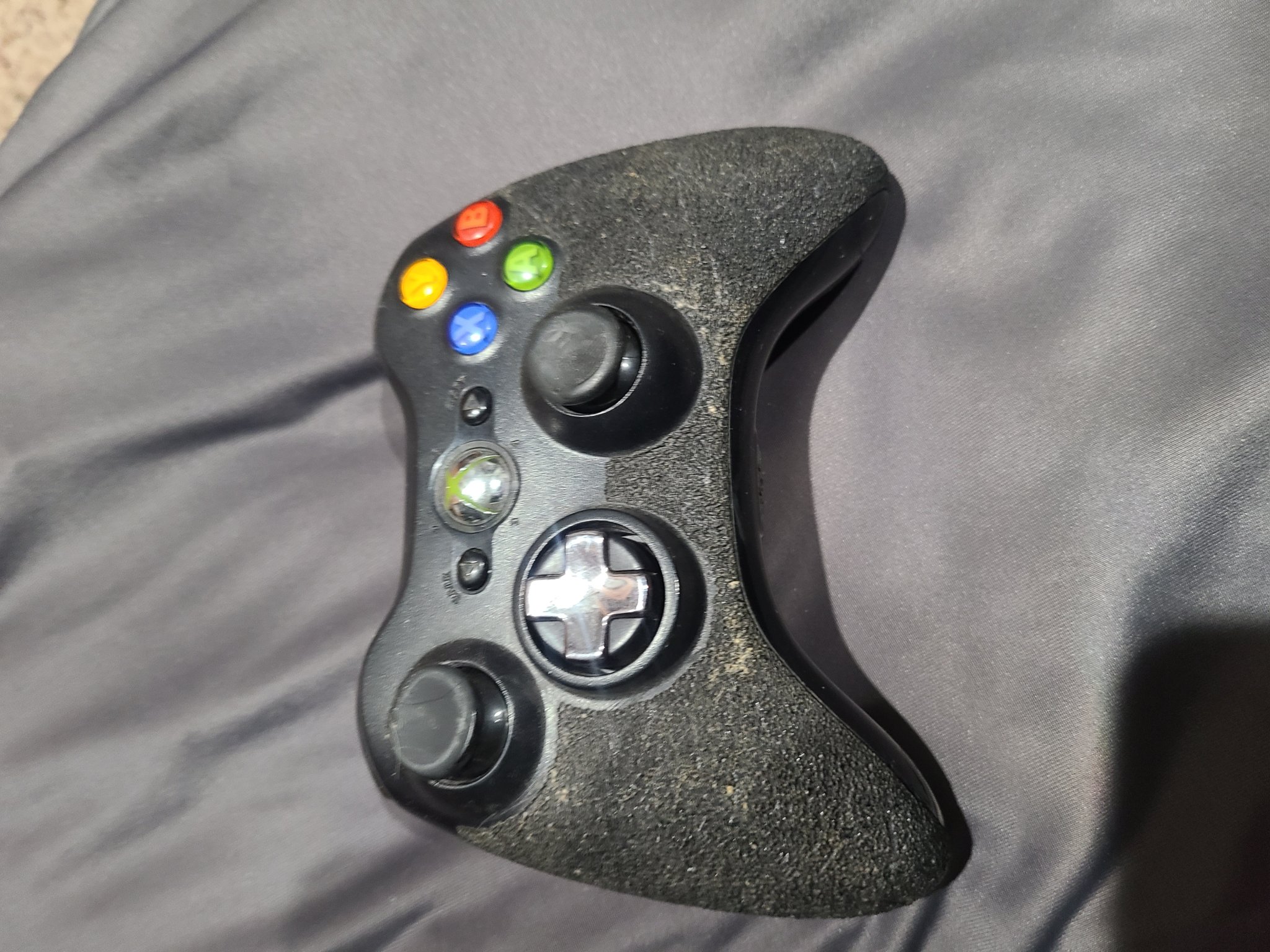

I practiced on some Pmags and a couple old A2 grips.
Dremel and mini sanding drum for taking down finger bumps works dandy.

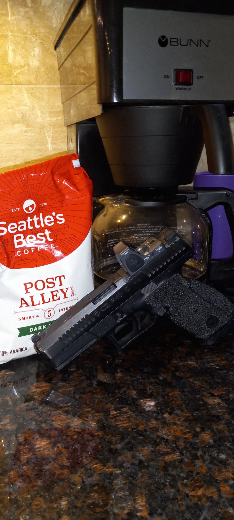

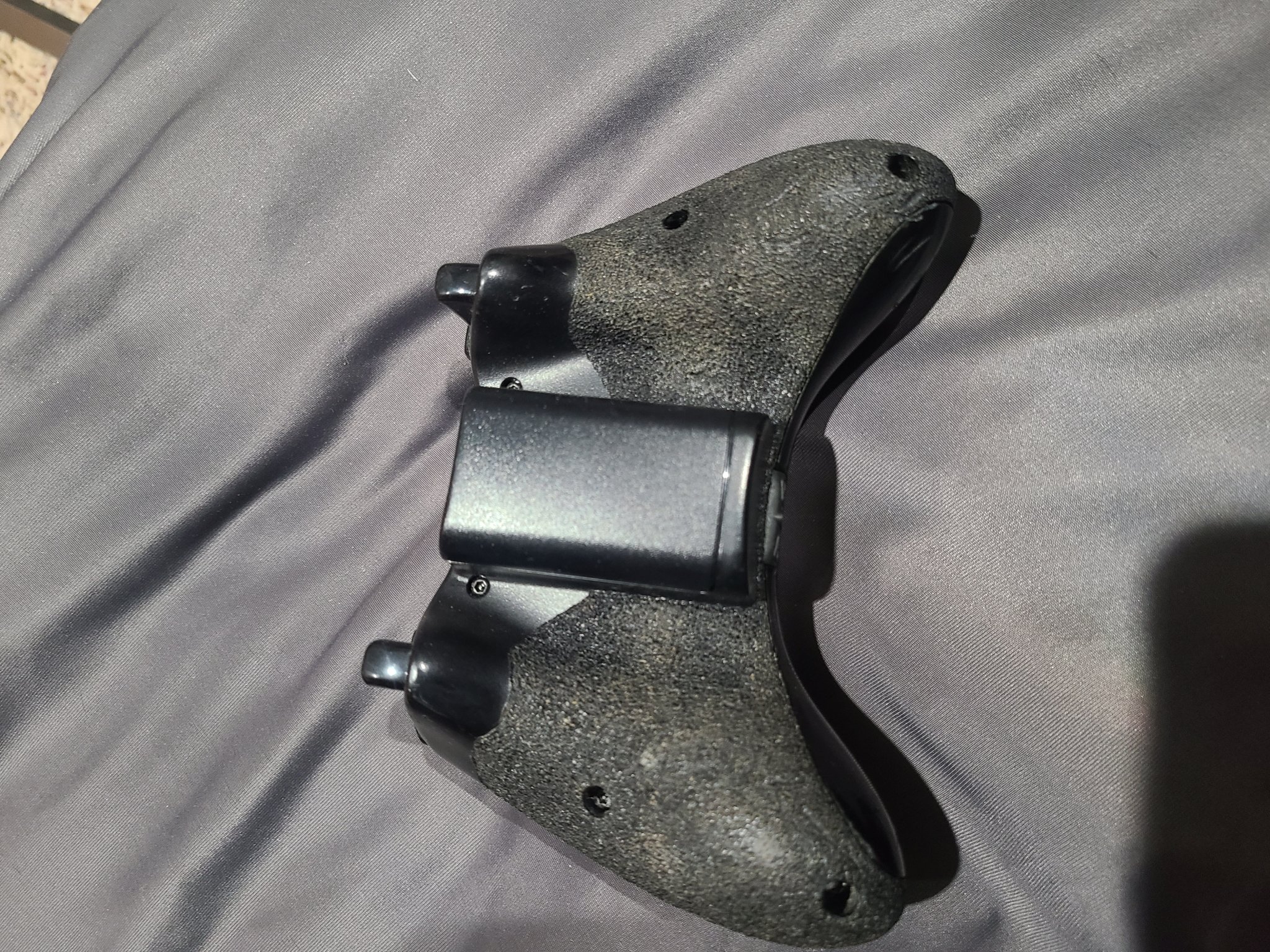

Stippling isn't that hard... I have next to no patience, and this was my first time stippling anything and it came out ok:
The polymer melts, and then it hardens, as long as you're after function over fashion and don't hold the iron on it until it's smoking like a dumbass, you can take a few or more whacks at it until it's to your liking (some might even prefer the look).
Practice on that useless mag-loader thingy Glocks ship with, or even on the gun box it came with that will spend the rest of its days in some closet...

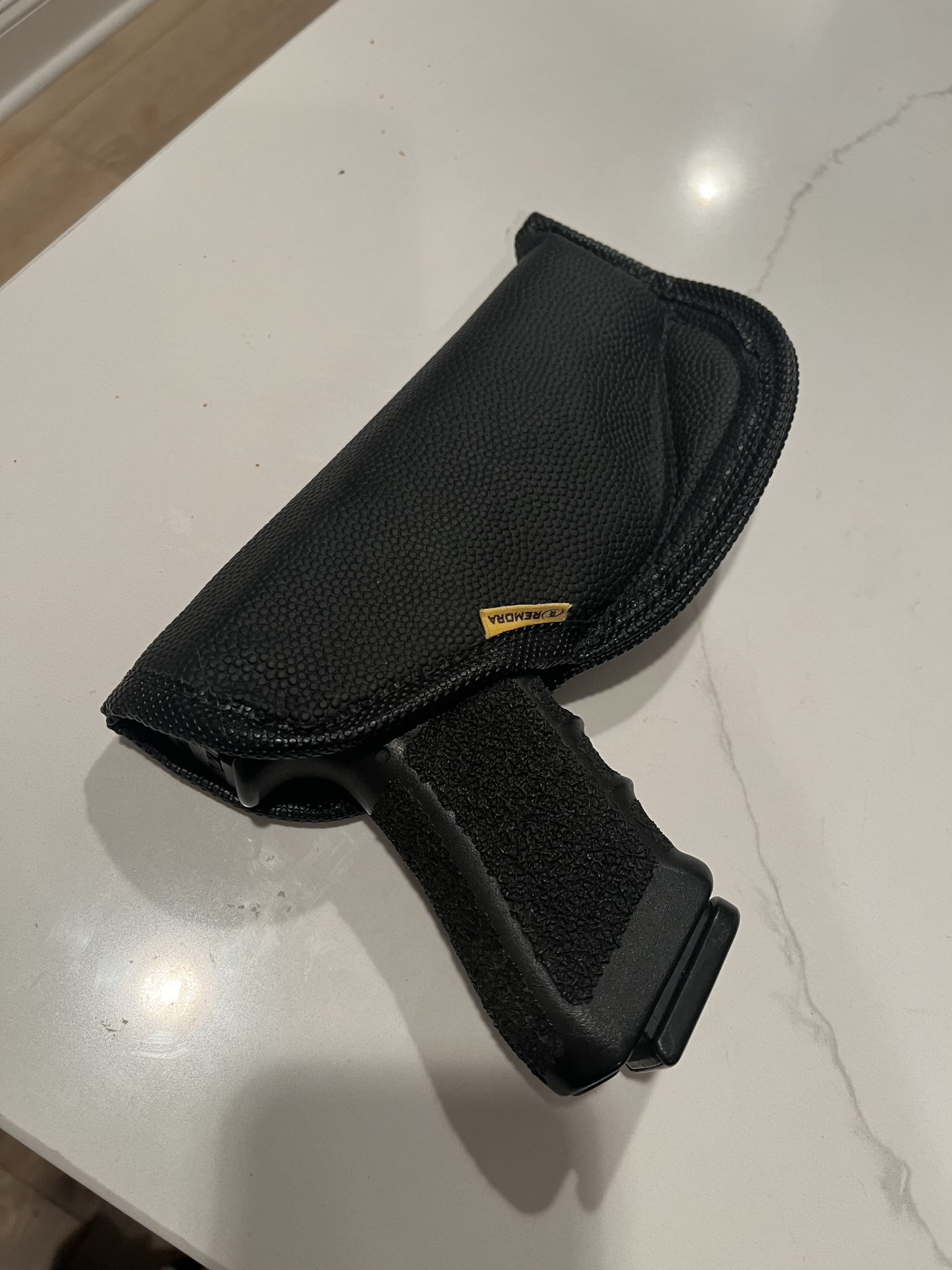

I use the aggressive sandpaper stick on.
But I only do it on the front strap and backstrap, carries great, doesn't get caught on clothing or anything this way.
And I do it up the beavertail a ways as well, really does a good job of keeping my hand high on the gun instead of allowing it to slide down.
I also do it in multiple layers in some spots, you can do quite a bit to get the feel you really want and to aid in keeping digits where you want them.
