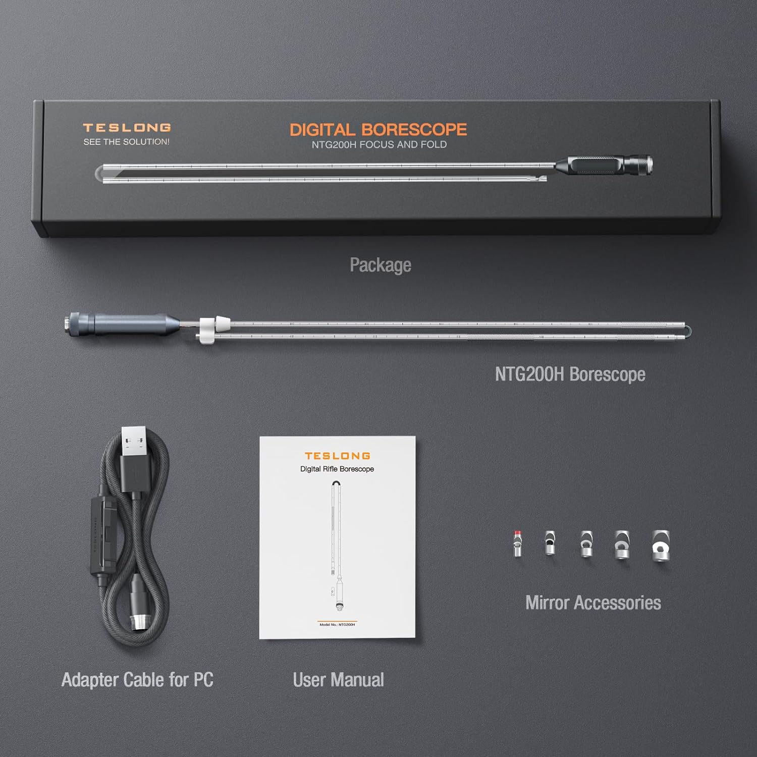

    So I have a Hawkeye borescope but lost my ability to capture images when my digital camera died years ago. Ever since I've been looking but hadn't found what I wanted. Recently Teslong came out with their NTG200H with either a 4.5" or 5" display. Only thing for me is I didn't what to have another device that had a battery that you had to make sure was charged before using the borescope. I also didn't want to spend the $150's plus. I checked out Teslong's web site but couldn't find anything that fix for me.
    While shopping around I found Teslong had an Amazon store and decided to check it out and glad I did. This is what I found:
    And, it was right at $100. Simply put, it's a USB only version that will work on Android, Windows and Mac's. This is the manual focusing and foldable 26" rigid with 5 mirrors. The great thing is I saved money on a display I don't need since my phone is Android and I have an Android tablet and Windows laptop.
    If this interests you I provided a link to it above the picture.
    UPDATE: FYI the white clip that holds the end of the shaft does not unclip from the shaft, you have to slid it off the end to free the shaft. Don't know why they made it like a clip because the plastic is to hard to release trying to unclip but slides easily off the end.

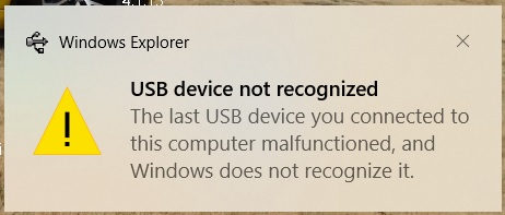

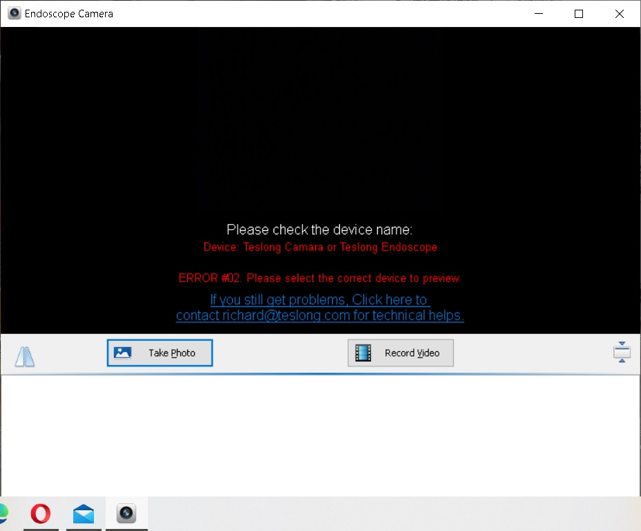

    On the other hand, I was not able to get it working on my Windows 10 laptop. When plugged into the USB port it comes back as unrecognized device so no way to select it in the Camera program. FYI, it has all the latest drivers and updates from Dell and Microsoft. I emailed support at Teslong and waiting to hear back.
    So here are the error messages I'm getting:
    Now support believes it is a bad cable. The strange thing is you have to remove the USB C adapter to plug in the cable via USB into the computer and that doesn't work but with the USB C adapter attached and plugged into my Android phone it does work.
    Their resolve is for me to send it back to Amazon as damaged.
