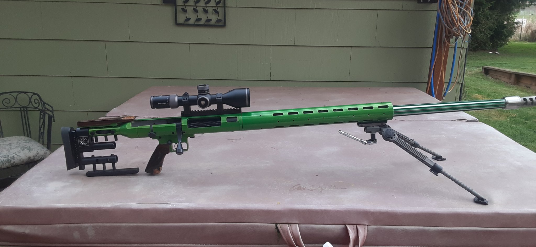

No the 10x is larger 1.600 in diamiter where the 700 footprints are 1.350 you will need to get a chassis or stock for the 10x here are just a few that handle the 10x. Competition mechine ( gary elieso) accurate rifle systems( joe updike), Terry Dines chassis to name a few. My prefrence is the competition mechine
