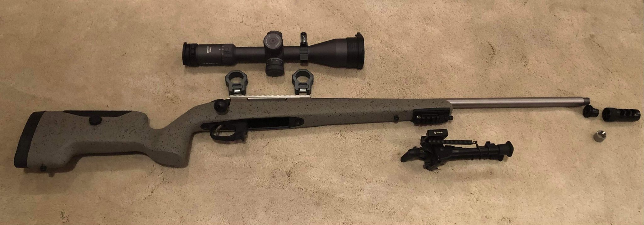

Hi guys
Just unboxed my Tikka UPR today, this is my first precision bolt gun, mostly have been shooting semi autos before. Gonna set it up and go zero it tomorrow, so exited!
I am gonna run several wet patch through the bore to make sure there is no unwanted surprise in there before first shot, after reading the manual I’ve got some questions, would you help me ?
1. Should I clean the bore after the range trip? Manual suggests running 10-15 solvent patches down the bore after firing or else corrosion may occur within 24hr on a rifle left uncleaned. This would clear most carbon fouling out I believe, is this really necessary? What is the better way to keep the fouling and preserve the bore in the same time?
2. Where should I lube the rifle? I ran semi autos wet, like really wet, should I do the same on precision bolt guns?
Thank you
Francis

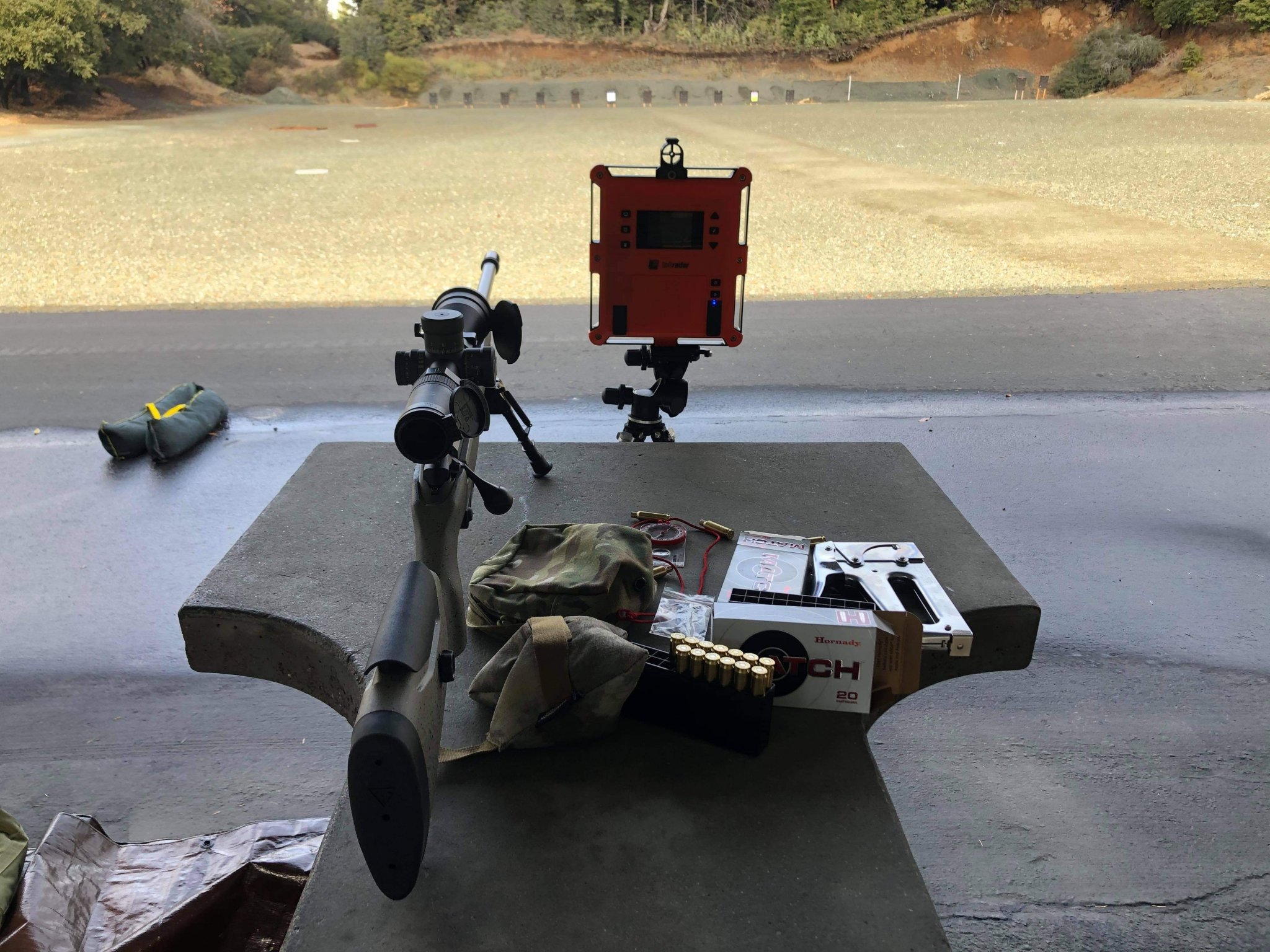

Thanks for the advices guys!
I’ve been hearing good things about Tikka, but today is just ridiculous, took me two rounds to walk on the target paper than zeroed at 100y with another 8rnds. Zero stayed, groups are consistently within 0.5MOA when I do my part. 2 botched groups with bad fundamentals like thumb pinching and improper loading are 0.86 and 1.13. I’happy with what Mk12 has been giving me with 77grainers but this is a whole new level!
