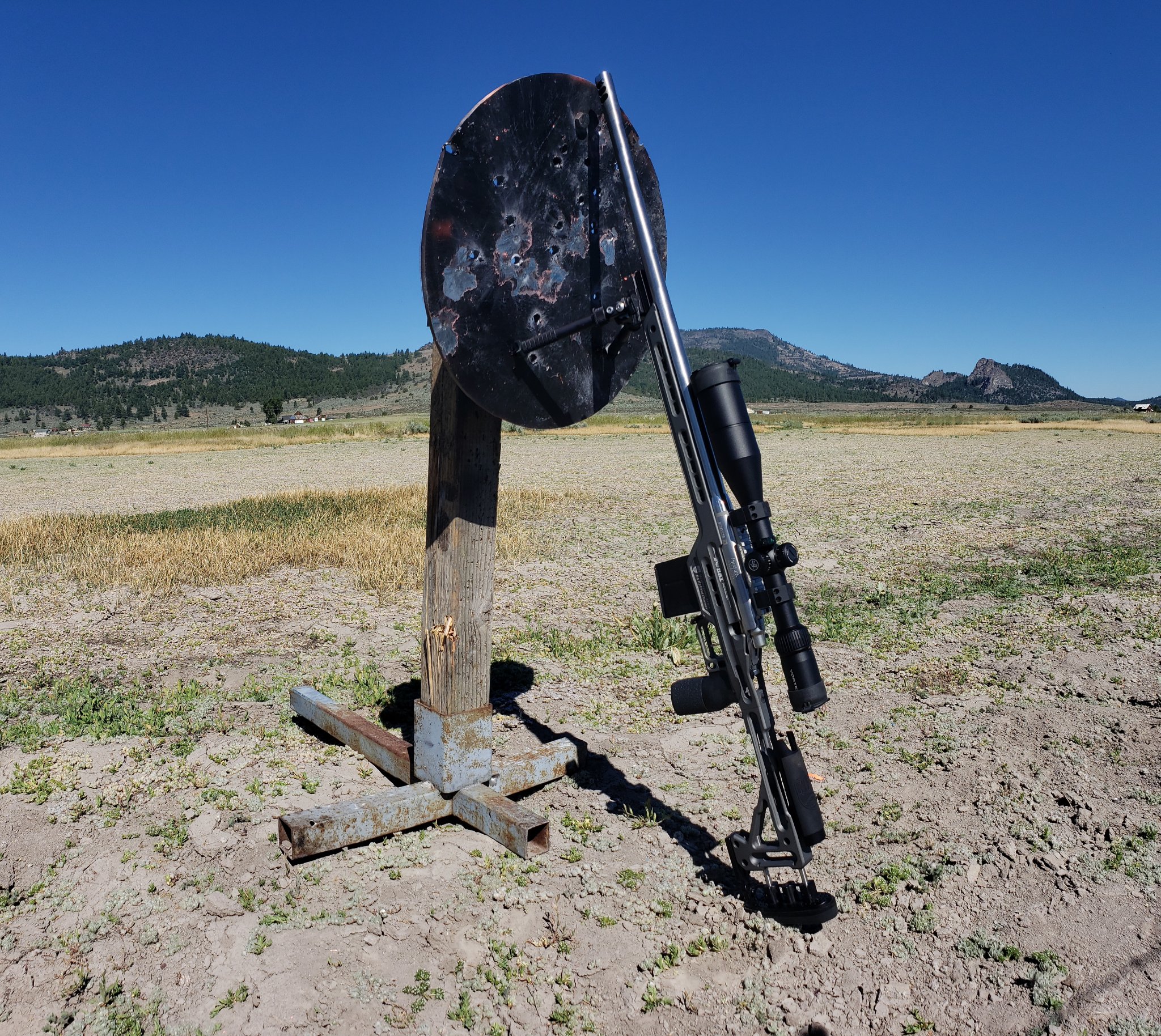

While on vacation at a ranch I set up a 20" steel plate that I could shoot at a max of 800yrds. I could not hit it for the life of me at 800 using the hornady calculator. I finally drove closer to 400 then backed up to 600 and then was finally able to hit at 800. Once I had the right dope I was able to hit every time.

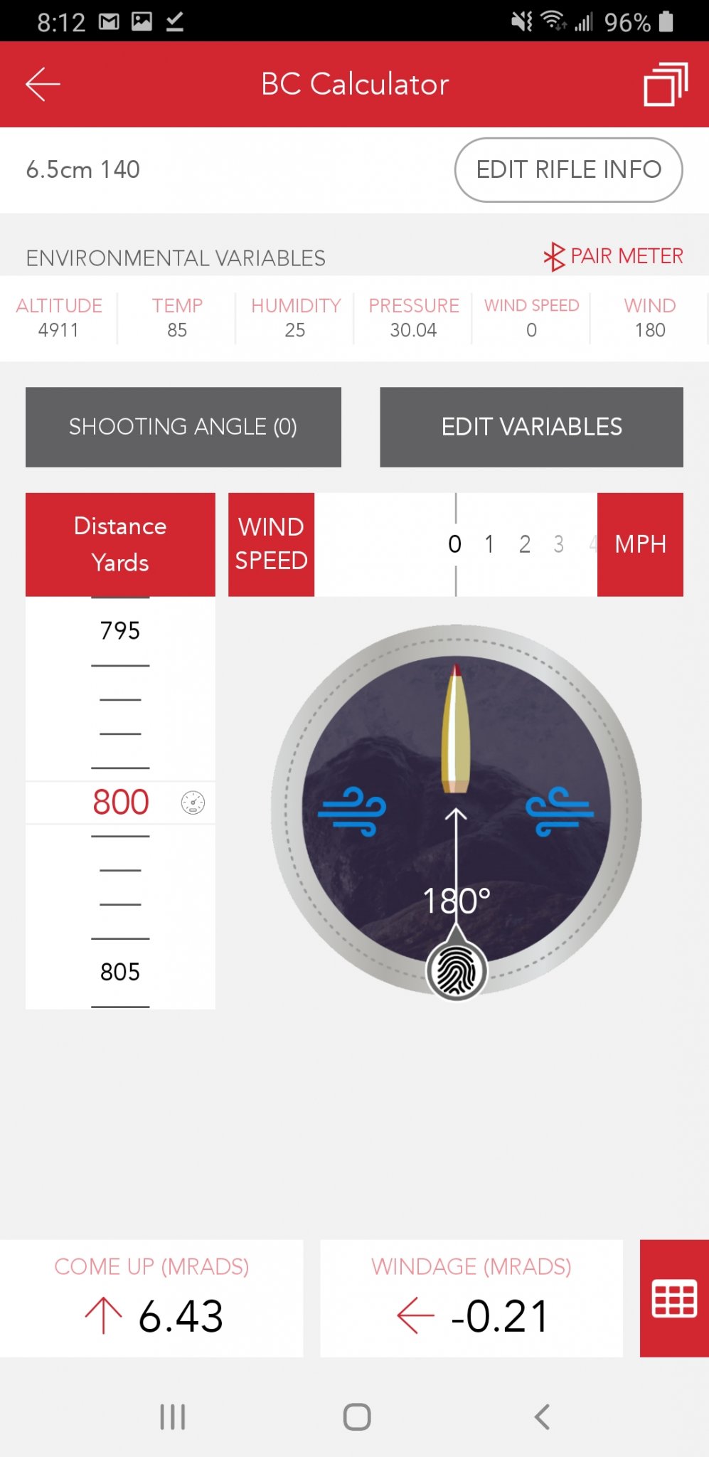

Hornady said 6.4 mill
I don't see a velocity, zero range or BC/reference, so it's hard to say where you went wrong. For a 140g AMax at 2800fps zeroed at 100 under those conditions I'd expect about 5.4mil, I'd need 2950fps to get to 4.8 mil, so your "correct" elevation is a bit suspect already. Has the scope been calibrated?

-- Have you set the scope height over bore at the correct level? Just looking at the image would imagine is should be around 2.2-2.5 inches, but you should measure it properly and use the measured value.

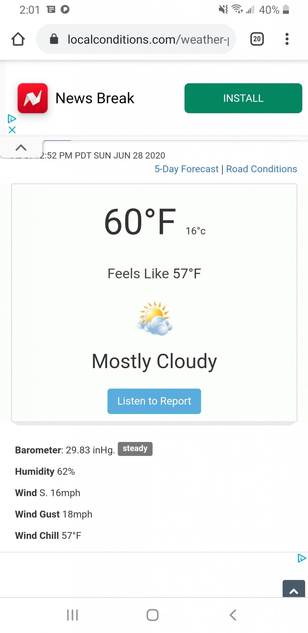

From the screen shot pressure seems quite high for that altitude.

Double checked the pressure and it was correct according to weather website. I don't have a kestrol. Measured my scope height and changed it to 2" from 1.5. Made no big difference in the output. The bc was a g1 and correct. I have not chronoed this particular round but it shoots similar to the 140 eldm and those are right at 2700 out of this barrel. Next time I'm at the range I'll chrono these and confirm my zero. Zero is the only think I can think of as to why it would be this far off. I have only zeroed at 100 but who knows what could have happened. I'll just double check.

At that altitude that pressure is certainly wrong unless it’s corrected for altitude and therefore wrong for using In a solver.

This is from today. I was there last week but the pressure is basically the same. Duh the op is suffering from garbage in garbage out. I'm trying to figure out what part of my data is garbage and causing the error. Like it says in the title, I'm new. I don't own a kestrel.Screenshot_20200628-140106_Chrome.jpg
