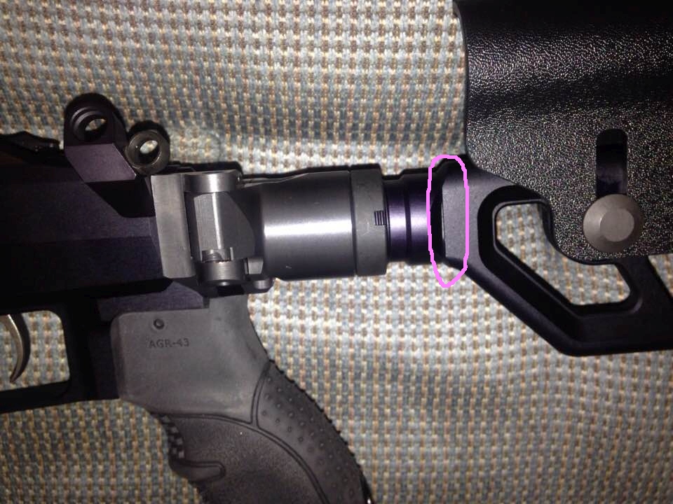

Just got a brand new Tikka TAC A1 and discovered there is wobble in the stock. The manual describes how to take off the stock by breaking the castle nut but I can't figure out how to do that with a Magpul Armorer's Tool without getting the stock off the tube. One possibility is getting another castle nut tool with an open side but if possible I would like to avoid that. In any case I am looking for more detailed intel about how the stock on the TAC A1 works. Here is a pix with a pink line drawn around where the wobble is, just a little behind the castle nut. On my ARs I am able to remove the stock from the tube by pressing a button or lever. Hard for me to understand how some type of option like this is not available on the Tikka.
If it turns out I have to break the castle nut with an open face tool I will do that. But I hope there are other options.

After 2000 plus rounds mine came loosejust enough to bug me. There is a Tikka authorized repair smith near me that repaired it in a few days no charge. Sounds like they put it in a vice broke loose the castle nut and accessed the bolt inside.
No way would I go through the trouble of sending a rifle back for such an easy fix. Go buy a cheap open type AR armors tool loosen the castle nut then the stock will unscrew just like a AR buffer tube then you can access the nut or bolt that needs to be tightened. Good lord men do y’all call someone to change your lightbulbs also this ain’t rocket science!

Not sure how much you know about Tikkas but the manual says to use a torque wrench for several things; but no torque setting for this. While I did not post it earlier the CS guy said if I did anything like you suggest it would void the warranty on the weapon. I also suggested the gunsmith at the local FFL where I got the weapon could look at it and the CS guy said no; even if the store gunsmith did the work the warranty would be voided. This was an out of the box issue. I have posted this on some other Tikka forums and one guy who had taken his stock off said he did not see an "nut or bolt that needs to be tightened". From what I have learned on other forums this is not the only time something like this has happened. Several other Tikka owners have noted that while Tikka sorta markets this as a component fire arm they really don't want owners to do much of anything to it; and if they do the warranty is voided.
I get it that you think it is a simple task. But I also get that Tikka does not seem to think that. They are willing to pay shipping both ways and provide a gunsmith to fix it. Even when I suggested I do it myself or have a qualified gunsmith at the local FFL do it they still wanted me to send it in; so it may not be quite as simple as you suggest.

I own three Tikka CTRs yes its not a Tac A1 I understand, but unless the stock is some how press-fitted into that threaded buffer tube (highly unlikely) it has to have a some sort of screw or bolt attaching it to that tube. I could be wrong (I don't think I am) I wish I knew someone that had because now I am curious has hell.....oh well good luck hope you get it back ASAP.

wow, that's not cool. I wonder if the tube that the butt stock is mounted on be removed via the castlenut and a regular buffer tube (receiver extension) and adjustable or fixed buttstock be put on there?..

When I called they told me the warranty would be voided if I removed the castle nut and tried to fix it myself, or had a gunsmith do it. While the weapon does look modular it seems Tikka/Beretta voids the warranty if you treat it as modular. I have a couple of ARs that make it simple to switch out stocks. On a side note I got a Tikka CTR with a 24" ss barrel in Creedmoor. Shoots like a dream. Kinda windy and shooting off hand with el cheapo SB rounds and a low end Nikon 233 for a first trip to the range.

Good news. Last night I got an email from UPS that my TAC A1 would be delivered/picked up one day early. Went to UPS and picked it up earlier today. Stock is fixed. It is rock solid. Now I can mount optics and start having fun. Given how well my CTR performed with a low end Nikon 233 I have confidence the TAC A1 will do better with better optics. No charge for the repair and shipping was covered under warranty. Did have to wait longer than I wanted but in a couple of days I should have a range report.
