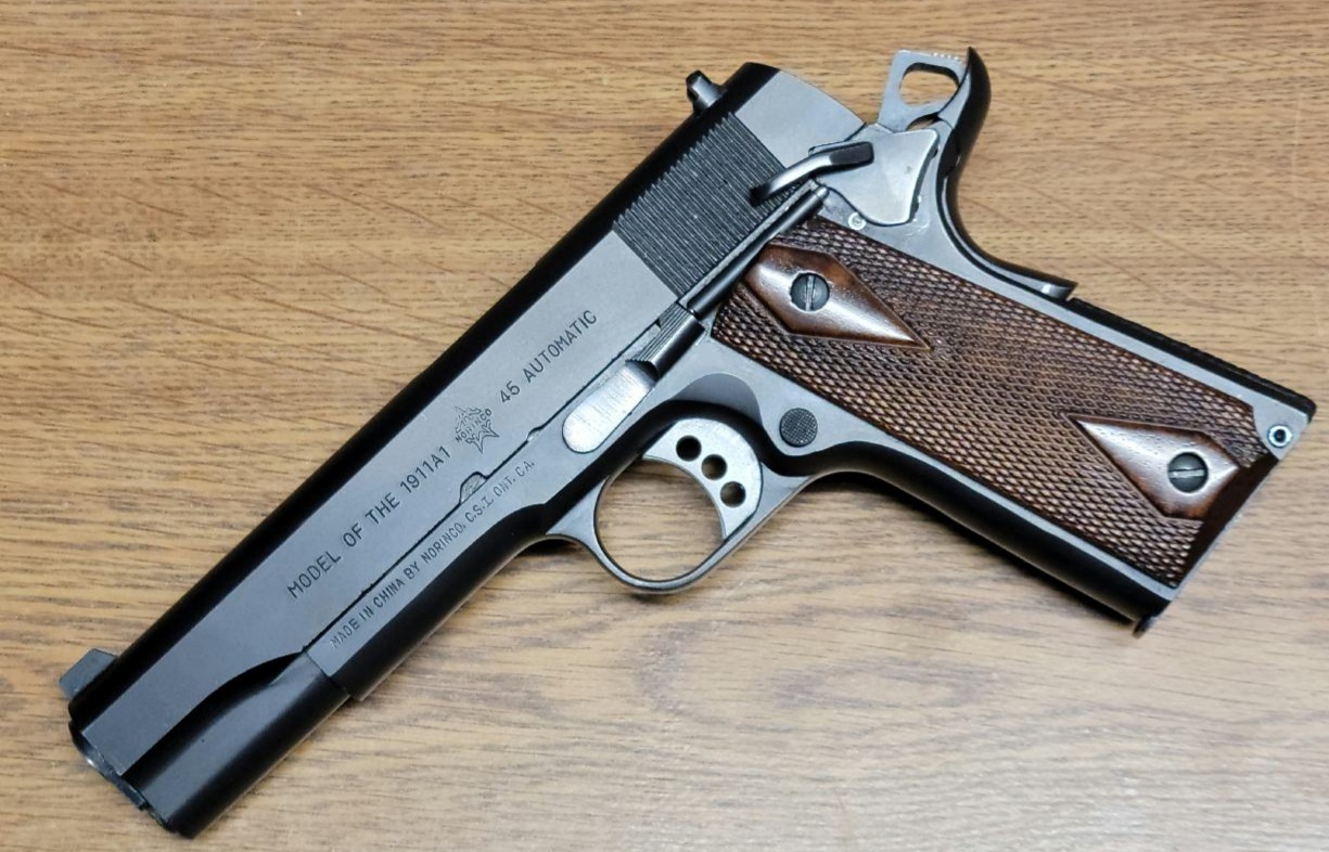

    I was gifted this Norinco .45 . As far as I can tell it hasn’t been shot much, if any ??
    I swapped the handles for some rubbery ones , that’s all I’ve done. I don’t expect it to shoot like my 70 series Gold Cup of course , just wondering about how reliable it might be ?
    What’s the least I could do to make it that way ? Not planning on making it a platform for many improvements , but don’t want to pack anything that will stove pipe every other round 👎 I know it’s from China , but I couldn’t beat the price. $0.00 👍
    Any ideas appreciated 🍻
