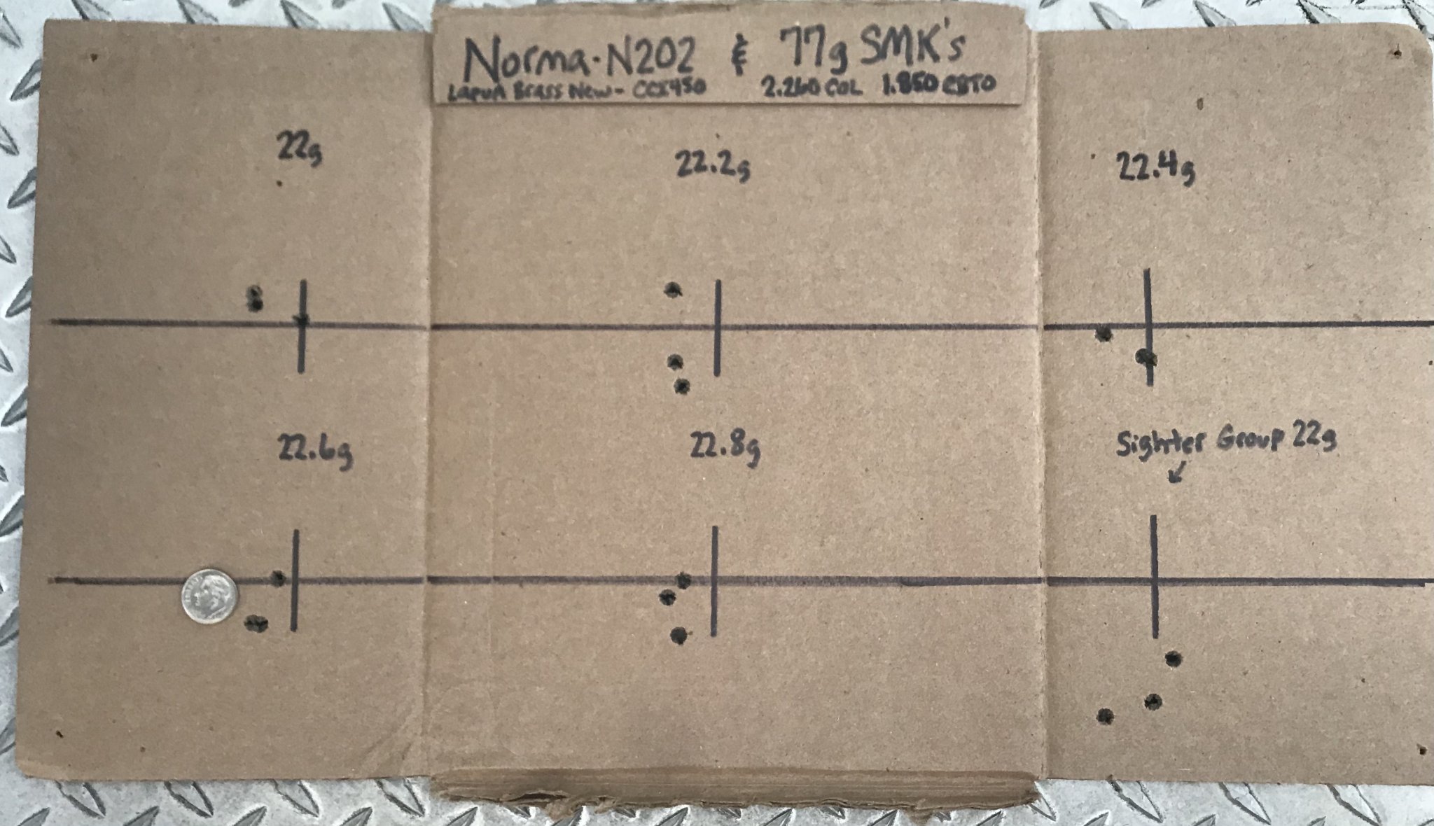

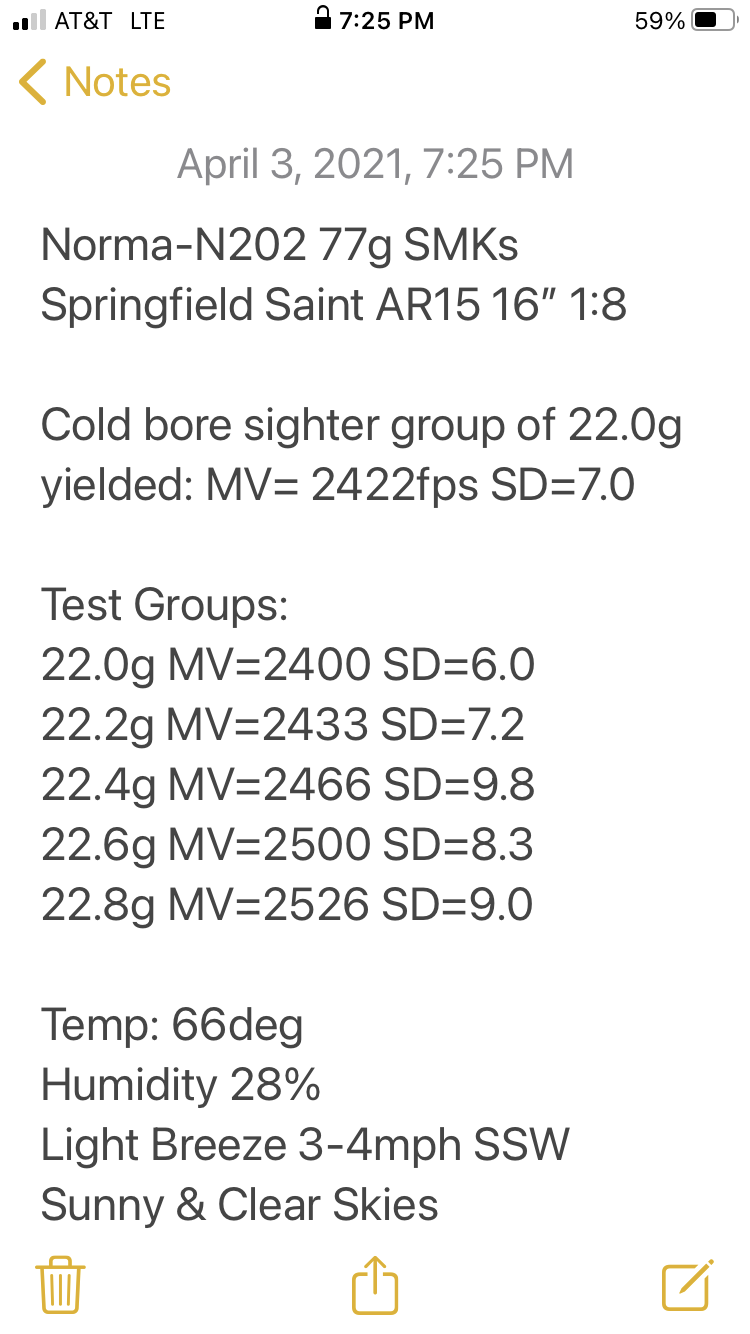

I was also intrigued by this powder. I wanted to try it for 77gSMKs,and saw it was available at Powder Valley recently, but couldn’t find much info on it. Well... I rolled the dice, & tested it today. I feel like it has great potential, & I was pleased. My velocities were not impressive, but I’m also running a 16” 1:8 twist. It shot a couple dime sized groups at 100yds, and the SDs were all just below 10. Will attach pics. I feel I may can bump up my load another couple tenths, but I did get the slightest ejector wipe on one of the three pieces of brass at my highest charge weight of 22.8g. Disclaimer: As always please don’t copy anyone’s load, but start low & work up, as your method & results may vary.
I was also intrigued by this powder. I wanted to try it for 77gSMKs,and saw it was available at Powder Valley recently, but couldn’t find much info on it. Well... I rolled the dice, & tested it today. I feel like it has great potential, & I was pleased. My velocities were not impressive, but I’m also running a 16” 1:8 twist. It shot a couple dime sized groups at 100yds, and the SDs were all just below 10. Will attach pics. I feel I may can bump up my load another couple tenths, but I did get the slightest ejector wipe on one of the three pieces of brass at my highest charge weight of 22.8g. Disclaimer: As always please don’t copy anyone’s load, but start low & work up, as your method & results may vary.View attachment 7597046View attachment 7597047

Haven’t played with it since. It was a little slower than I wanted, but hey, it shot pretty good, & with supplies difficult to find, it’ll go bang & will definitely work.
I need to get off my rear end, & try it with 69gSMks. Will update when I get around to it.
