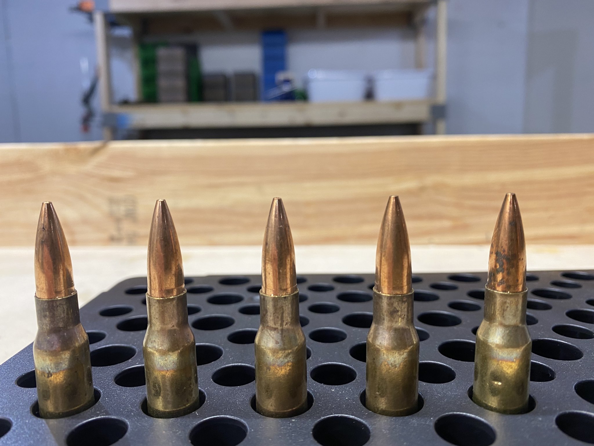

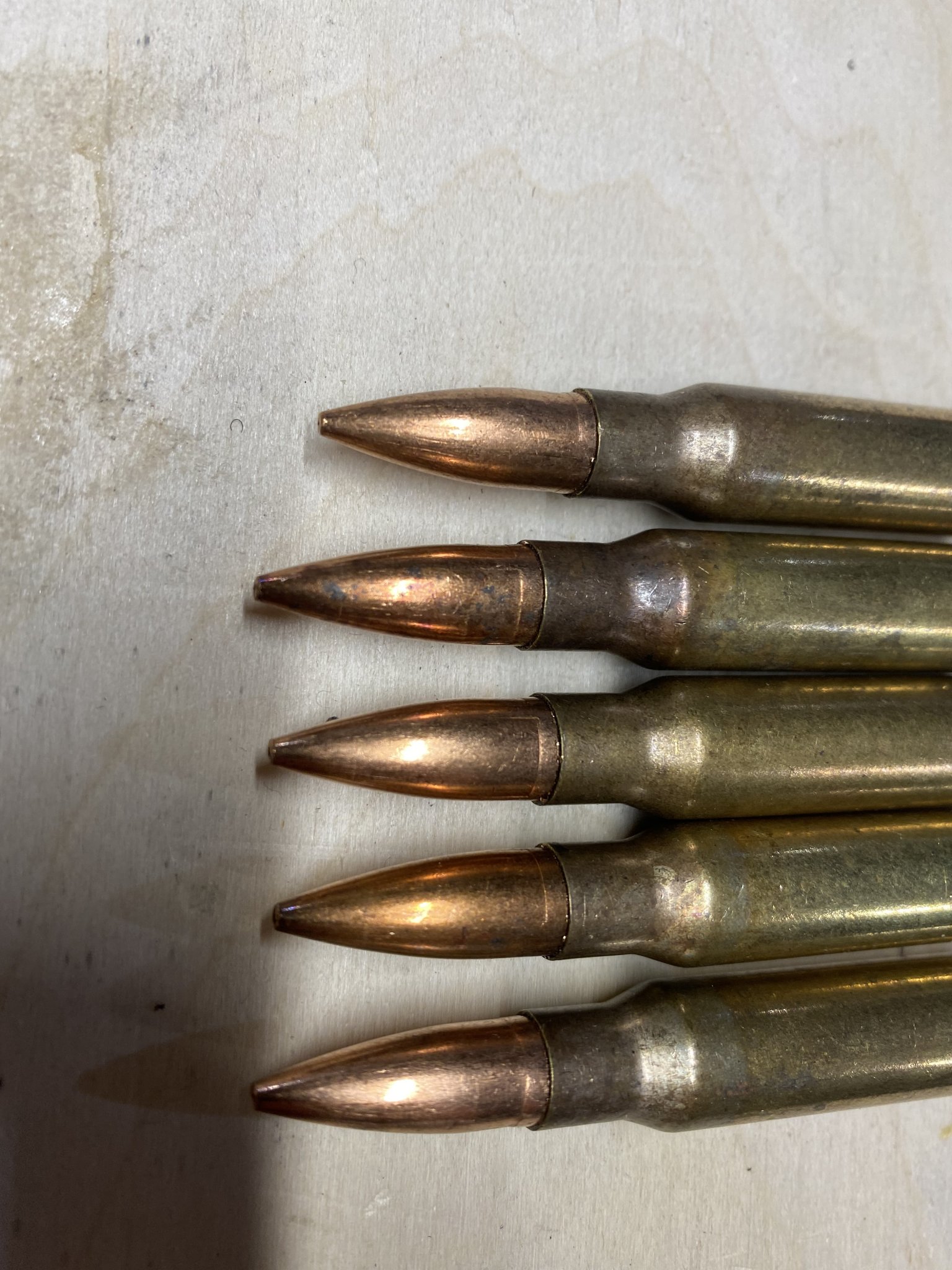

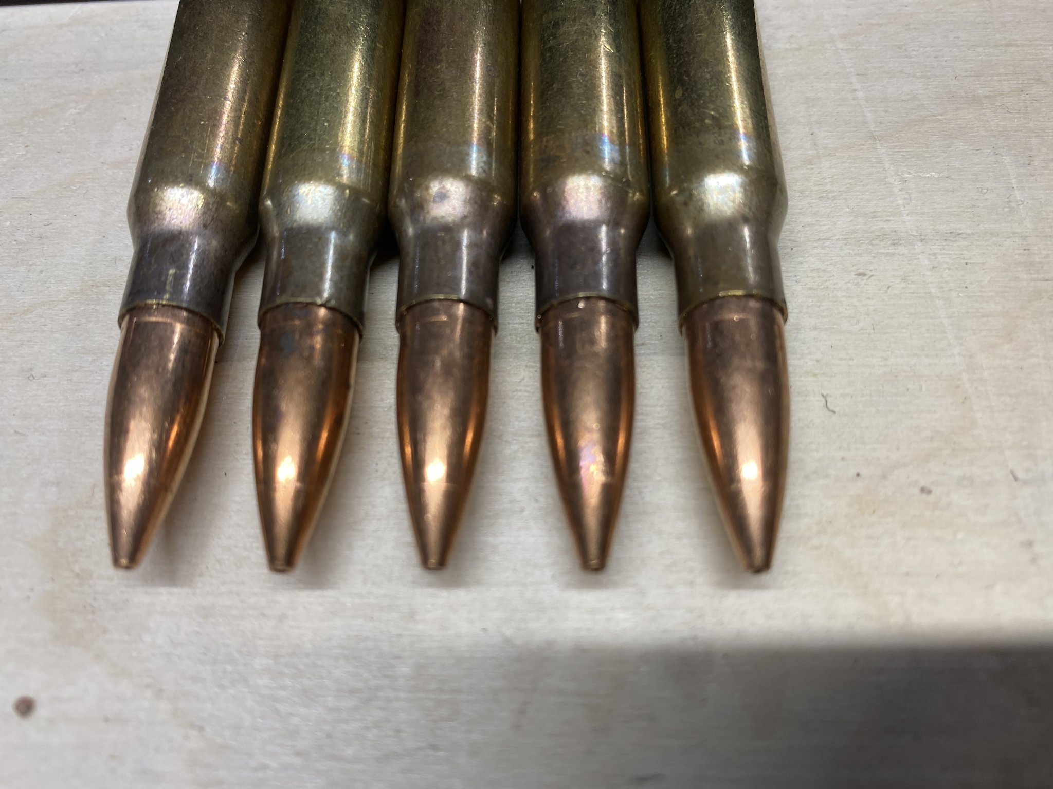

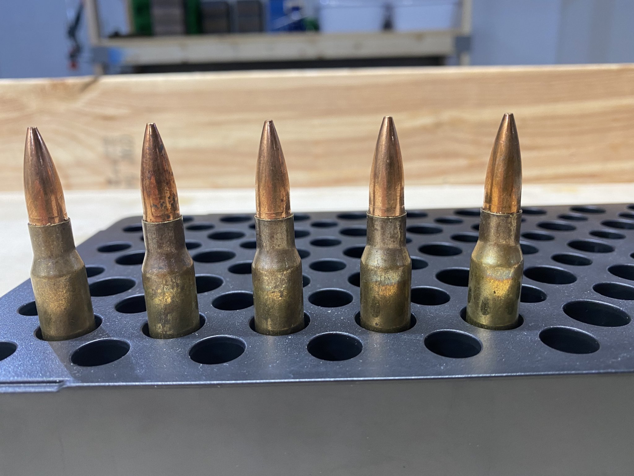

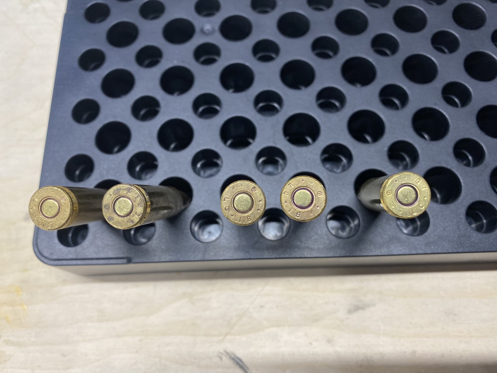

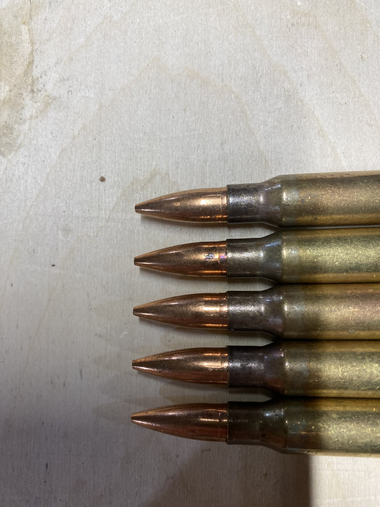

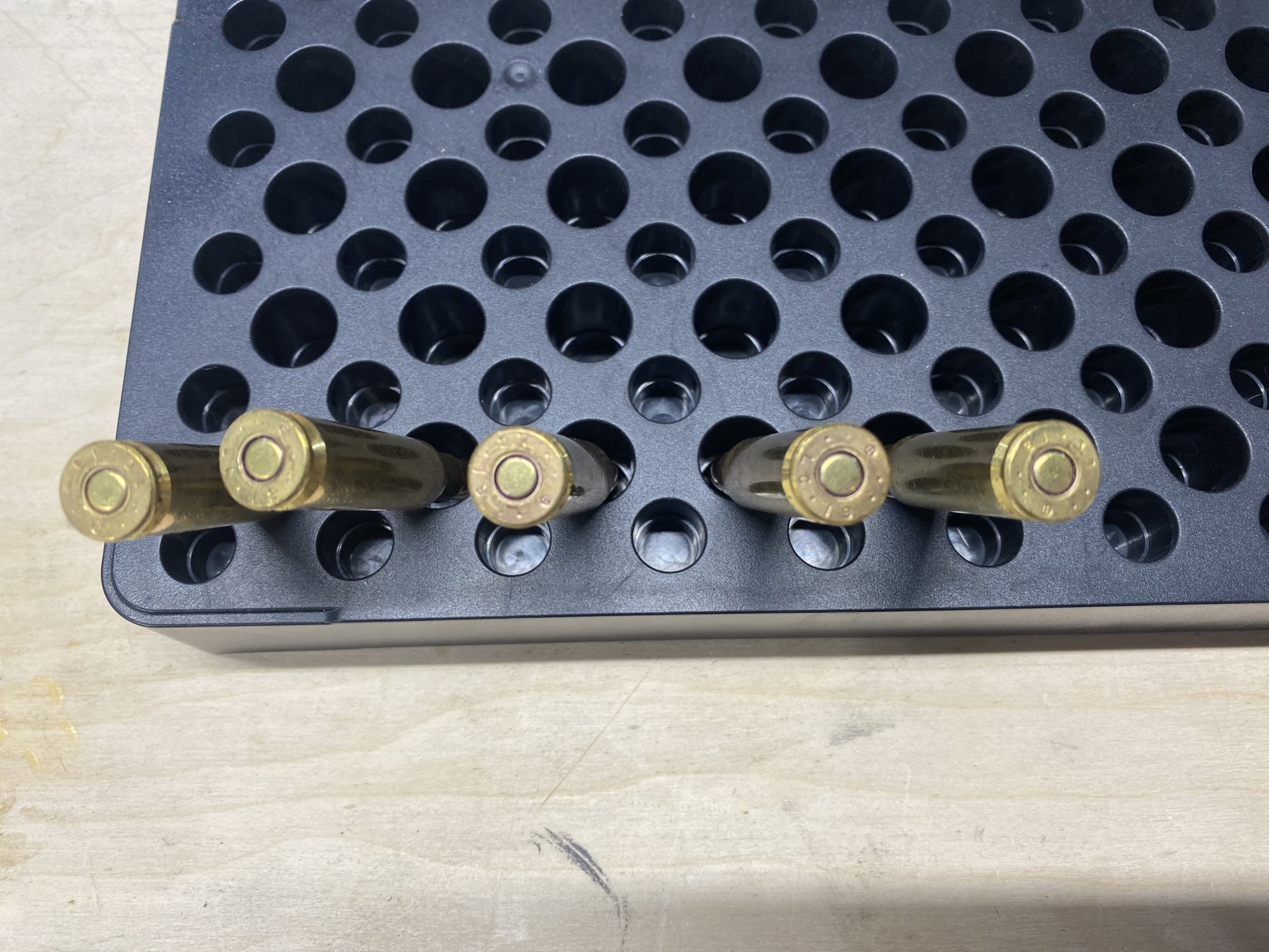

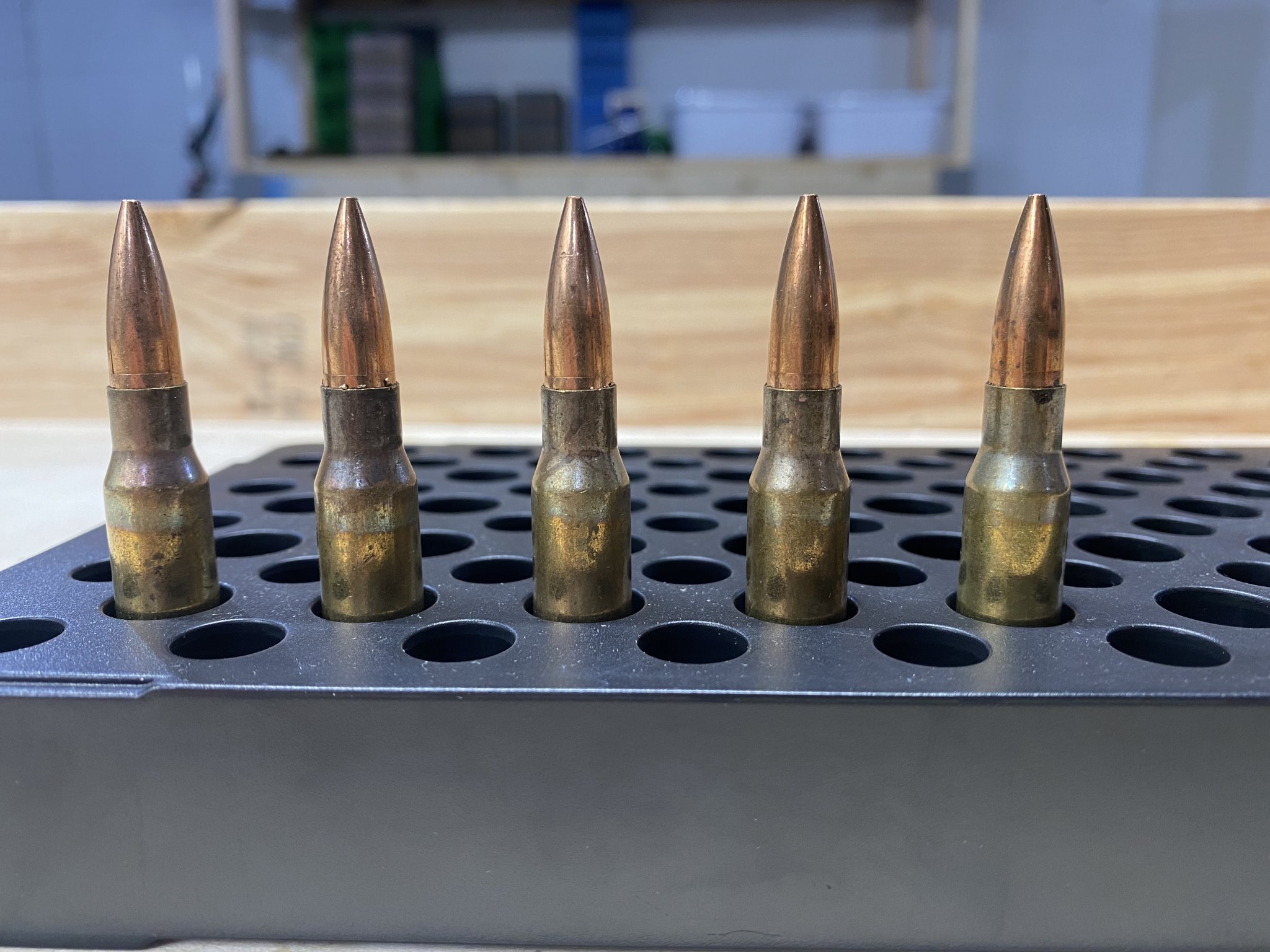

    LC 18 & 19 rounds advertised as LC LR or M118LR:
    YMMV
    This brass is most likely brass that failed quality control for some reason to be used for the military. Or it may just be an overrun of the lots. If the 308 is not marked LC LR than its a high probability of being machine gun ammo. But since this is never fired brass…….
    The other brass is 5.56 as the US military does not use 300ACC. This is bought and manufactured to 300AAC by another company. I wont purchase brass from or rounds from that company due to poor poor manufacturing/quality control.
    I do not recommend buying from American Marksman. These were made by bullet 1st I believe which American Marksman distributes. No quality control at all:
    View attachment 7729539View attachment 7729540View attachment 7729541View attachment 7729542View attachment 7729543View attachment 7729544View attachment 7729545View attachment 7729546
    YMMV
