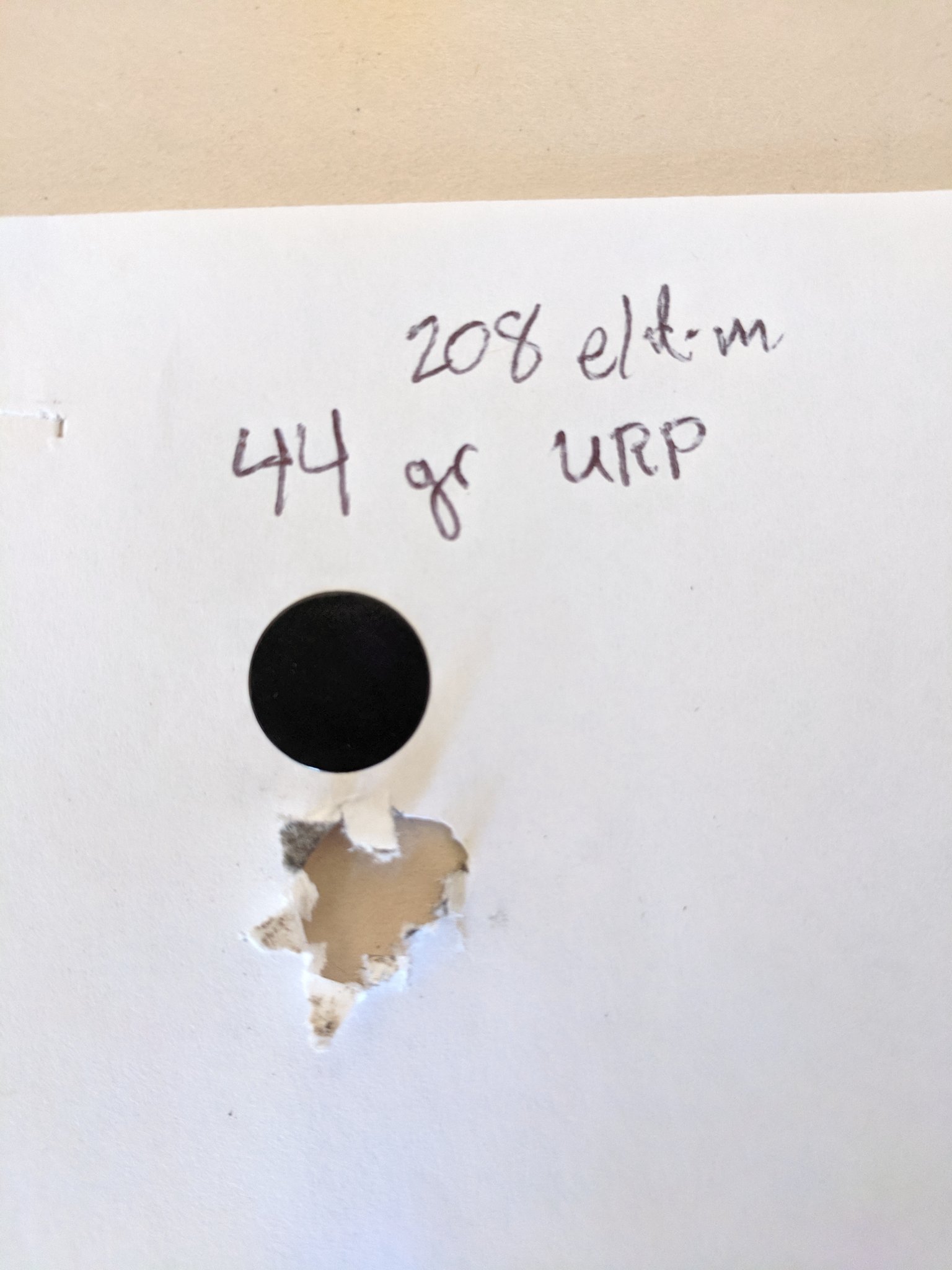

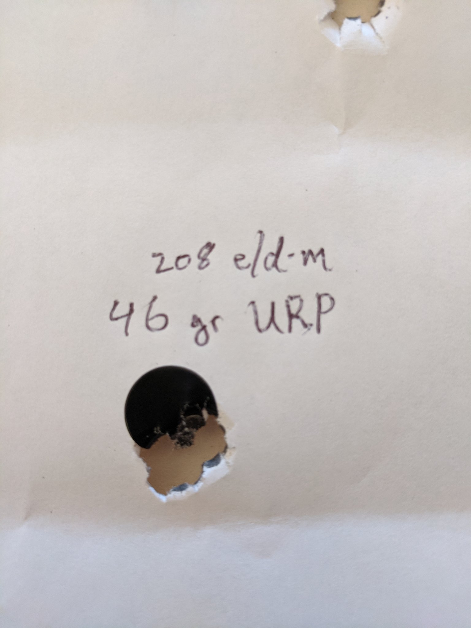

Back from the dead... anyone know if URP = RL16? And generally, RL16 takes approx 1 grain more than RL17 for similar velocity?
RL17 load for this 308 is 45 grains w/ 208 eld-m COAL 3.043. I saw slight pressure beginning at 46.5. Planning on starting RL16 test @ 44 grains. Also have 8lbs URP and wondering if it will be identical to the RL16 load, once found.
Tested the URP, found 2 nice nodes for my rifle, a 24" 700 5R. My COAL is 3.043. 5-shot groups @ 100 yds.
