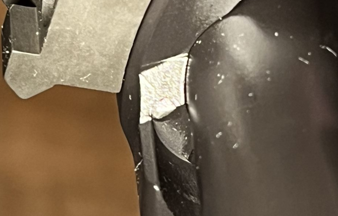

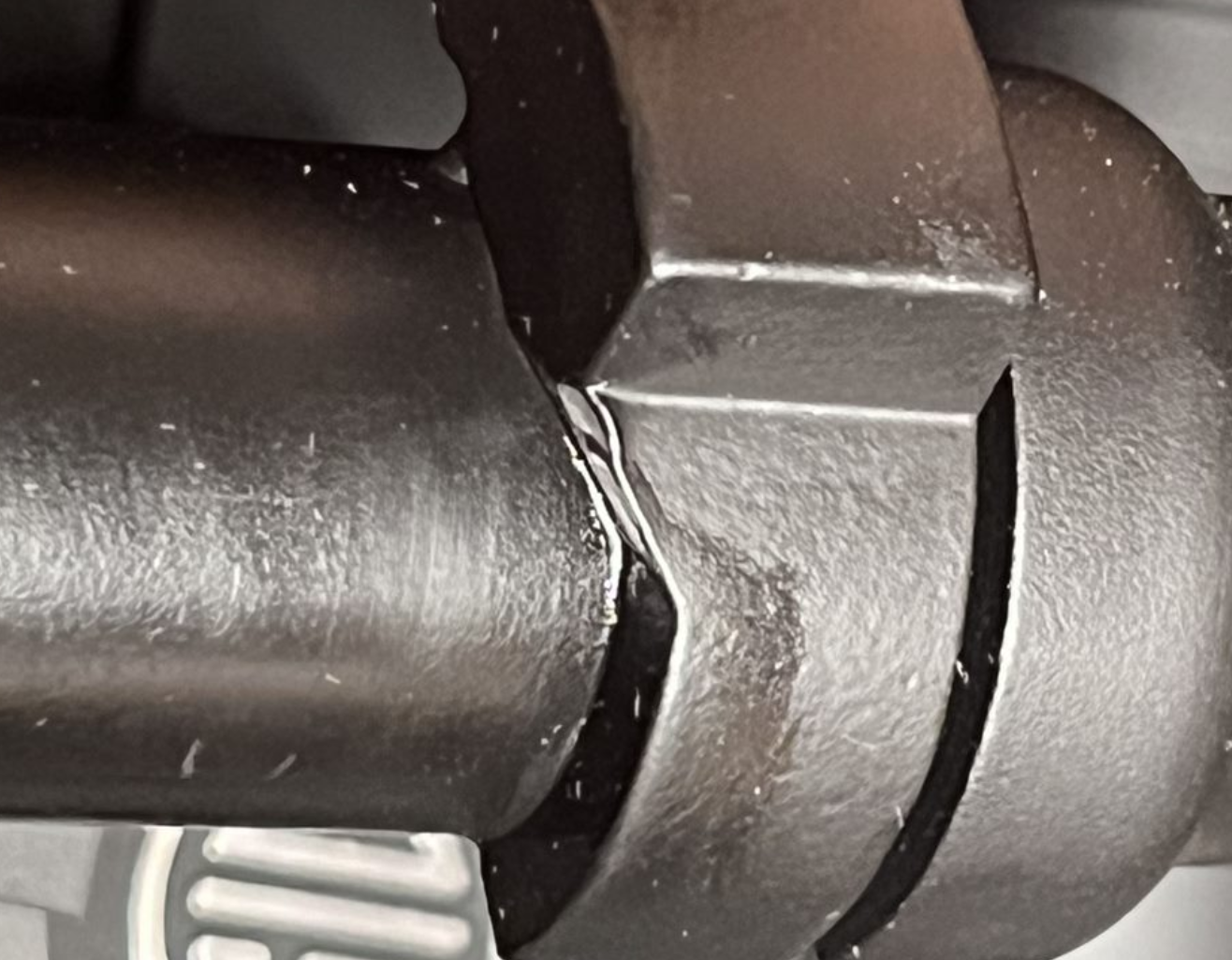

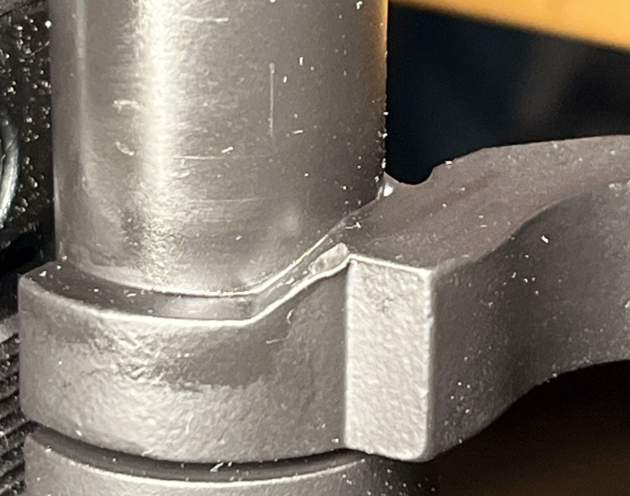

Admittedly I started my bolt action journey with custom actions, but I've recently acquired an accurized (blueprinted, bolt handle timed by LRI) Rem 700 barreled action. One thing I noticed is the "dent" on the bolt's cam surface, there are corresponding wear but less pronounced on the action side.
Is this a normal wear pattern on the Remington 700 actions?
That's not wear, that's getting smashed by something.
Whether that means the bolt got dropped outside of the rifle and hit a rock, or the previous owner was beating it to get a case out. Nothing I would worry about or even ever look at again.
Reactions: thehjot
Looks pretty normal. You should be putting a little grease on that spot when you regrease the bolt.
Thanks all, also heard back from Chat@LRI, pasting here for reference.
"The cam surface of the receiver is different than the one on the bolt handle. The portion where the handle peens on the cam surface is where it’s making contact."
