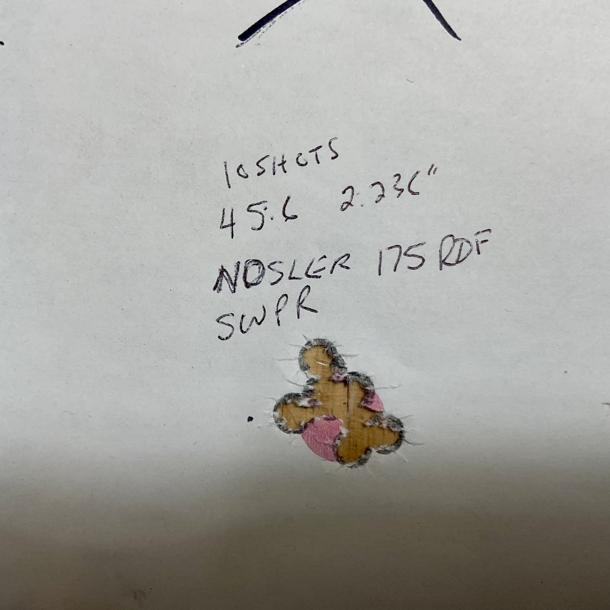

    Loaded some long and got to the range this AM. FGMM brass x2, 210M, 43.5 Varget, 2.910oal +/- .010. Was going to load 43.2 but the oal looked like the 43.5 was a good option.
    Sorted tip lengths and took the closest six of twelve to shoot a group, six to chrono w/ magneto.
    This is my stopping point and will be filling all the fired FGMM with this load.
    2665, 8/19 from the magneto.
    Six at 95yds. fired the sixth because I knew I pulled one.bipod and sock, prone. Lowest hole was called :

    I know it’s an old thread. Came across it when I was searching to restock my supply. Shoot great. Good BC.
    Sav 10 FCP-SR 20” Barrel 1:10 MDT Chassis
    Dead Air Nomad L direct thread
    45.2-45.6 Shooter World Precision Rifle (depending on season temp sensitive powder)
    2.236” CBTO (Horn tool)
    2650 fps
    10 shots 100 yard Bipod and bag
